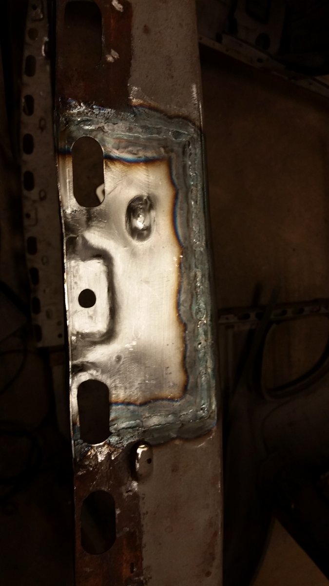

    Calcraft

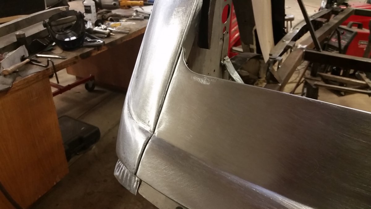

    Subrail rusty piece cut out, fabricated piece welded in and metal finished

    small rusty spot on the lower cowl fabbed up, welded in and metal finished

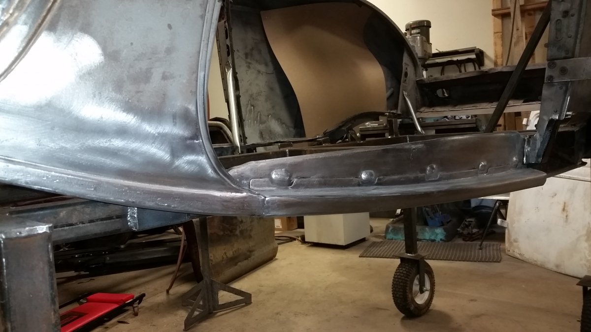

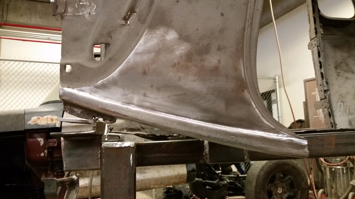

    Calcraft

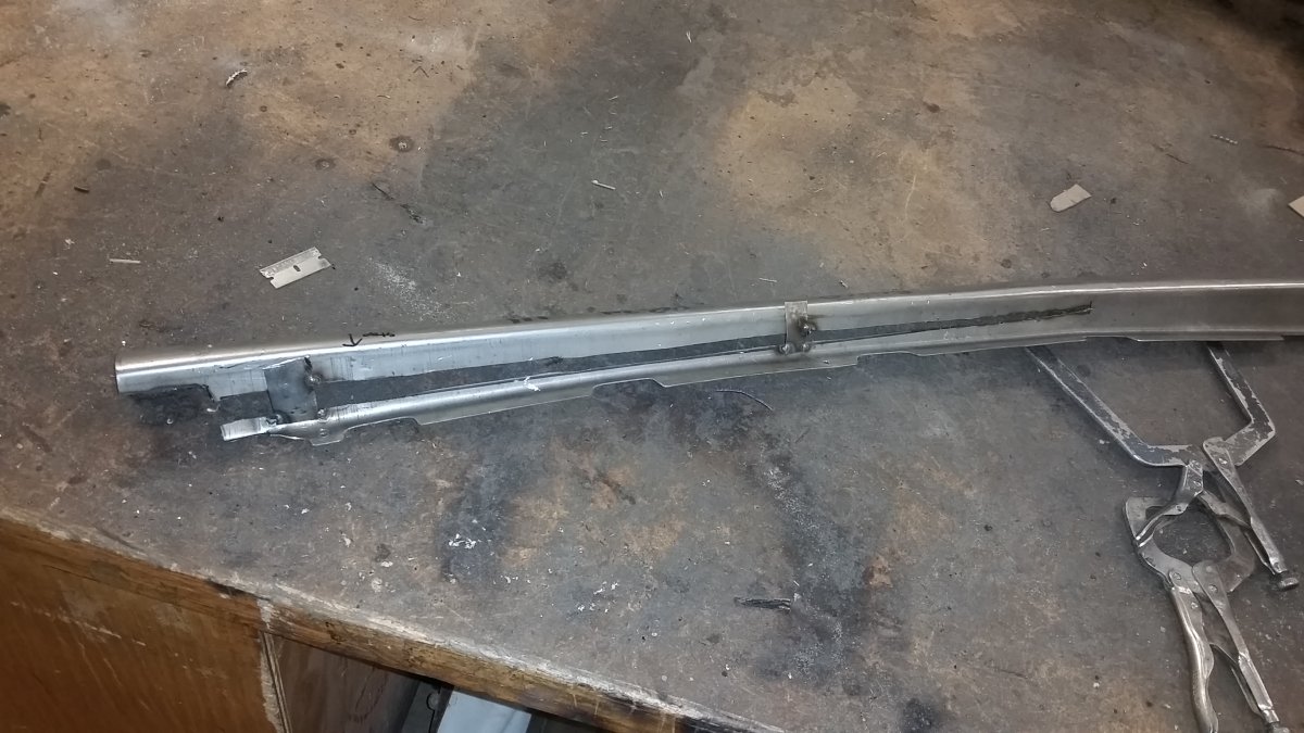

    Subrail finished, replacement rocker was a little short and needed a wedge section added to line up with the door and quarter panel

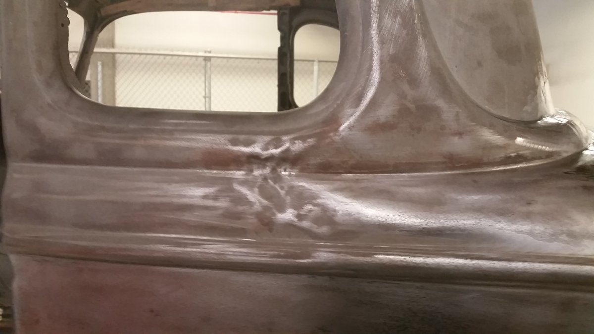

    It appeared a chain had been wrapped around the body in a couple spots kinda crushing the top. Took a porta power and some scary pushing but got the shape back then metal finished what looked like claw hammer marks

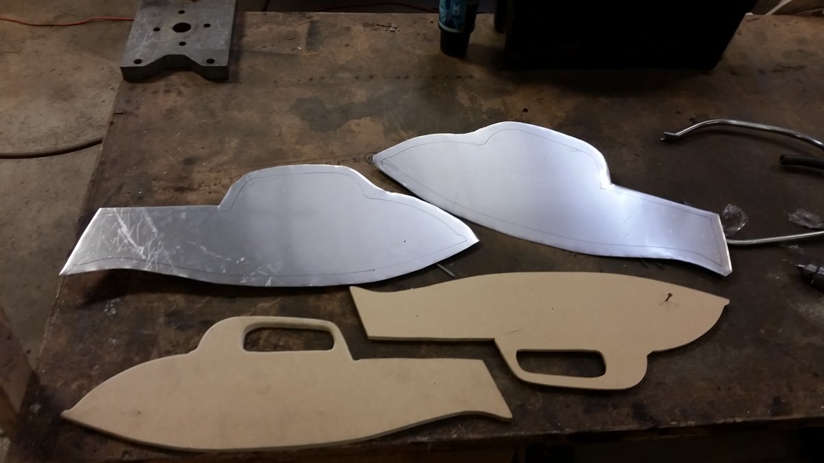

    Speaking of the cop shop coupe.
    My project for the aluminum shaping part of the course.
    Projected a profile of the Cop Shop coupe on the wall the size I wanted.
    Original plan was for a mailbox but was afraid to leave it on the street so it became a pair of wall hangers, one of which I give to my buddy for Christmas.
    I first cut the aluminum blanks and annealed them, then cut the pattern from mdf.

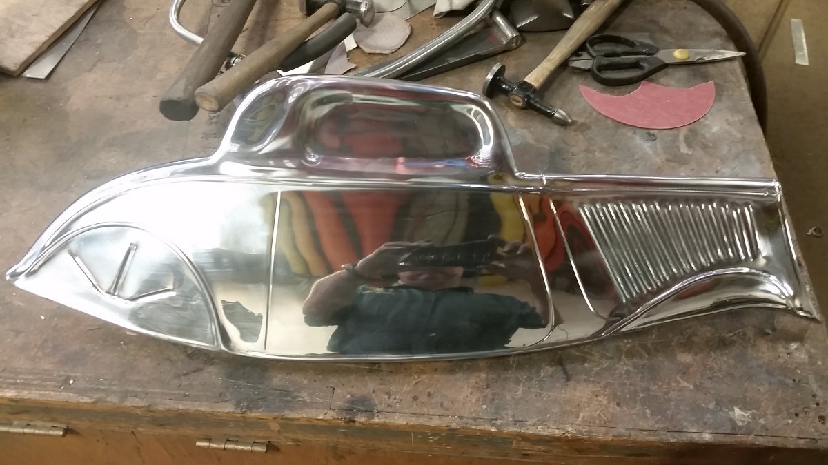

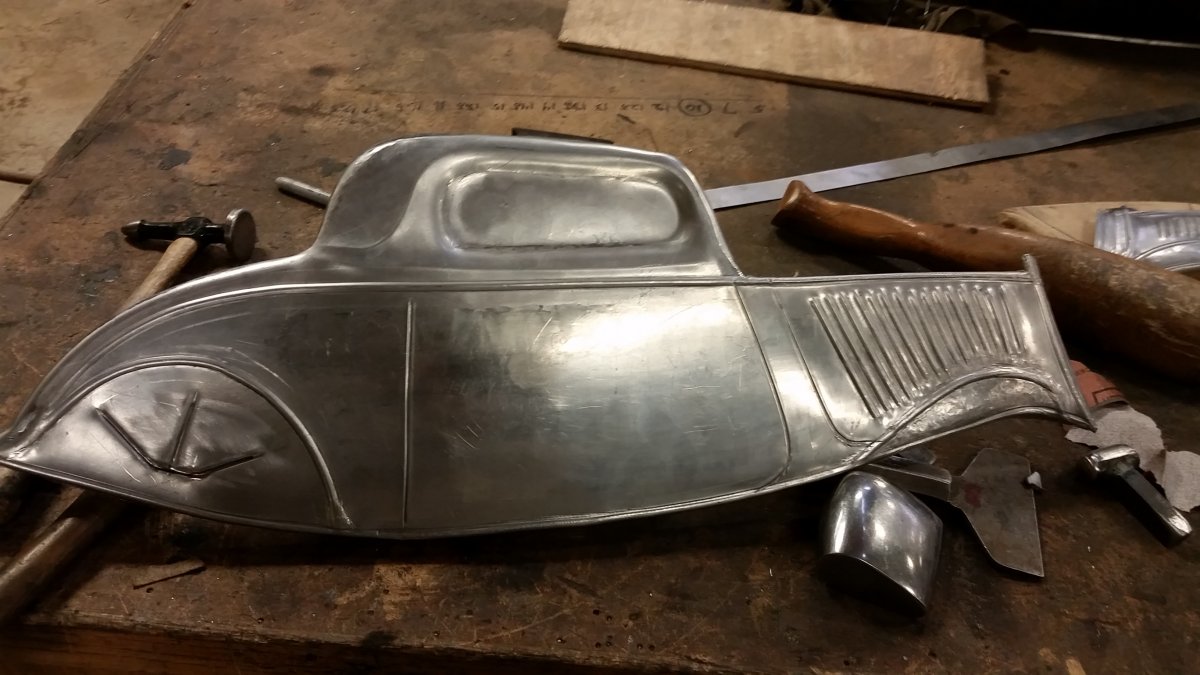

    Calcraft
    I then used 1/8" bead roller to put in the belt line & hood louvers. The pullmax was used to put the bead along the bottom edge, while keeping the tipped flange. Then a flat die on the bottom & tipping die on top of the bead roller I "creased" in the door & hood seams. The tipping die on top with a skateboard wheel on bottom was used to put the reveal in the roof sides.
    It was made without a hood to allow access for the mail, so I had to add a hood.
    kidcampbell71 and thommoina33 like this.
  21. Calcraft
    Joined: Oct 1, 2008
    Posts: 46
    Calcraft
    The side window was made with a simple hammerform. Then a little metal finishing, a little polishing and done.
    Now I need to find the correct wheels for it. Haha

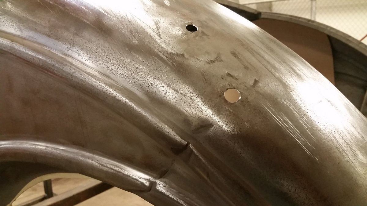

    Couple bullet holes opened up & repaired, as well as another chain damaged area

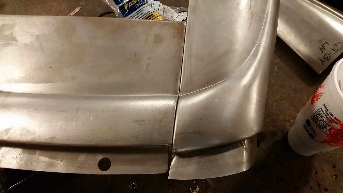

    Get the lower panel installed & fab the pieces to round the corners
