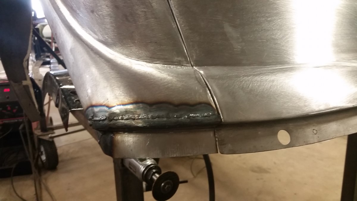

    So it was at this point I realize I had fitted the pieces together on the bench but.......on the car they were actually approximately 3/4" different side to side. So, start over......again. Haha

    The wheel well needed a little tune up on a couple of the stamped spots. Shaped fitted then welded in
  7. Calcraft
    Joined: Oct 1, 2008
    Posts: 46
    Calcraft
    36 Rokit. Yes. I am using hammer & dolly. I am really liking *******s or "flippers" I made one from a leaf spring in the shop, Ill try to get a pic. Shrinking disc next, then pick & file, then block sand with 80 grit. Definitely a learning process. I think "I'm getting the hang of this....... then the next area seems to humble me. Lol
    Hopefully in the end my skill set is improved, but man is it fun!
