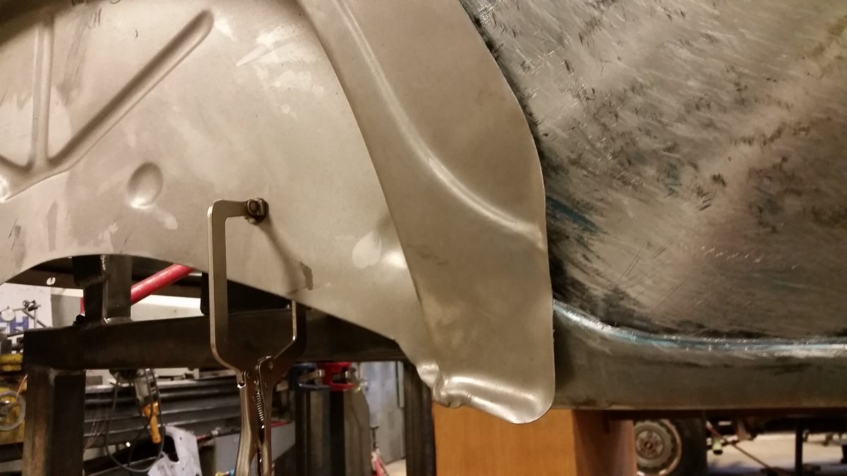

    Welded the rh quarter patch in & got some of the metal finishing done
  4. Calcraft
    Joined: Oct 1, 2008
    Posts: 46
    Calcraft
    I guess the wheel well patch was close.......kinda
  5. Calcraft
    Joined: Oct 1, 2008
    Posts: 46
    Calcraft
    But was able to get it close & welded in & mostly finished 20160303_144152.jpg 20160303_144140.jpg

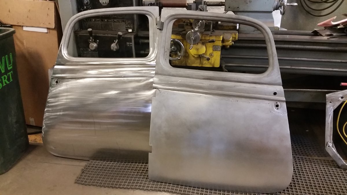

    Next was the p***enger door skin. I wanted to see if I could finish without a grinder or pick & file. I spent more time getting a good fit which helped a lot, very little filler rod, .035 might wire for filler. Only hammer & dollie & shrinking disc & 80 # on a block to show low spots were used. It took forever! But I feel like I learned more about how metal moves doing it this way than anything I had done previously 20160329_135946.jpg 20160329_135946.jpg 20160401_101902.jpg 20160401_102052.jpg
  7. Calcraft
    Joined: Oct 1, 2008
    Posts: 46
    Calcraft
    Pretty happy with the result.
