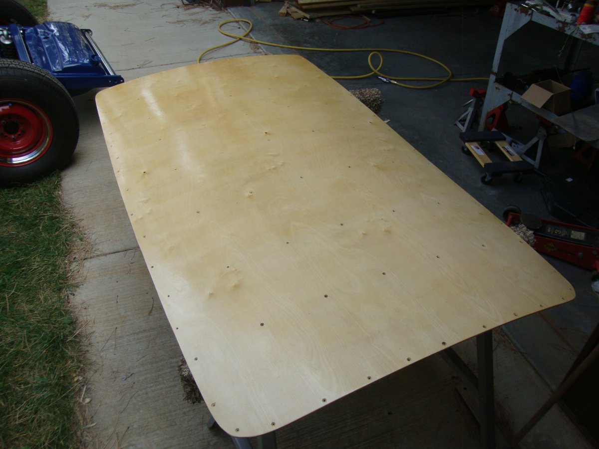

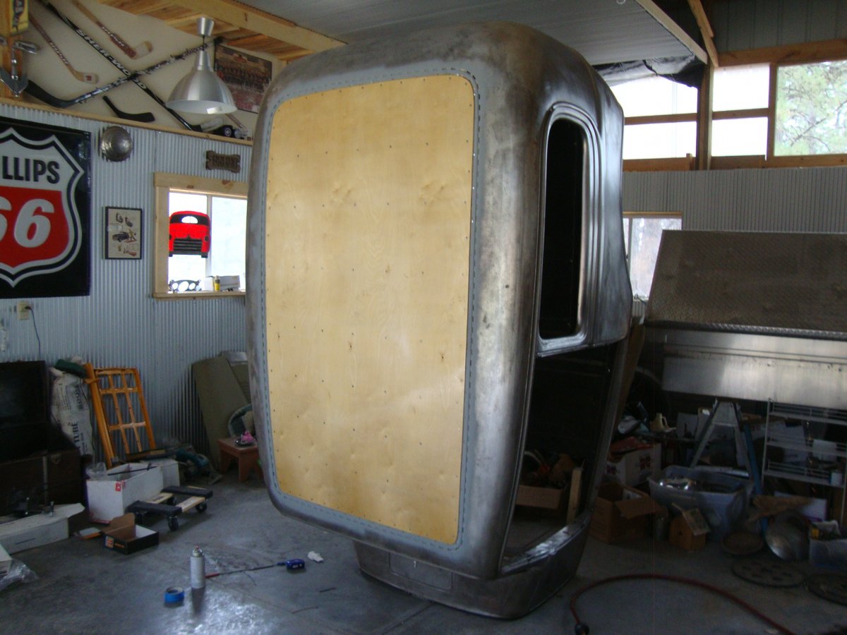

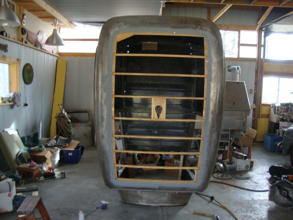

    You can do this. 1/4 baltic birch screwed to wood bows sealed at the edge(metal to wood) with automotive gl*** eurathane. DSC02814.JPG DSC02817.JPG DSC02818.JPG
