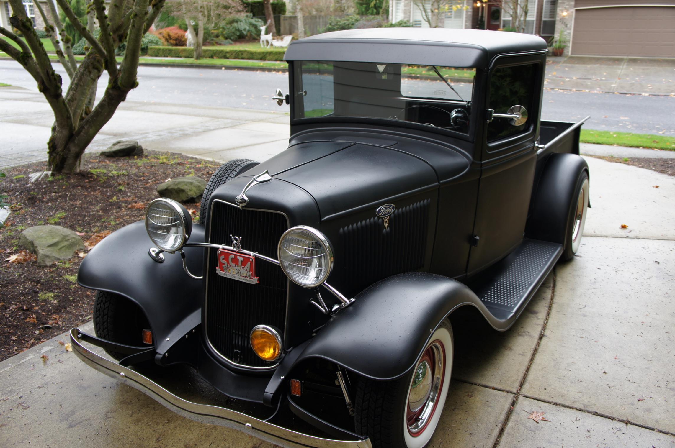

    My 34 pickup is set up with a 4" Super Bell axle, monoleaf spring, panhard bar, Efco shocks, hairpins and a Vega box. It is all right out of the Speedway catalog. Also using disk brakes. It behaves very well especially on our ****py WA roads.
      383.7 KB
      77
