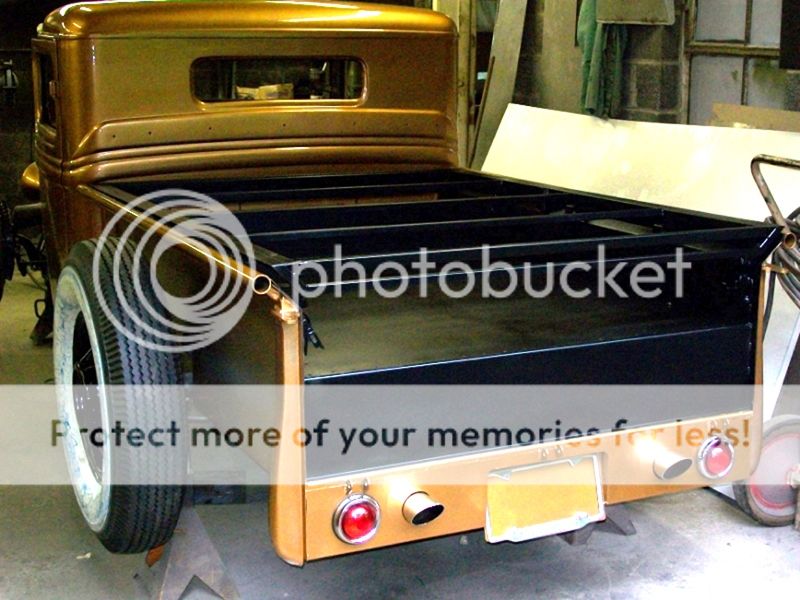

  28. Koz
    Joined: May 5, 2008
    Posts: 2,787
    Koz
    Shot the bed with TexCoat this morning. Just getting everything together and final bolted up.
    With the gate on. I'm threading a .375 stainless bar that will be polished and acorn nutted for the hinge.
    A bit more of the front end together.
    The exhaust getting ready for ceramic coat.
    I'll post more of todays progress this evening.
