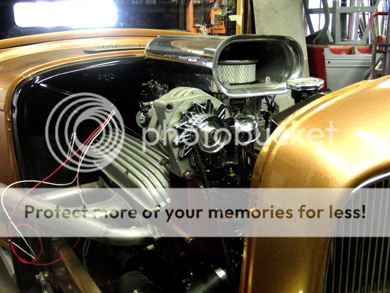

    I've been so busy getting stuff out of here I haven't had time to shoot any pics. Mostly I'm just being a whining cry baby because my roadster isn't ready for Wildwood but I'll get over it.
    The truck is down to the last details and as usual it's fighting me all the way. It's always an effort to tie up all the little stuff and it absolutely ****s time sourcing tons of little **** that you need at the end. I'm building my third set of alternator brackets tonight because the ones we were going to use won't clear the relatively tall vintage Cal Custom valve covers with adapter rings under to fit the Vortec heads. Didn't help we're using a huge 200 Amp alternator to drive all the power ****ers in this one. The distributor for some reason is about .250 short of engaging the oil pump properly. It also hits the rear of the back carb so I need to run it 180 deg. out. No big deal. I have the 2x4 sorted out with them running straight up. The fuel sender doesn't match the gauges they sent and on and on.
    It's gonna' be a late night!

    If Kess doesn't mind I'll jump in here since I can measure the truck.
    Overall height 52 1/4" at the back of the cab roof, highest point.
    Minimum ground clearance is 5 1/8" with the exception of the dropped Super Bell axle which is just a hair lower. That way you won't get small animals stuck on the bellhousing! Every inch of space is used under the truck to accept something to get that much ground clearance in a very low vehicle. The pipes on the sides under the doors are actually the lowest part of the truck at 4 1/2" but PA doesn't count them for scrub line so I think we're OK. With any luck and a few parts, on the road in two weeks or so.

    There are some pics in the beginning of this thread that show the ch***is. The entire reason the truck sets like it does is because of the frame. Everything else is pretty straight forward.
    Up front, Super Bell 4" dropped axle with Model "A" reversed eye spring and SoCal hairpins with scratch built rod end brackets into the frame.
    In the rear, reworked Speedway '32 four bar setup with AFCO coil overs and the rest is just scratch built. The body is technically not channeled. The frame is constructed to lay right under the door sills and this allows for recessed footwells, much like a new car, between the rails and the monster GM 5 speed. The foot boxes are fabbed even with the bottom of the frame rails which helps with road clearance and gives much needed leg room in a '34, which are notoriously tight. To gain additional leg room there is a fabricated seat frame that folds to allow access behind the seat. To ***ist with "line of sight" the base of the windshield is dropped which also helps with appearance on the cab. If I had to do it over I would have also added 2" to the cowl like I did on Henrys Sport Coupe. Live and learn!
    Since the floor uses every inch of space The pedals are of the Ansen style fabbed to lock into the stock Ford cowl and activate a bell crank ***embly that places both the required hydraulic clutch cylinder for the trans and the brake master cylinder inside the frame rails and beside the engine on the left side. This has the advantage of easy service for the brake system. Everything else from the E brake system to the drivetrain is hand fabbed and unique to this truck. Virtually nothing is off the shelf.
    Post up if you need pics of anything.
