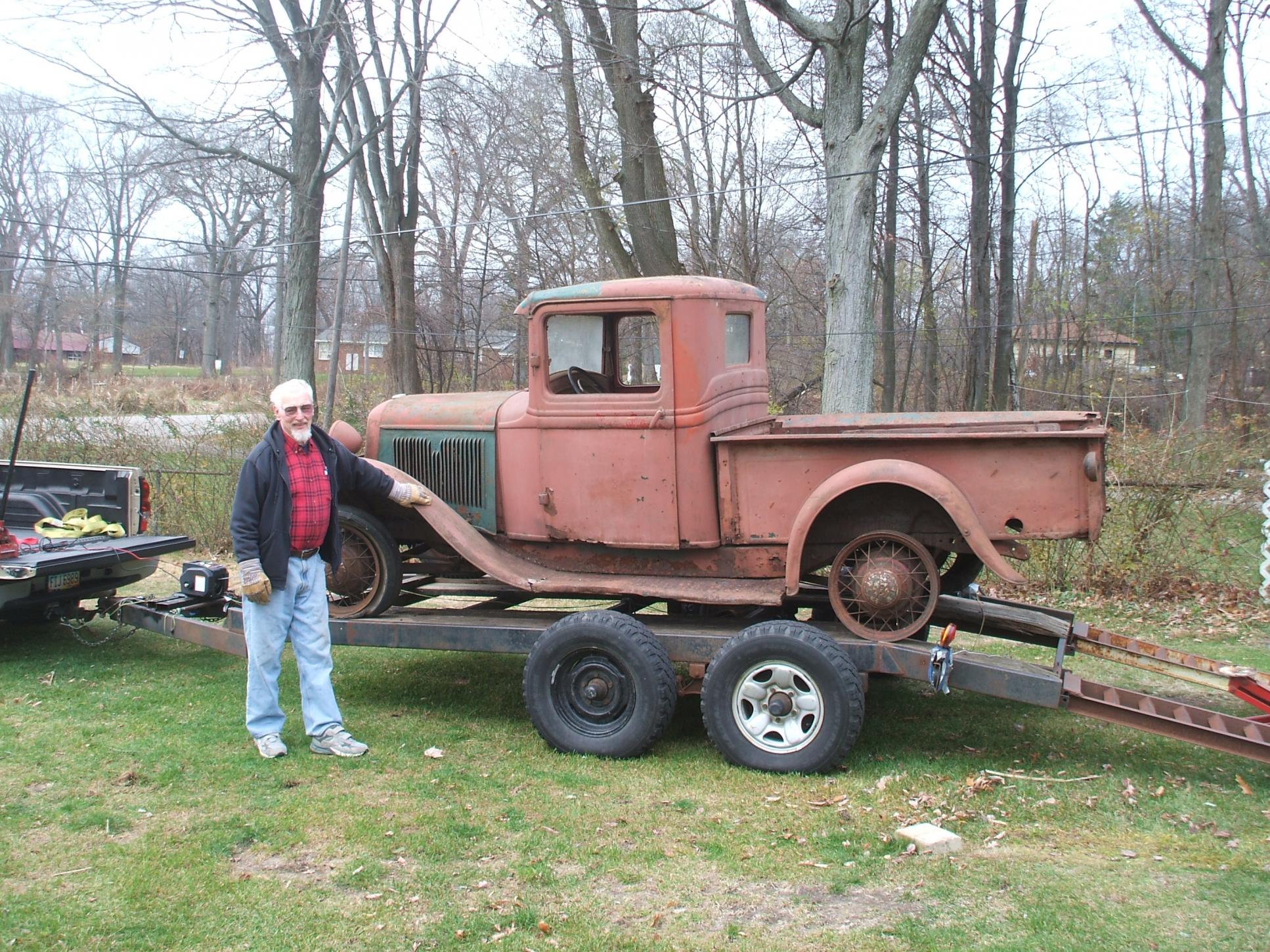

    Well, Ive always wanted a 32-4 Ford pickup-to drive daily. So about 3 months ago I found one on C-list in Michigan. It had a 38 Ford flathead in it and juice brakes. After striking up a deal and agreeing to pick the truck up on Saturday morning; Friday after work I went to bed so I could be up by 2 AM to leave and get the truck (6 hours away) I got there by 8 in the morning. When I got there I was greeted by an 80 some year old man named Dick , retired iron worker. He's owned this truck since 1967. In a pic below he’s getting one last shot of him with his project never finished because life happened. I hauled it off about 2 hours later because he offered me a cup of coffee and a bunch of cool stories. The truck wasn’t in too bad of shape…but the frame was shot behind the cab, I thought it might break on the 6 hour trip so I tied it to the trailer a little differently than I normally would. About an hour into the trip I looked in the rearview mirror and saw the bed was at a weird angle and thought “that damn frame broke!” So I pulled over…the frame was fine but what I didn’t know was that the bed wasn’t bolted down! It almost flew off! Didn’t have any more tie down straps so I took one off the truck to hold the bed on. – off again. Well the trip went fine until I got 2 hours away from home –looked in the rear view mirror and saw the bed was at a weird angle again “damn the beds about to fly off again!” pulled over and got out…wasn’t the bed this time….the frame broke in half just as I thought it might. It was still on the trailer ok so I took off again and got home. –it sucks getting a vehicle OFF of a trailer that is shaped like a V !!!
    The whole idea behind this truck is its going to be used for my daily driver, so there’s not going to be any crazy rare speed equipment or cool stuff like that, just keeping it simple with a 350/350 and 9 inch. Its going to be full fendered with a hood and full length bed, no chop either. I plan on using it as a truck too, if I need to get an engine or car parts I just hop in the 34 and go get it
    After getting the thing disassembled I decided to have a couple friends of mine at Dropped Axle Productions in Cincinnati build me a chassis for it-as well as most of the fabrication work and rust repair. Those dudes can build a HOT ROD : Jack Strunk (owner of Dropped Axle Productions; Jacks been building cars since the 60’s), 32CoupeDeville here on the hamb (jacks son), and Josh Highly all are working on it. They started with American stamping rails and used the original front and rear crossmember from the 34, and flattened them. A mono leaf sprung superbell axle up front and a 9 inch out back. Its going to be slammed, the 550’s up front will be tucked in the fenders. After they get done with all the hard stuff Im going to do all the easy stuff in my garage…paint, wiring, brake lines…all that stuff. (im making this as easy on me as I can…it would take me 10 years to do a complete build if not) Not sure how far im going to go with the paint but it will be rolling on 49-51 mercury wheels whitewalls-with a tire rake. Heres a couple of shots of me picking the truck up, tear down, and build.

    All the early V8 pickups from 33-41 have the same trouble with the frames rotting away in the groove between the rear of the X-member and the frame rail. Dirt, cowcrap, whatever pack up in there and hold any moisture around until the steel gives way under power or old age. Nothing unusual about that damage at all.
