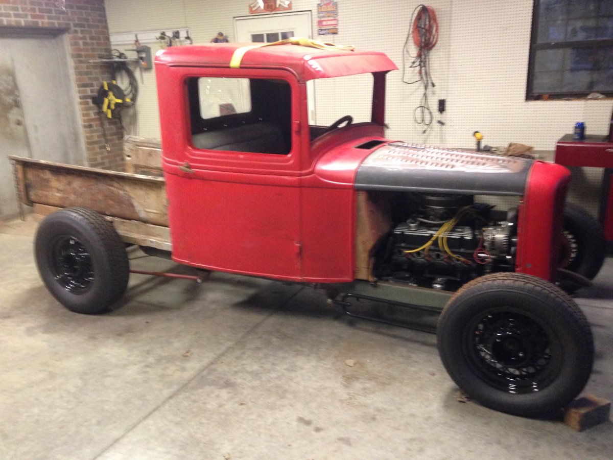

  9. woodsnwater
    Joined: Apr 4, 2016
    Posts: 502
    woodsnwater
    from North Al.
    I'm doing one now because I didn't know any better when I started the project and I've come too far to change directions now. Don't do it. Get you a 32 or a 33-34 frame depending on the bed length you have / want.

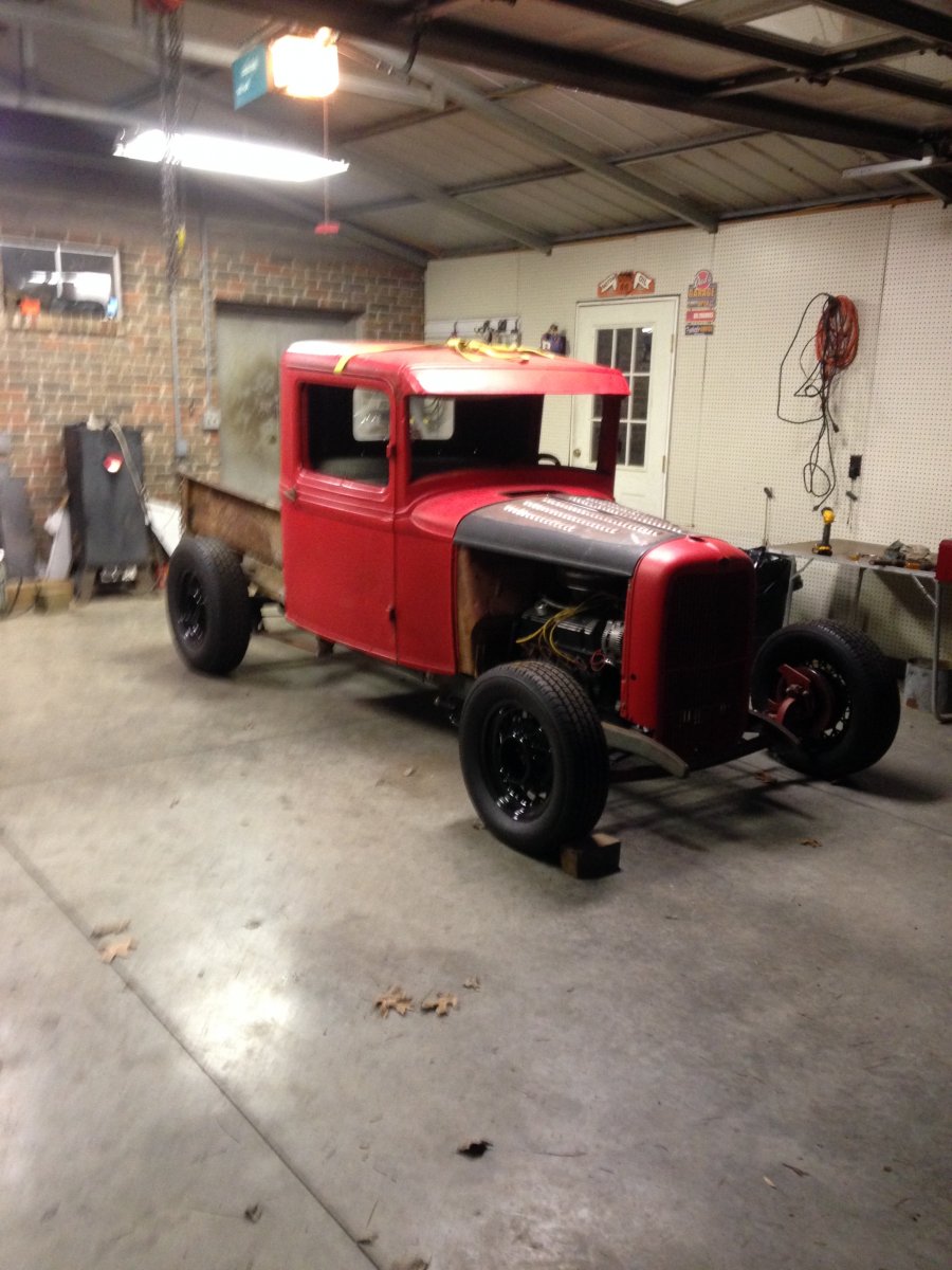

  10. woodsnwater
    Joined: Apr 4, 2016
    Posts: 502
    woodsnwater
    from North Al.
  11. Schwanke Engines
    Joined: Jun 12, 2014
    Posts: 777
    Schwanke Engines
    That looks Nice. I am having trouble coming up with a 32-34 Frame. I am on a tight budget and I let my dad have the complete 34 Pickup with fenders and Frame. And took the 34 Cab with Grill. I am not running fenders and have JW Rod Garage Model A frame laying here that I thought I could use, but I am 6'2" 300lb fat guy that needs some belly and Head room so the whole Channel thing is kinda out the window I plan on a 2-3" chop, but that's about it. I just need something affordable and dont really want the stock 34 Wheelbase, so a 32 Style frame will probably be the best route.
    Maybe I can give an Idea what I am going with here.
    I was working on acquiring parts for my Model A Tudor.
    But have always wanted a 32-34 Pickup and we acquired 2 recently so I am taking all my Model A stuff and moving it onto one of these trucks.
    I have a 286 Stroker Flatty backed with a 42 F1 3 speed, going to a Frankland Quick Change setup on Ladder bars with Coil Overs. I am running 37 Split bones in Front with a Drop axle. I want this thing to be Low, and agile so whatever frame setup I need let me know I love the idea of the 32 WB and a shorter box, but also want it to be usable.
    Unless someone has a reasonably priced 32-34 Frame they need to get rid of I would like to make use or trade this Model A frame off.
  12. woodsnwater
    Joined: Apr 4, 2016
    Posts: 502
    woodsnwater
    from North Al.
    IMG_1924.JPG IMG_1912.JPG I went with the triangulated 4 link. 4" Z in the rear "C" notched above the axle. 106" wheelbase.

  18. Runnin shine
    Joined: Apr 12, 2013
    Posts: 3,383
    Runnin shine
    As a owner/builder of a unfinished 32 PU project... I can with total certainty tell you to not build it on a model A style frame.
    I have been building mine on a 1930 Plymouth frame(heavily, extensively, and completely modified) to resemble a 32 frame in proportion. My truck tins came as a roller on this frame. I was broke, like challenges, had more time than money, and figured I already spent some money on this one anyway, etc,etc,etc. I would never recommend someone take this road though.
    Please do yourself and the cab a huge favor and get a set of 32 rails or at least 33/33 style. You won't regret it when it comes to finished project and hassle.
    As a bonus the PU will be much more desirable on a 32 frame if you ever have to part ways with your project.

  20. sloppy jalopies
    Joined: Jun 29, 2015
    Posts: 5,256
    sloppy jalopies
    in woods n water's right hand shot note how high the back of the cab looks when the A frame angles inward and disappears... IMO...use a '32-'34 ... worth the price over the long run...

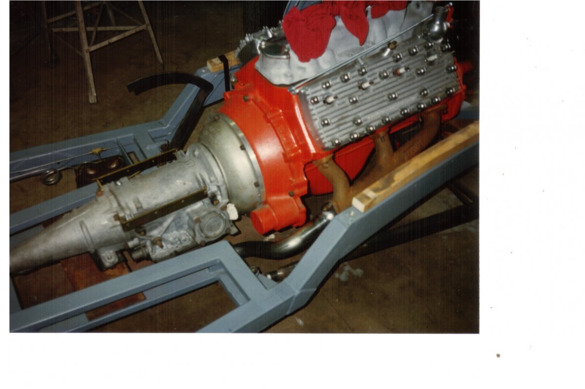

  23. PHIL COOPY
    Joined: Jul 20, 2016
    Posts: 409
    PHIL COOPY
    SAVE0004.JPG SAVE0003.JPG This is what I did for the '34 on the left. Sorry I don't have a picture of the full frame.
