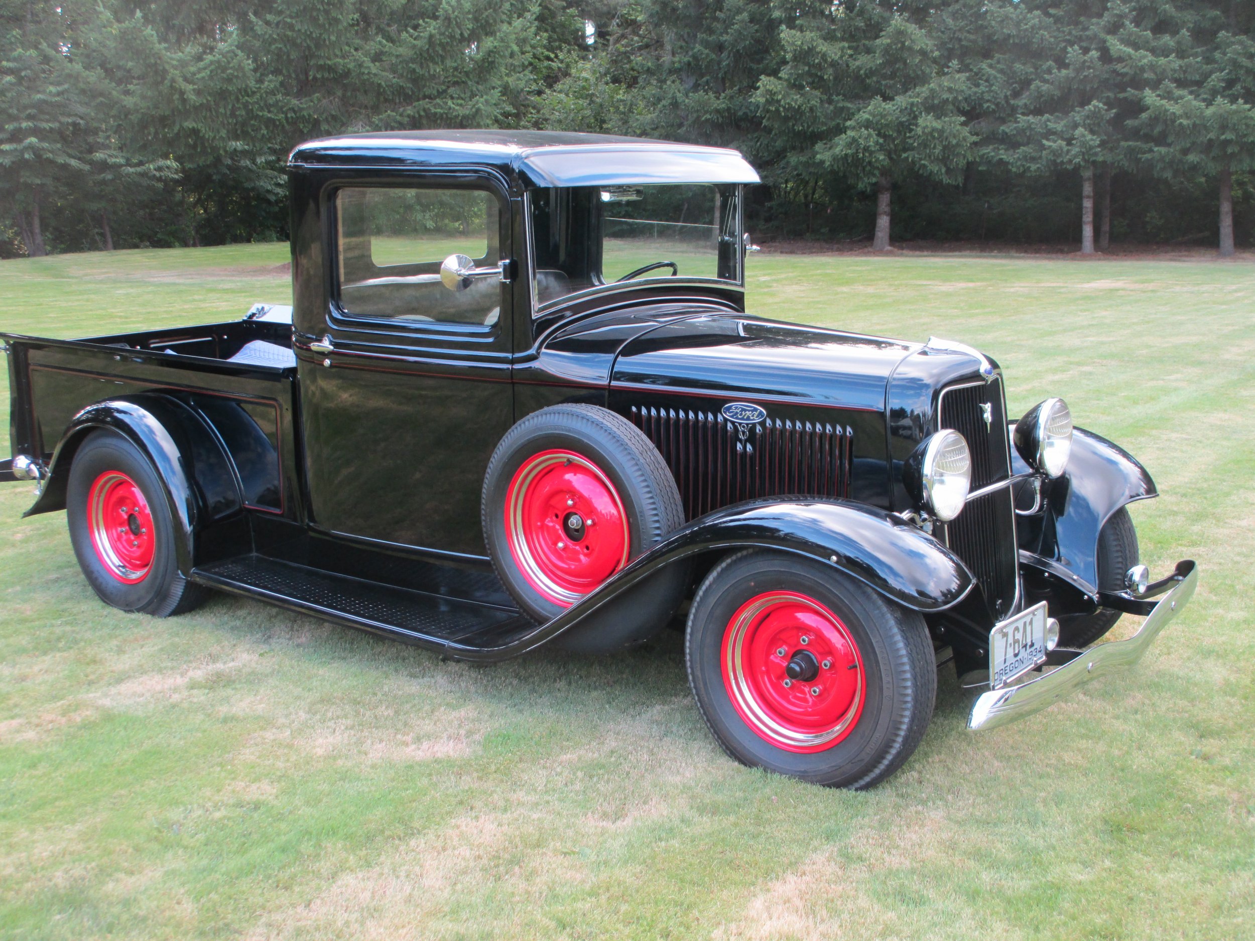

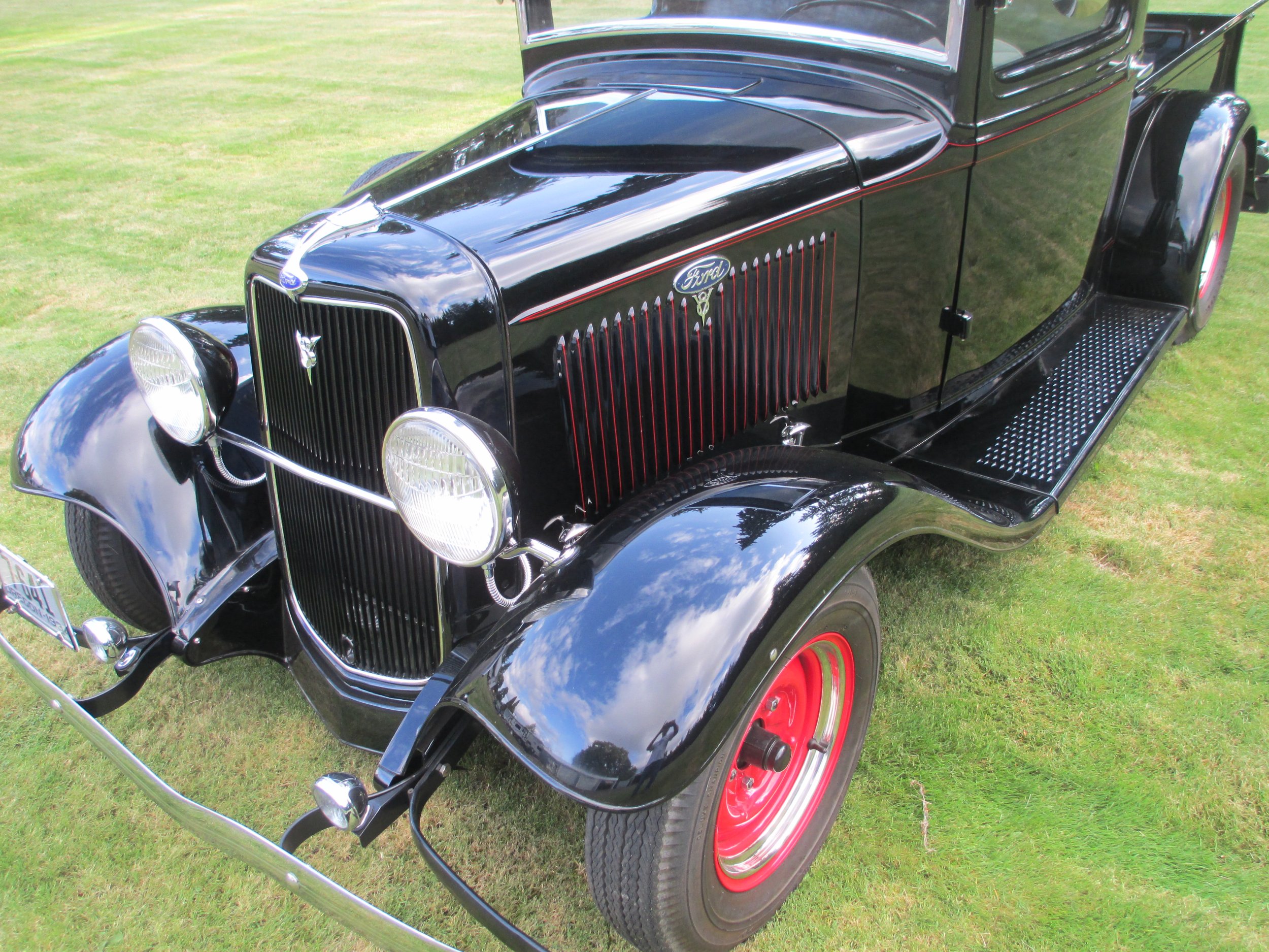

    thankyou... looks good to me!!!

    on a 34 the grille is thicker,...

    1. Central Nebraska H.A.M.B.

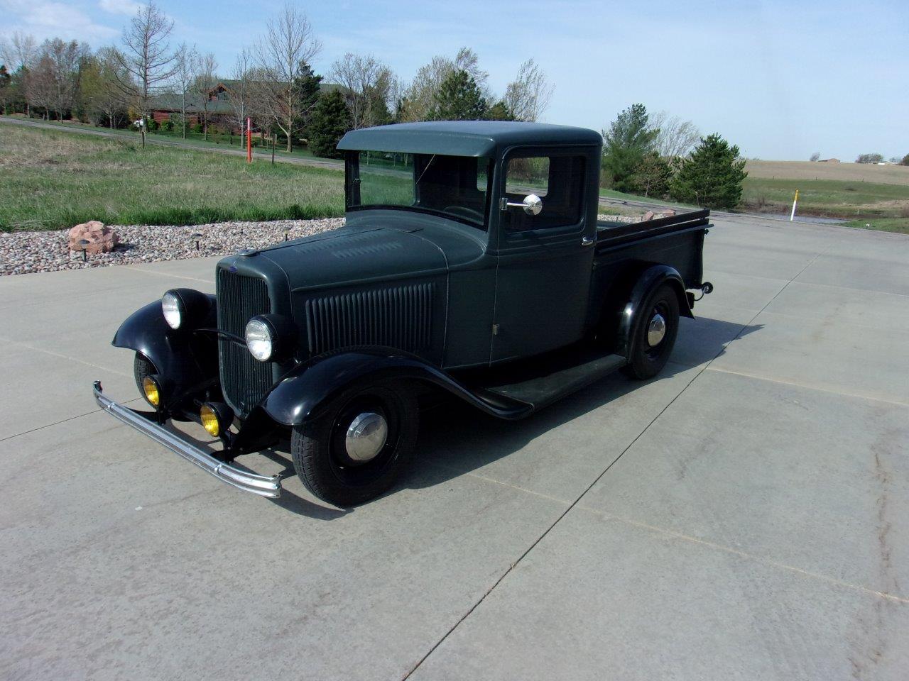

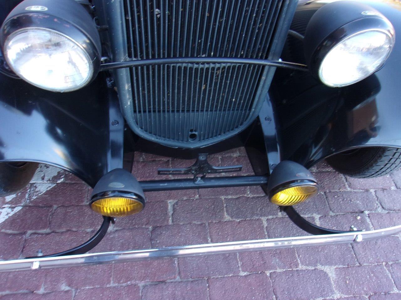

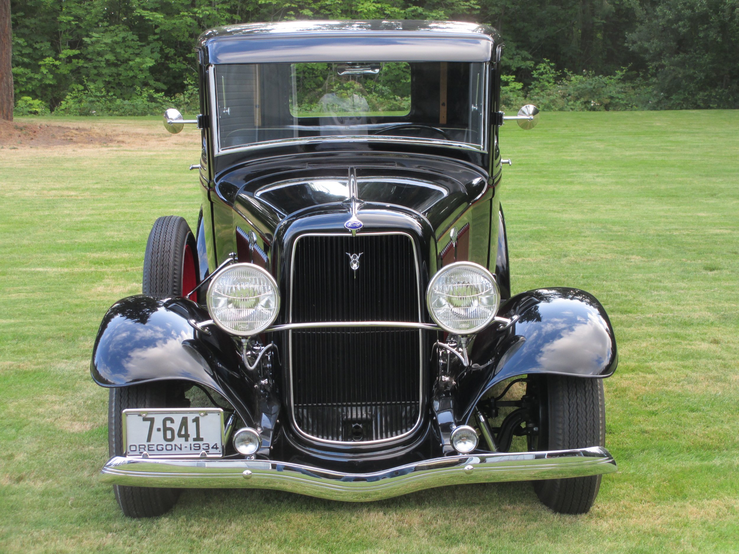

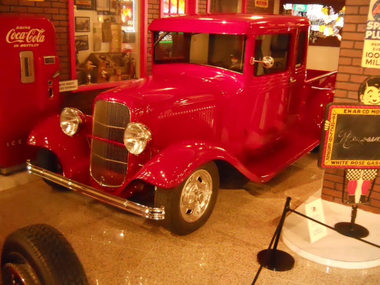

    Correct. But these pictures give you a general idea of what yours will look like with a dropped bar.

    thats why I liked the way this one was done, just remove the center sections at the light mount and turn it till it clears the grille... tig weld it , metal finish to where you can't see it's been cut... should work out great...

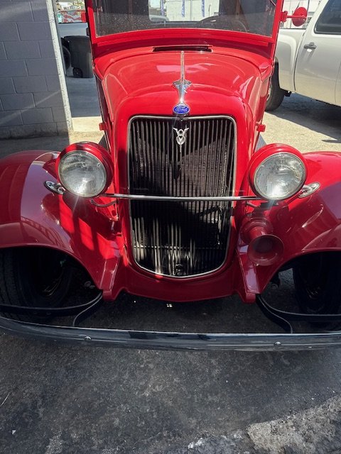

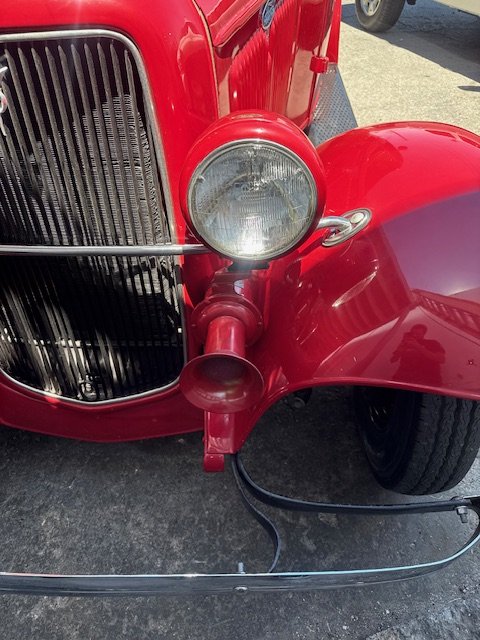

    I know, I know, the right way to do this is to spend 3 or 4 hrs rounding up the stuff to make a jig ...then spend another day trying to heat and bend a the drops to match..and hoping it fits...and hope that the bar doesn't collapse or that you ruin the head lite bar and have to get another one.. then spend another day buffing it ....
    so opted for the ordering one on line shipped to my door for 130 bucks..did have to cut the center and rotate it to clear the grille... then 2 little welds and done... also had to fab the horn bracket to be able to keep it on the lite bar..

    77568617486__A05550A1-FB4D-49D2-95B6-C0D0ED507490.jpg 77568618786__B9DC43E1-E510-4ABD-9D3C-68E848EDB7C0.jpg 77568620010__1A869C77-B932-4CC5-9BA5-B7A8F57CD8F0.jpg 77568621181__9A7C104A-DA4D-44C2-929C-3332DDCA2270.jpg whacha think???
    never did find pete... but was pretty sure he would not suppy the bar and do the mod for 130 bucks shipped to my door.... and no I did not have to read a car mag to figure this out...

    what about the light bar???did I do ok???
