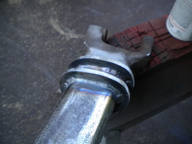

    For the frontend I fabbed up some frame mounted wishbone mounts...

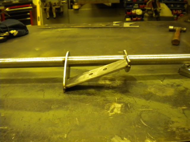

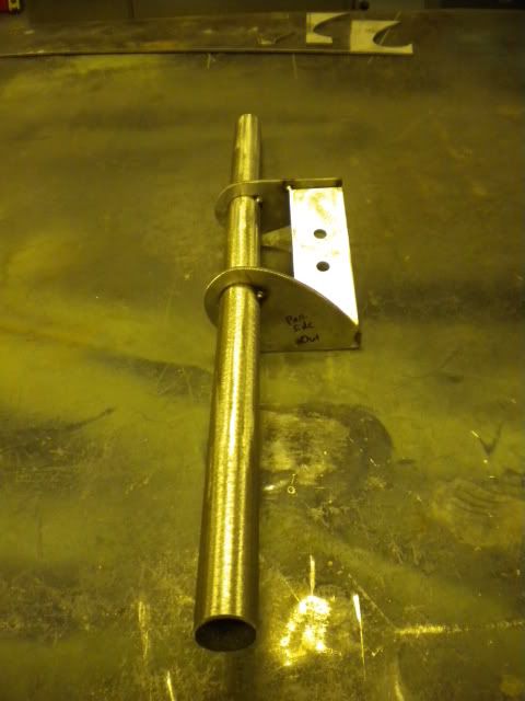

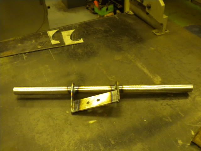

    Made a pair of spring hangers for the spring behind frontend out of some 1" DOM tubing and 1/4" plate

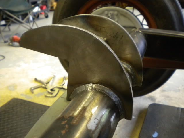

    Front spring perch...

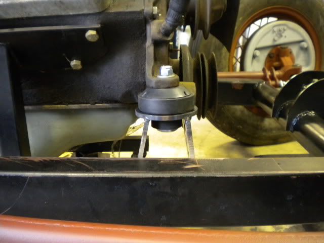

  3. I'm running a Camaro style T5 trans. so here's the crossmember I made to deal with the pain in the *** 15 degree mount...
  4. Looks great, keep going! Flathead, nice choice!

    im not a fan of suicide suspensions but those spring mounts look alot stronger than others I've seen..

    Nice looking welds !

    Your hitting me right at the heart of my being with such clean fabrication work. You've also addressed the strength issue with materiel selection that's more than adequate to the task. We've got to see this one through to completion.

    Thanks! I'm a total TIG newbie. I'm TIGing (is that a word?) as much as I can on this thing for the practice!

    Thanks Frank! I'm a fan of 1/4" plate, there's no kill like overkill :cool:
