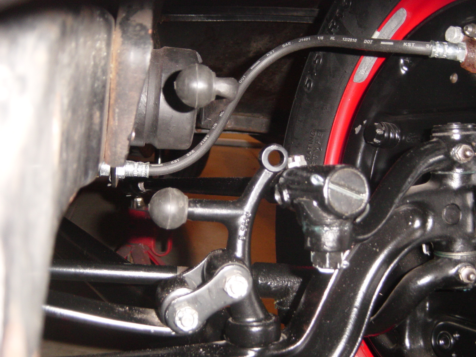

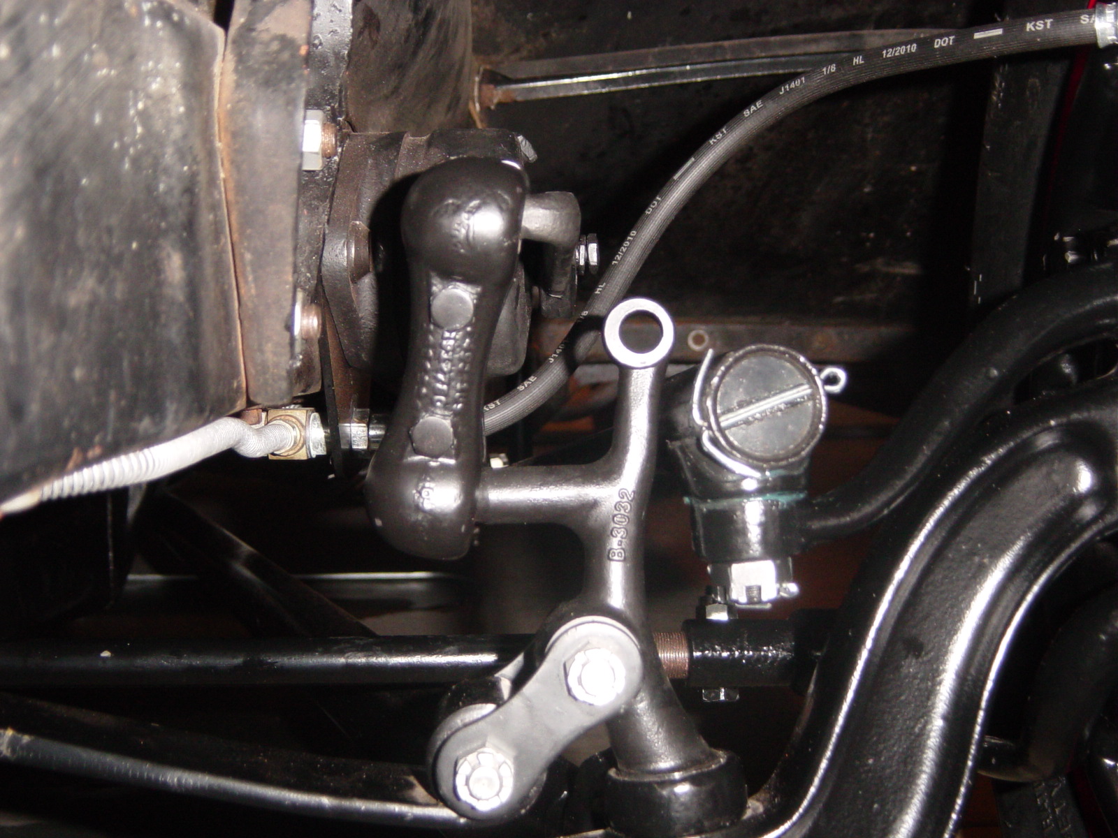

    34 Ford with 4" dropped front axle and original (Not split ) wishbone, original spindles with bent arms. I wanted to go to the original front shocks. Installed 32 style perch pins for the mount. I think they are beautiful with the arch. I find the left hand perch eye hits the top of the drag link. I have been told to cut the top eye off (not used) but as mentioned previous I like the style. Cutting the eye and it's shaft off seems to be the easiest fix, but I'm willing to go an extra mile. Any suggestions??

    Can you taper the steering arm halfway from the other direction and mount the ball to the bottom side? May need to bend the arm slightly upwards then.
  3. Do you have the kingpin locks/turn stops in? Hard to tell in that picture how far the wheel is turned. Are you turning farther than the turn radius is designed to go?

    it looks like your clearance problem is slight with the mechanical brake end of the perch just barely hitting the drag link....Is that the case? if so, you could probably heat and bend the link just enough to gain minimum clearance without changing the look of the part in a significant way.

    Why even leave the top portion on the perch if you aren't running mechanical brakes ? It isn't needed any more is it, or am I missing something ? You could cut off just the mechanical brake part and leave the part that the lever shocks mount to.

    It's quite simple.
    If you can bend the arm a little tighter to the axle, and then rebend the end so it sits right and you can gain enough clearance, that is one way.
    If you can redrill the arm from the other side (half and half) and rework the drag link (not that simple) to fit from below you might be able to fit it all in. The steering arm will need to be reshaped to get it in.
    The above method might actually help with the geometry for reducing bumpsteer.
    I did the same job on my 33, but with a dropped original axle and a bolt on steering arm.
    Here's my before and after
    And after reworking it.
    I cut off the top link to clear the first setup. If I had done it like the final setup in the first place I could have left the top link in place.

    Why not just carefully heat and bend the perch top arm so it just clears the drag link? If something gets reworked further down the line to create more clearance then it could easily be re-bent back to stock shape.

    I decided to bend the upper part of the perch. So far so good, I have to replace the tie rod end (adjustable drag link) due to interference with the boss for the Zerk with a 32-34 end that has both the Zerk and the clamp bolt on the same side. I should be good to go, will post photo after I get the tie rod end replaced.

    from OH
    I went the route of heating and bending the upper part of the perch pin. In addition I had to slightly grind a bit off the side of the perch for additional clearance. I changed the tie rod end (adjustable drag link) to the 32-34 style with the clamp bolt and the Zerk fitting on the same side. I believe the problem may be due to the axle being a aftermarket and not a Ford bent axle. The steering arms are all ford and have been bent to this axle and are tightly bent to the dropped axle. Thanks for the responses and suggestions!
