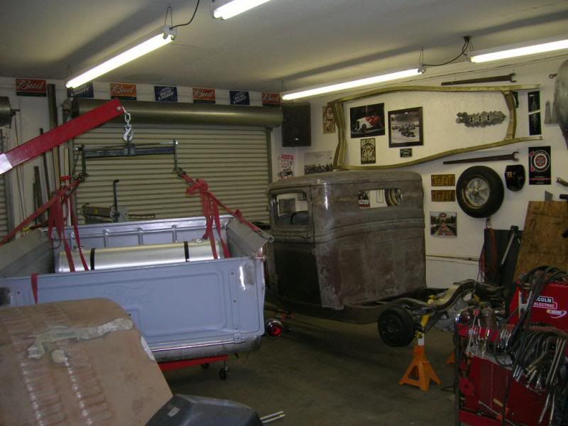

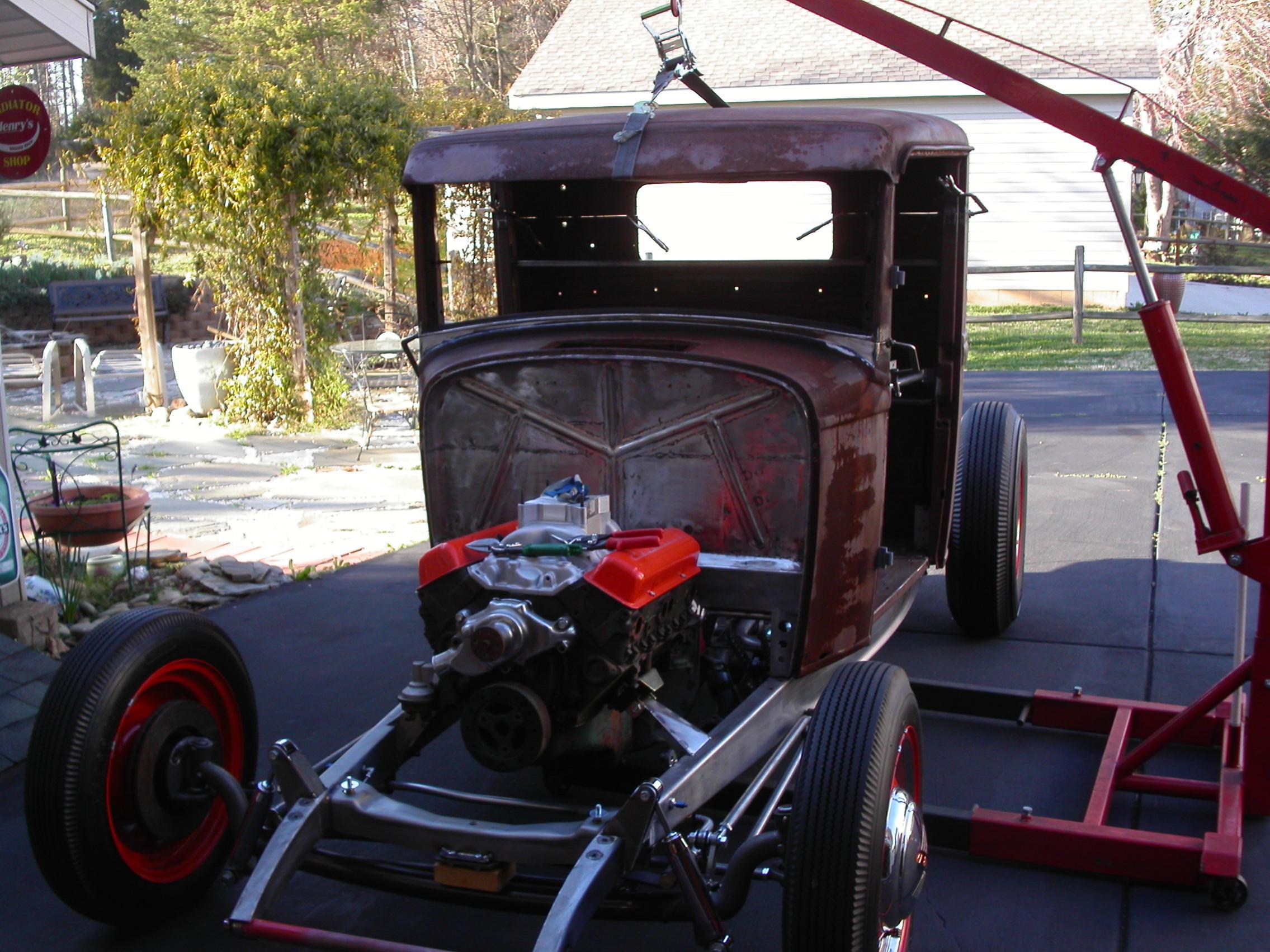

  11. When I last left off, it was time to do the counterclockwise with it. I almost did the 'well, let's drive it for a bit to work out any kinks' option. I decided not to, since it just makes it harder to blow it back apart. Besides, it just adds dirt, oil, and other stuff where it doesn't need to be.
    More pictures. Counterclockwise....man, it's hard to go backwards!

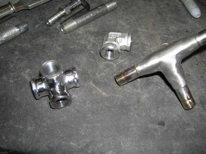

    Also made some other parts and pieces (that's the fun of workin' in the shop, right, don't pick up the phone, make some stuff....!) for the motor. Fabbed up a center fitting for the fuel lines for the 3x2. Didn't like the fitting on the right at all, it got chunked. Ground, filed, and polished some 90's to look presentable, too.
