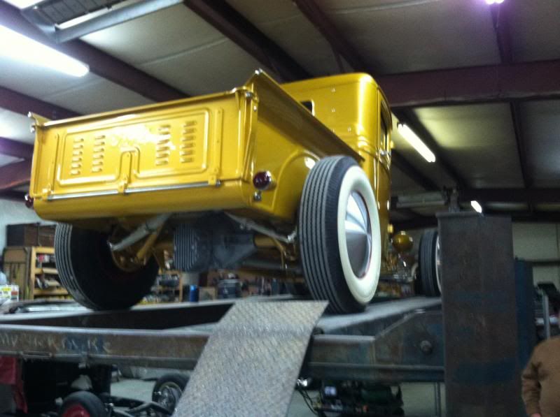

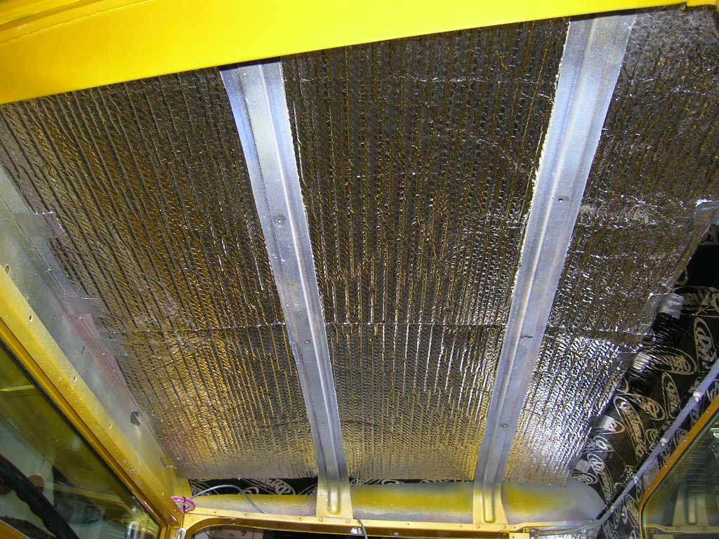

  10. Got the glass in it, rollin' up and down, swingin' in and out. Disassembled the regulators while I had 'em out, cleaned up good. Took it back over to my buddy's place to do the exhaust work. He recently got an exhaust pipe machine, so nothin' doin' but give it a go. Here are some 'on the rack' pics.
    Oh yeah, put some Dynamat in it to reduce the 'tin can' effect inside. Got it on everything, the roof, the back, the floor, the firewall, in the doors...
    On the lift... sorry, phone pics (or is it 'sorry phone pics')

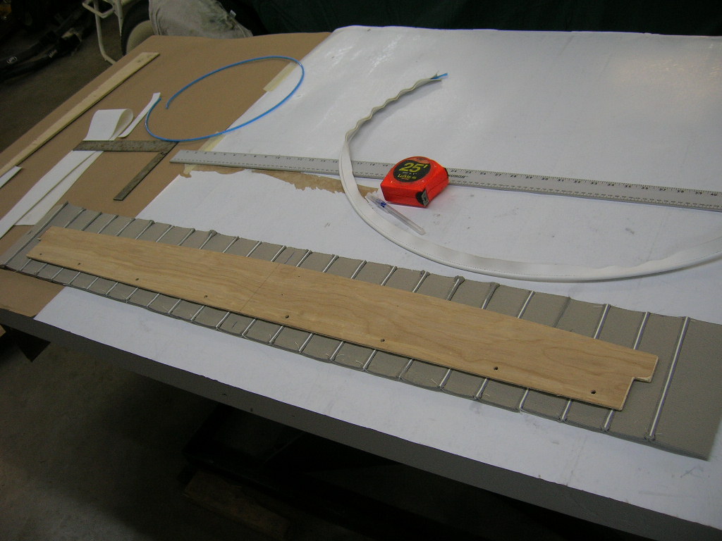

    Measured and measured, plus a cardboard template or two. Ended up with this.
    Gave 'er the ol' test fit.

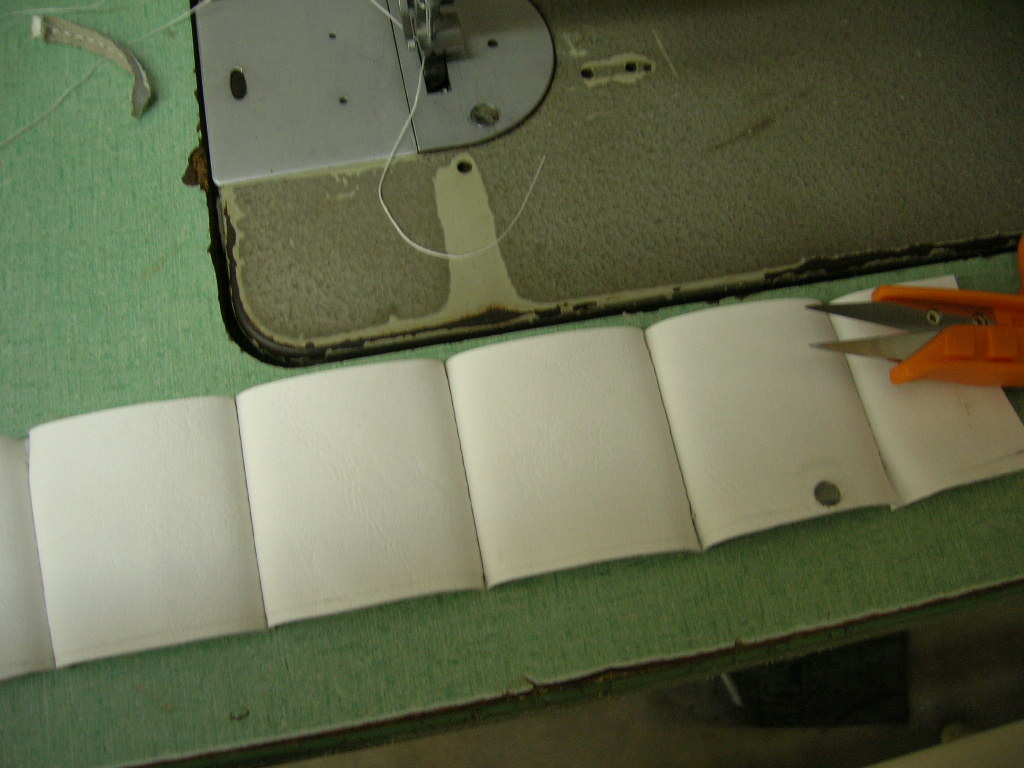

    Then tried my hand at making some piping. Went online and bought some welting feet for the machine. Not to bad to do. I used some small nylon tubing for the core. It was stiff, yet flexible, makes a good straight line.

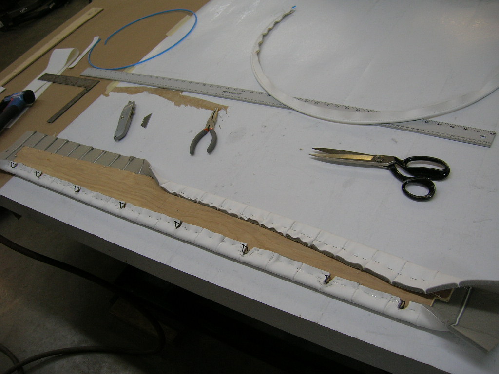

    Then I made up a pleated panel for above the windshield. First time trying some pleats. I sewed them straight down first(from the front), then folded it and sewed again (from the foam side), about 3/16" from the first sewn line. This gave me the hidden stitch look I wanted. I cut the excess fold off so it would lay down better. You upholsterers may be shakin' your head, but it's all I know at this time. Worked for me.

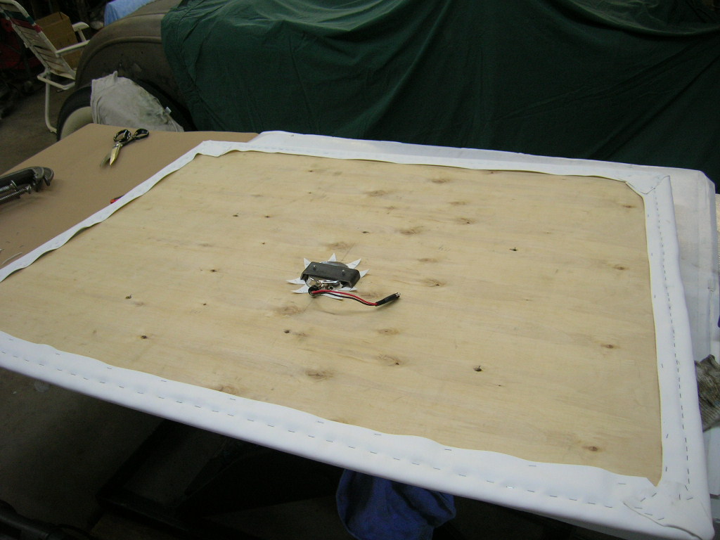

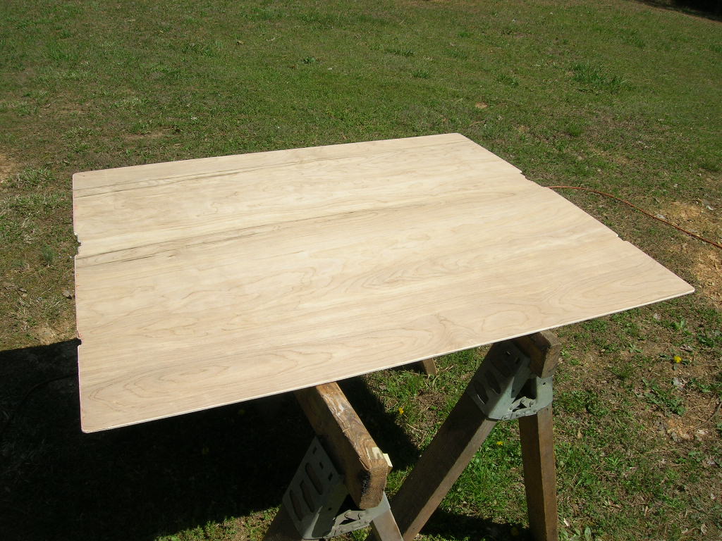

    Made up a board to fit. Counterbored where the 808 panel clips go, so the material would lay flat. Cut notches where the seams were, so the material would not be so lumpy on the edge when folded over.
    Some adhesive, some cuttin', some staples. On to the install.
