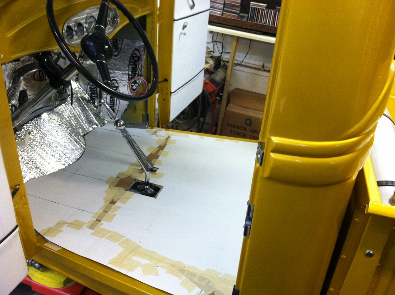

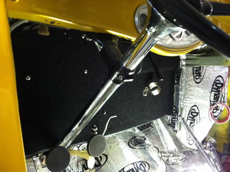

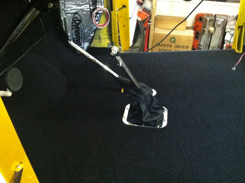

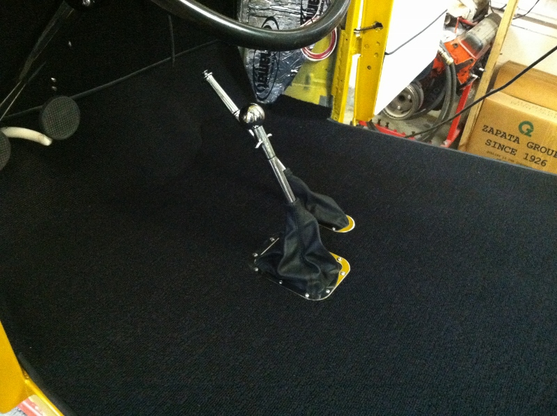

    So before I could make the kick panels, I figure I really need my floor covering in so the panel length would be right. Searched for a good while for some rubber type mat to install, but to no avail. Just didn't see anything that would work good. When I would find something I liked, it wouldn't come in a wide enough size. SO.....I broke down and gave into the idea of carpet. I really didn't want this thing to be 'streetroddy', but....in goes some black carpet. THEN the carpet search goes on....there's black and then there's BLACK. Ya know, it's gotta be what your looking for or you won't have your heart into it when you're installin'. Too many dang choices.
    I put a layer of heat insulation on top of the dynamat, what the hey, can't hurt. Make a cardboard pattern, that's where it all starts.

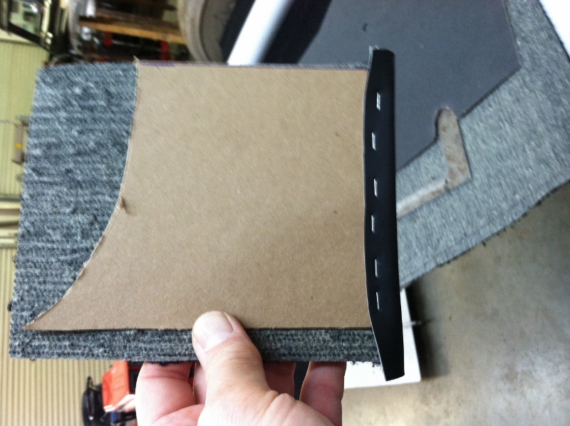

    ANYWHO....It's the little stuff that bugs the crap outta ya and makes ya scratch your head. How to kill off the edge of the carpet at the door opening. You never really thing about this stuff when you're gandering at other hot rods, at least I didn't. Do an angle piece from stainless, just glue it down, aluminum piece, etc. So, a tip from my buddy Chad...cut strip of vinyl, flip it on it's back, sew it to the carpet edge from the top, wrap it around, glue it or staple it ( I glued it since there was no board in this application). It comes out pretty neat, feel free to use it some time. Also used it on the fuse panel cover and the bottom of the firewall cover.

    Fabbed up some boots and got it all squared away. Doesn't look like much time involved, but when ya don't know what yer doin'...... she's in though.

    looks good. For the carpet trim, once you fold it over...you can topstitch through the trim and carpet as well on the sewing machine

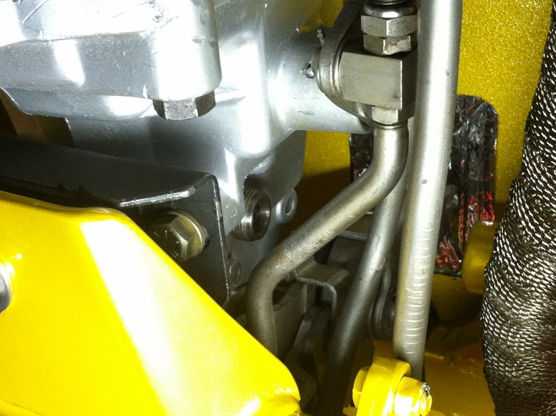

  19. Well, AT&T comes through, got a new router out and installed...good to go.
    If you've ever dealt with running ANYTHING under old rides like a '32, you know space it at a premium. Especially if you've got manual clutch linkage, 4-speed shift linkage, master cylinder, and crossmember stuff thrown under there. I had really been wanting to run a manual S-W speedo (had a good old one), but man, there was no good way to get from point A to point B. The cable went OK through the shift linkage, but the rest of the way to the speedo was like walkin' through kudzu. Coming up through the floor meant coming up 4 or 5 inches over from the kick panel, right where your feet are (and the master cylinder, and clutch linkage, and...). Too many sharp bends, a lump in the floor, and lookin' like a mud hut. I wasn't gonna just stick it up and through the front of the firewall either (more 'mud hut'-ness'). I tried, believe me.
    So, I gave into the idea of the electric speedo (reluctantly, hell, it had carpet now....geez). Well guess what, the dang sender for the speedo wouldn't come close to cooperating with the Munce shift linkage. Pisser! What the hell, I just want a speedo that works, is that asking too much? Thinkin' cap goes on....got an idea. Cable to the remote mounted sender...gonna do it...gotta do it. Check the pics, you'll see what I be speakin' of.
    Tight spot...
    From underneath...

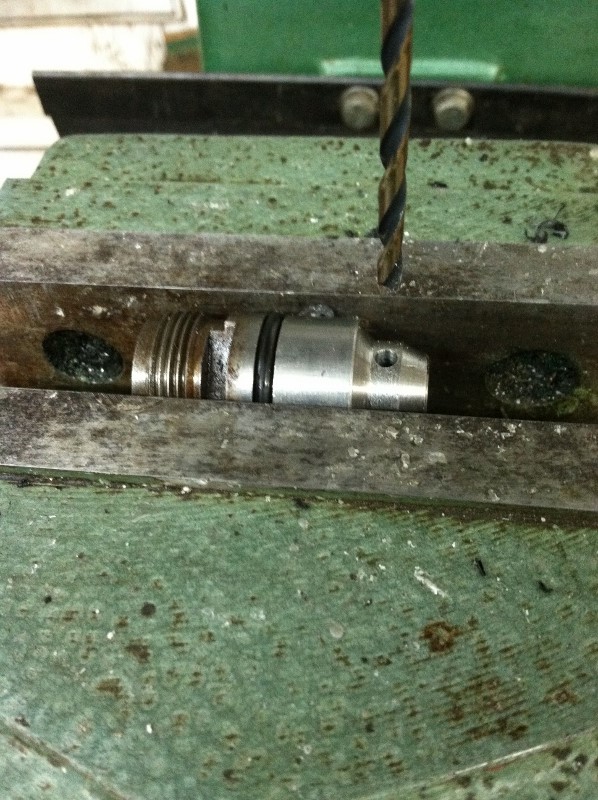

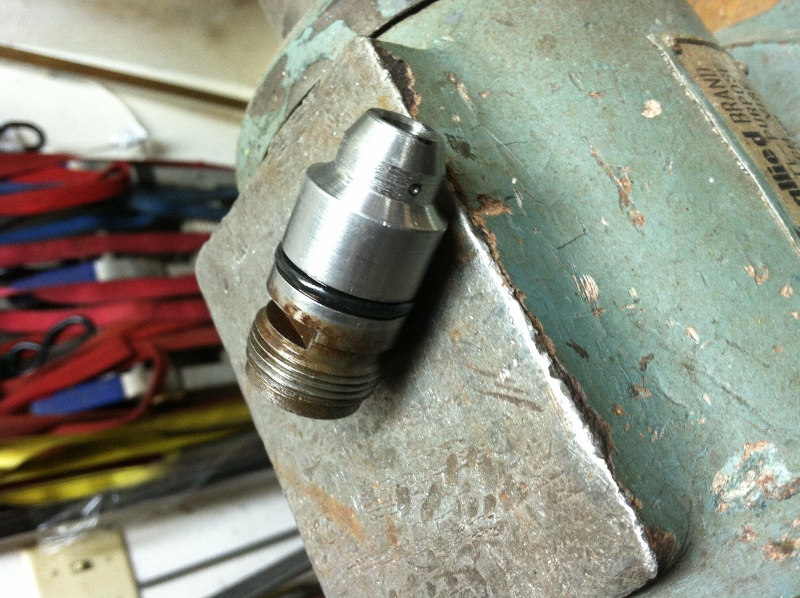

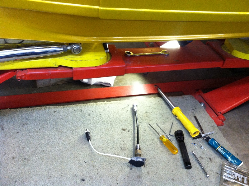

    So I happened to have an extra speedo fitting for a Muncie. Turned it down on one end, added set screws to hold the cable, and bored it just a bit to fit the OD of the cable.

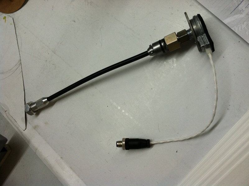

    Cut down a cable and added the end for the sender...gettin' there.

  20. Now to mount the sender on the frame rail. I put a connector on the wiring to the sender, just in case I ever have to remove it. Dang sure don't wanna snake that wire back up to the speedo again. No pictures, didn't happen, right...here ya go.
    Goin' in...
    I fabbed up a plate to go on the outside of the sender to hold it to the frame rail. Two tapped holes and BAM, she's there.
    I tell ya, this kinda stuff just eats time. But what the hey, it's an adventure and a learning process. Building one yourself keeps the brain cells from dying. Someone probably sells something like this, but I don't know and didn't even look. Good times.
    I'll probably put some kind of a small heat shield sumpin-sumpin to protect the cable from the heat of the pipe. It's actually just off of the pipe and not crooked as the fisheye lens makes it look. I think we're there, close quarters.

    That is a neat enough idea for the carpet edge, however there is also this:
    https://www.bondproducts.com/instabind-carpet-binding-tape/
  26. Good tip right there, thanks man!
