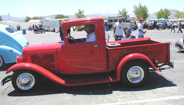

    The Black one is a 32 ... the Yellow one a 33 - 34 ... see the 6 inches difference in the wheelbase ( behind the cab ... before the rear wheels )

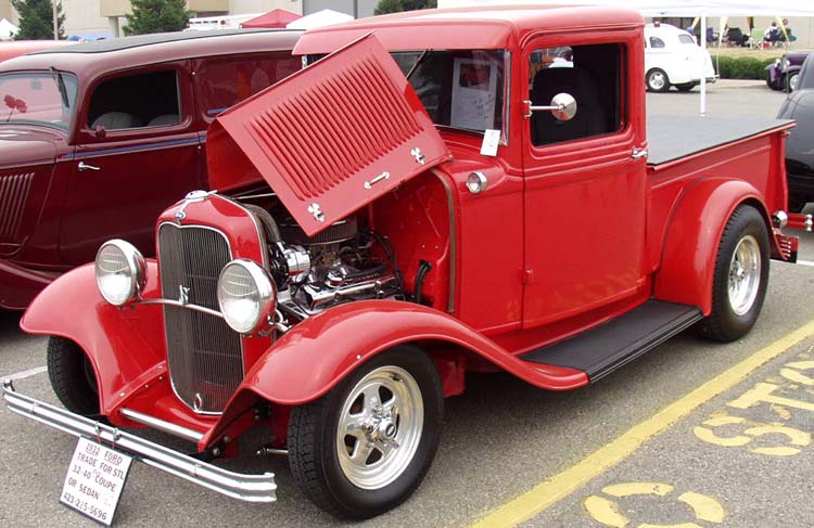

    The red one is a 32 ... and the primer one is a 33 -34 ... look at the firewall differences ... the 33 -34 firewall sticks out ... :)

    The 33-34 bed will have to be shortened to work on a Deuce frame. Look at the pictures above. The distance from the back of the cab to the center of the wheel well is longer on the longer wheel base 33-34 trucks than the 106" Deuce trucks. The bed can be shortened in that area to make it work on a Deuce frame.
    It seems to me that 1/2 of the hot rod "Deuce" P/Us that I see have 33/34 cabs.:D Nobody notices.
