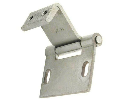

  4. As far as the rubber sticking out passed the frame, you can cut it off with a razor. I just recently put the correct, compound angle, hinges on my Coupe. It should swing out, not pivot, so it clears the body. You can always go to a hardware store and get a thinner seal. I wouldn't mount it in solid, unless you have a cowl vent. That air makes all the difference in the world to be comfortable. Try your best to make it swing open.

    Bad Bob
    good point about trimming the rubber, thats a good option.
    Would you have any pics of the compound hinges you used in your car? P would really like to se what these compound hinges are.
    Thanks for your reply
  7. I'LL HAVE TO FIND ONE...
