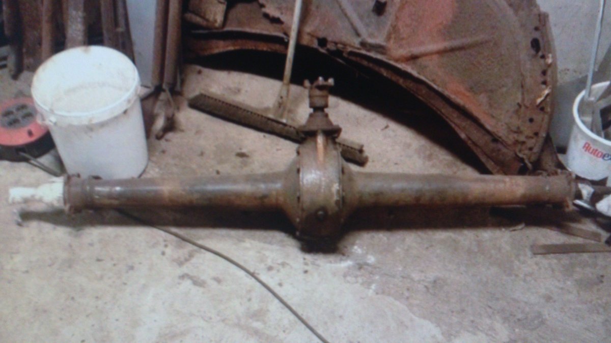

  26. patmanta
    Joined: May 10, 2011
    Posts: 3,882
    patmanta
    from Woburn, MA
    This thing will take the same brakes as any other Ford banjo rear end. You should not have trouble getting this stuff. You must be digging in the wrong place.
    The only thing you run into with these is if your yoke stuff needs replacing; that stuff is harder to come by. There are no repop R&P's for these to my knowledge.
    Otherwise, it's just a Ford Banjo Rear End. You can put any 39-48 rear plates, spindles, & drums on them. If there are active street rodders in your area, they probably s**** this kind of stuff all the time so keep your eyes on your local CL.
    Whatever V8 Bones you can get your hands on would be a good place to start but I would suggest a set of the longer 40 rear bones so you can shorten them if need be. You are going to want to consider a torque arm too. For now, you can mock up with flat bar, angle iron, or tubing to keep things together.
    It's too bad you're as far away as you are because I have a bunch of this kind of stuff. I got a lot of it looking for cleanouts and stuff like that. When you're rescuing stuff from the s**** heap you can get a good, big pile of rusty legos for short money.
    brEad and Nailhead A-V8 like this.
