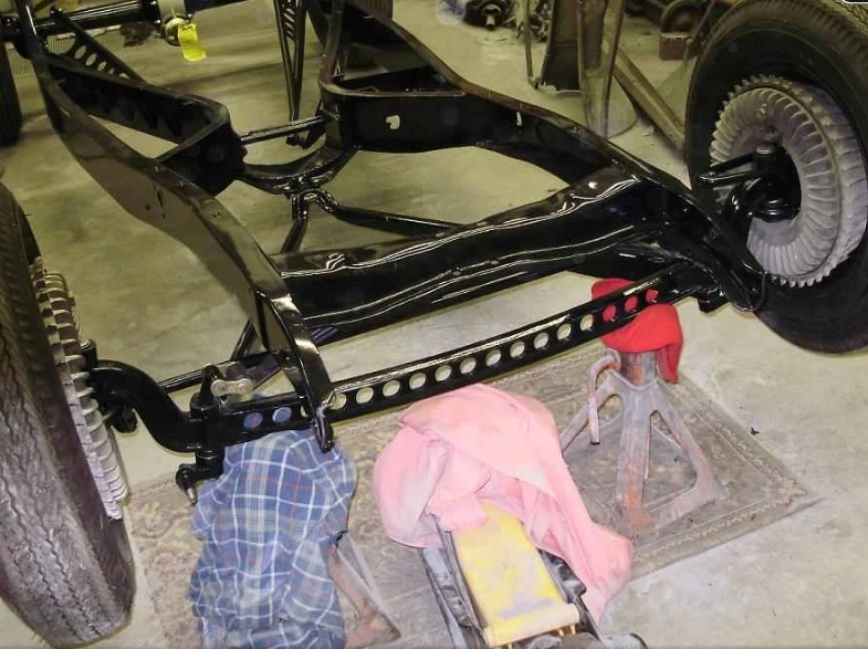

  1. Does anyone have any pictures or sketches of how I can modify a stock front crossmember for 34 Ford, so that the spring will sit higher in it? What would the maximum amount be that I can raise it? I remember reading that one could cut out the center and weld in some flat bar higher up, but a visual would help.

    Kirk Hanning
    I raised mine about 4" by cutting the crossmber up into appropriate pieces then raised the center section of it and filled in the balance with the cut out pieces. If that makes any sense?

    343w
    I used an old 40 Ford front cross member for my deuce frame. Cut the stock member in 3 pieces with straight cuts where it angles to the center section,the 2 sides pieces will now need to be cut on the edges to meet the center piece at 90 degrees to make the whole member flat. It won't change the length by doing this, it will only take out the angles. All it will cost you is time and effort, I used a metal chop saw for mine, then welded it back together. I did the same thing with the rear using a 40 rear member...

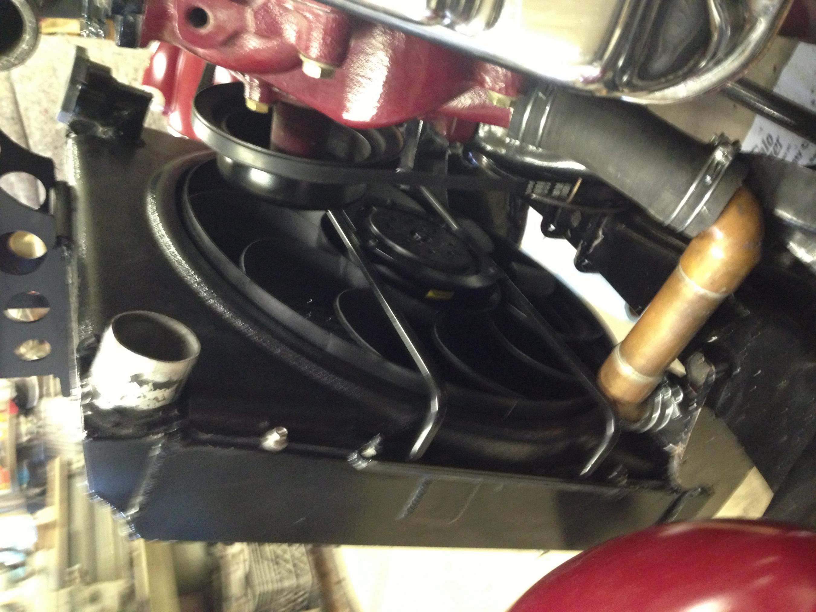

  6. Kirk Hanning
    Joined: Feb 27, 2005
    Posts: 1,605
    Kirk Hanning
