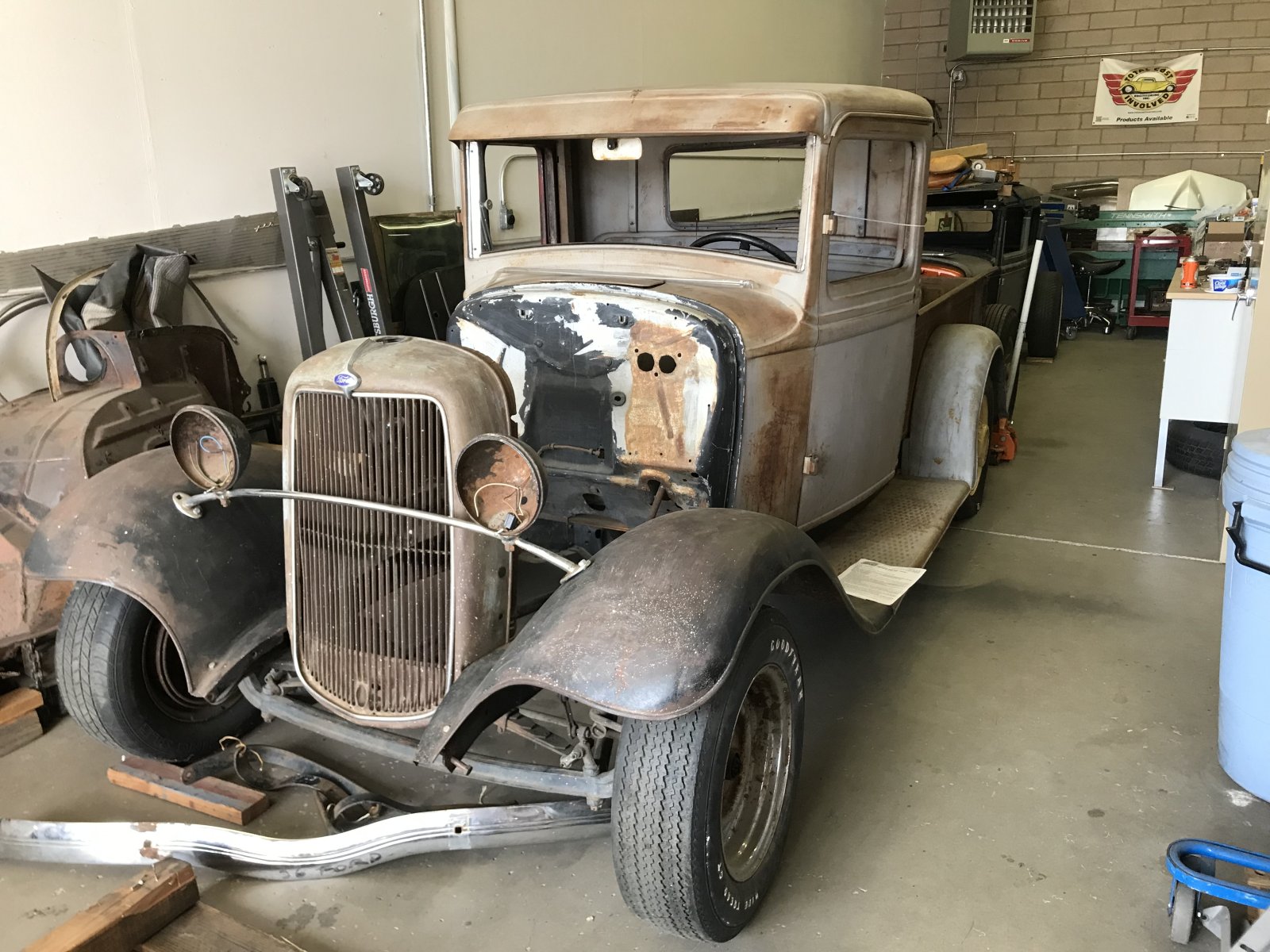

    Finally posting some pics. This was in my dad's garage for many years, he sold it, bought it back and again sat in his garage for many years. Never ran, never worked on so I un-buried it and dragged it to my shop before he sold it once again. Sheet metal is just loosely attached to the frame and body without one OEM fastener. Its like someone blew it apart, lost all the fasteners and cobbled it back together. Suspension is all stock, axle is a dana 44. No drive train. So, here are my beginning questions since I've not worked on the 32- 34 Ford trucks before.
    1) I have a grill shell and hood but no radiator. How does the rad attached to the grill shell and or cross member?
    2) Suggestions on aluminum radiators with proper shape and brackets? Don't chew me out, going with a SBC cuz they are laying around my shop.
    3) Cab mounts - I know there should be some wood under it, can someone let me know about the wood and or any other bracketry? The doors sag at the back so before shimming the cab I want the correct pieces under it.
    4) Between the frame and body, body and fenders, bed and fenders etc. are there anti squeak gaskets, friction tape or any type of materiel or is metal to metal?
    5) Suggestions on vendors for sheet metal fastener kits?

    The radiator with the correct brackets for the grill shell bolts to the frame (with proper fasteners and whatnot) and the shell fastens to the radiator.
    As for the rest of the missing fasteners I'd say the "i'll buy new" syndrome plays big there.
