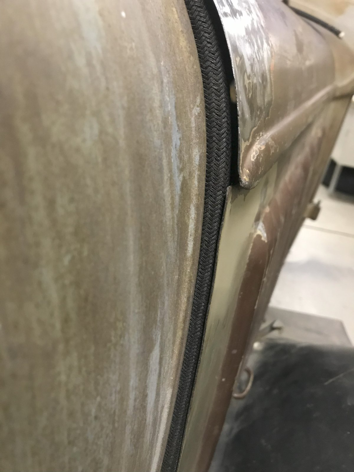

  7. Jeff34
    Joined: Jun 2, 2015
    Posts: 1,261
    Jeff34

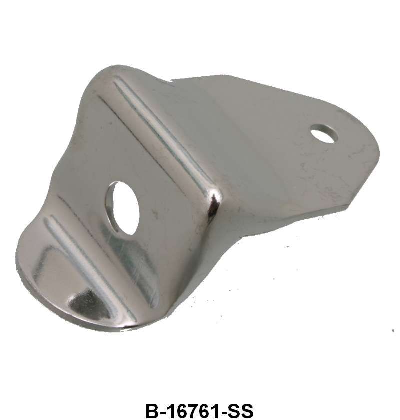

    NeedFiber
    Jeff, you have any J hooks being used on the cowl lacing? My kit came with 4 but I dont have any slots. I'm thinking its used on other years etc. One size fits all kinda deal.

    Deuce Lover
    I have the repro J hook kit that you can have but to far away .Go on www.fordbarn.com ,which is Ryans sister site for more help.Experts are there.
    Here is a pic of them. They are included in the lacing kits sold by all the vendors. I have a set of latches and window regulators to sell 20240828_094420.jpg if you need them

  12. NeedFiber
    Joined: Dec 20, 2011
    Posts: 160
    NeedFiber
    Does anyone have a better seal they found to use on the grill shell vs. the lacing that comes in the Vintique grill shell lacing kit? Its much to thick and has no channel to ride the "hump" that runs down the center of the shell sealing flange. The lacing wants to either run in front or behind the hump and if you place it on the hump the hood sticks up about a fat 1/4" too high. See pics.

    alchemy
    Original stuff is not supposed to ride on top of the ridge, it’s supposed to fit in the rearward groove. Might want to crush it a bit in the vise before installing.

    NeedFiber
    The problem is the U clips aim it at the ridge, it will work its way rearward but I thought that looked dumb/ incorrect. I ran it through my bead roller... one of em popped lol.

    alchemy
    Maybe it’s different than 32 stuff that I’m familiar with. I do know 33-34 p***enger grille welting has a groove in the middle. But it’s held onto the flat p***enger surface with split rivets along the whole length. Not a clip at each end like the commercial does.
    Looking back in this thread you can see how the welting fits on Jeff34’s truck in his pics. Right in the rearward groove, running over the mounting screws.
