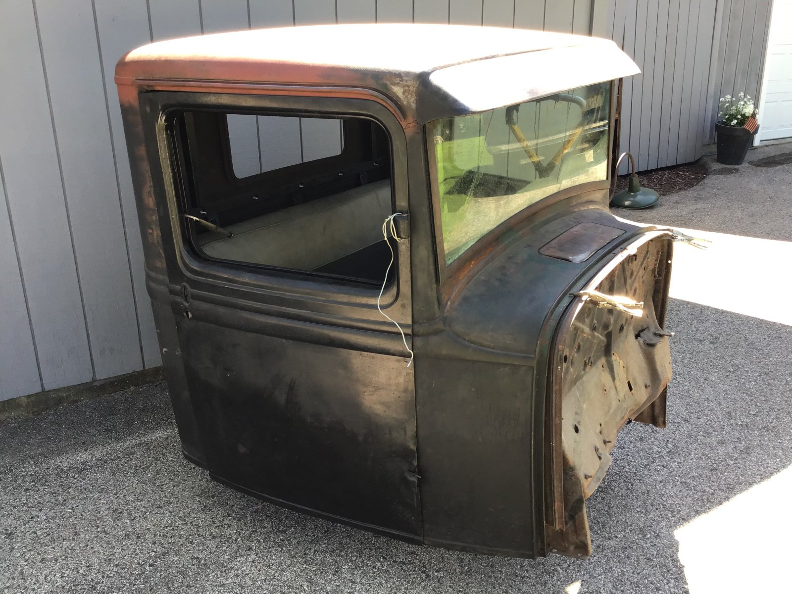

    I wish you were closer as I have this super solid 32 cab with no rust on the cab for sale IMG_7127.jpeg

    You are in luck being a 34 as the A pillar has a screw through the outside front corner of the roof lip into the A pillar . If you blow up the picture of continentaljohn 32 cab you can see 32 were soldered on at that point , generally broken but you get the idea.
