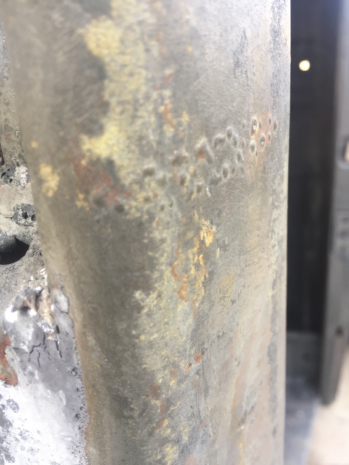

    this truck followed me home yesterday. the cab had been dipped to bare metal and i noticed some strange bubbles in one area on the left front. i started poking around and found that the metal seemed to blister out on both sides,so i drilled a hole in one of the blisters and found it was actually two layers of half the regular thickness. has anyone seen this before?[​IMG][​IMG][​IMG][​IMG]

    I’d guess you have an inner layer in there and it’s not really delaminating.
    The moisture may have been trapped between those two and caused the problem. Just speculating.
  4. i really don't believe the "dipped to bare metal", looks like there is still paint and as 56don mentioned lead.

    The difference in color in that area makes me think still has lead filler on it

  6. Looks like lead.

    Looks like the guy that spread the Lead didn't neutralize the acid after tinning. ?

    the area is definitely not leaded in that area. you can see what dipping did to the lead in the second picture. as i ripped the out side of the bubble off the pieces are magnetic.

    it is definitely down to bare metal. all the paint is gone. there is some seam sealer and there are a few areas where some filler was real thick and it did not remove all of it.

  10. Possibly bad metal from the factory. It's a wonder it has lasted all these years.

    that’s what i’m thinking cause it is only on one section, there are bubbles right up to one side of the seam on the cowl and perfect on the other side.

    I found that on my 33 after the dip. I had some bubbles in the rear panel. Almost looked like it was a laminate bubble, or like it was plated.
    When I ground it off, it took a while for the edge to feather out.
    I have no idea why it happened, just that it did.

  13. Maybe in the past that panel was replaced by someone using some odd metal? It is indeed strange.

    I'm guessing that there was some contamination in the steel that was trapped as it was rolled into sheet metal. I have seen this in non-automotive situations. At a machine shop I worked at we had something similar but different. Some aluminum bar stock that had separations inside it, that we only found while machining it.
