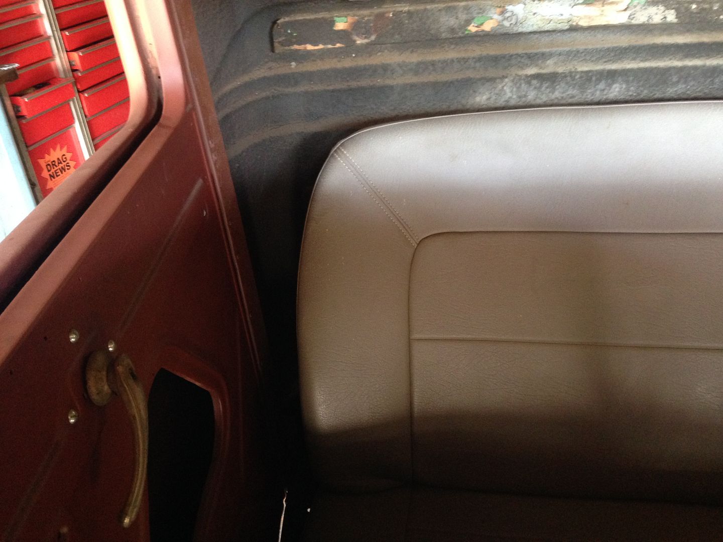

  15. greaser
    Joined: Apr 30, 2006
    Posts: 866
    greaser
    Truck is looking fantastic! Great combination of parts and expert craftsmanship.
    Sure could use a picture of that seat...What is it??

  19. greaser.....Here are a few pics of the seat. I have had it so long I don't remember exactly what it came out of but it is the p***enger seat from a big truck, possibly a Sterling. The bottom is a good fit but the back is a couple of inches too narrow, I can live with it. I may end up moving it back by removing the stock 34 seat support wood and I will probably lift the front a little when I mount it. You sit very low in the truck with the seat sitting flat on the floor.
