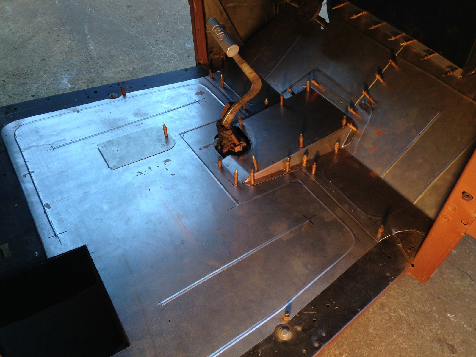

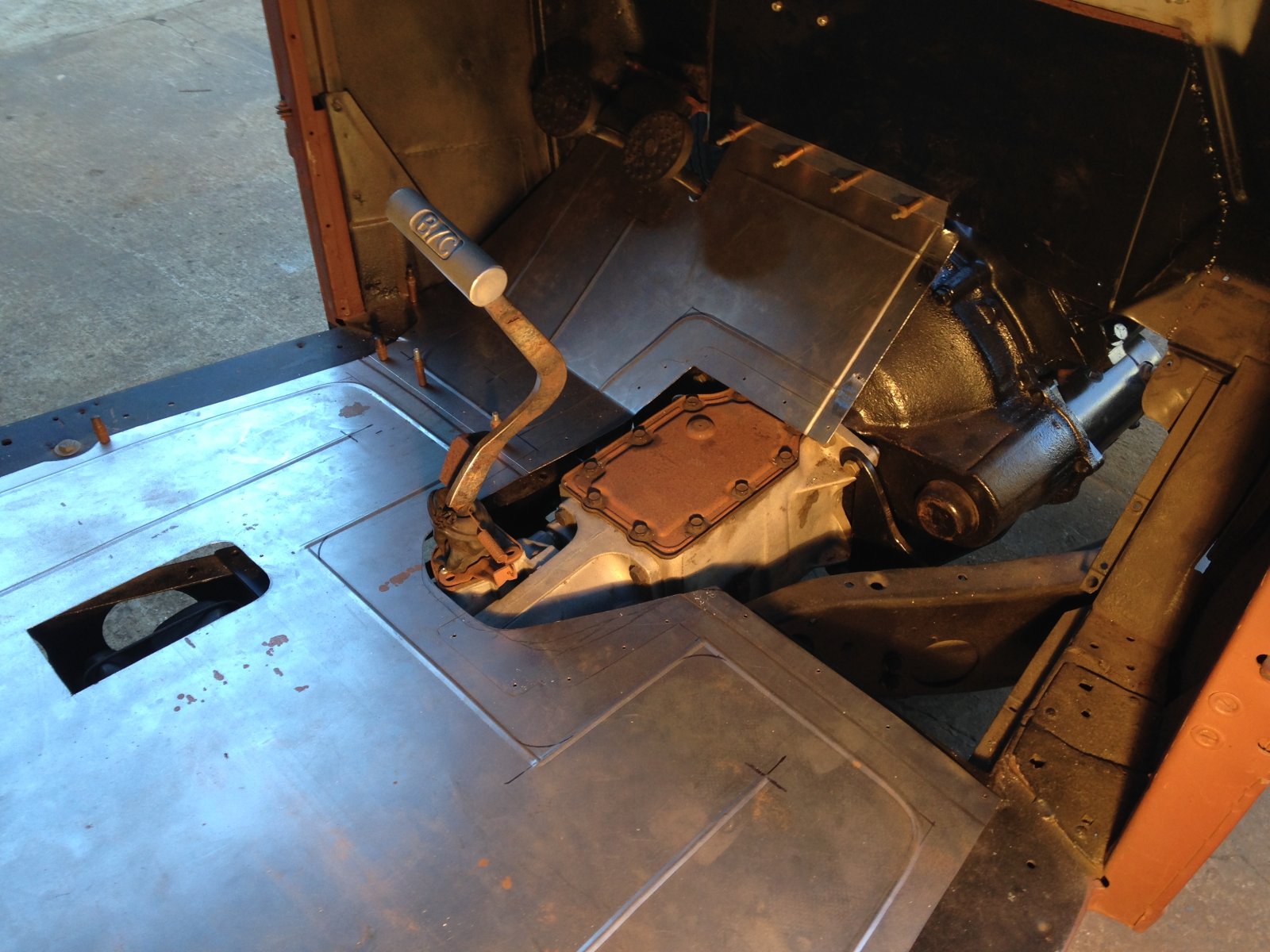

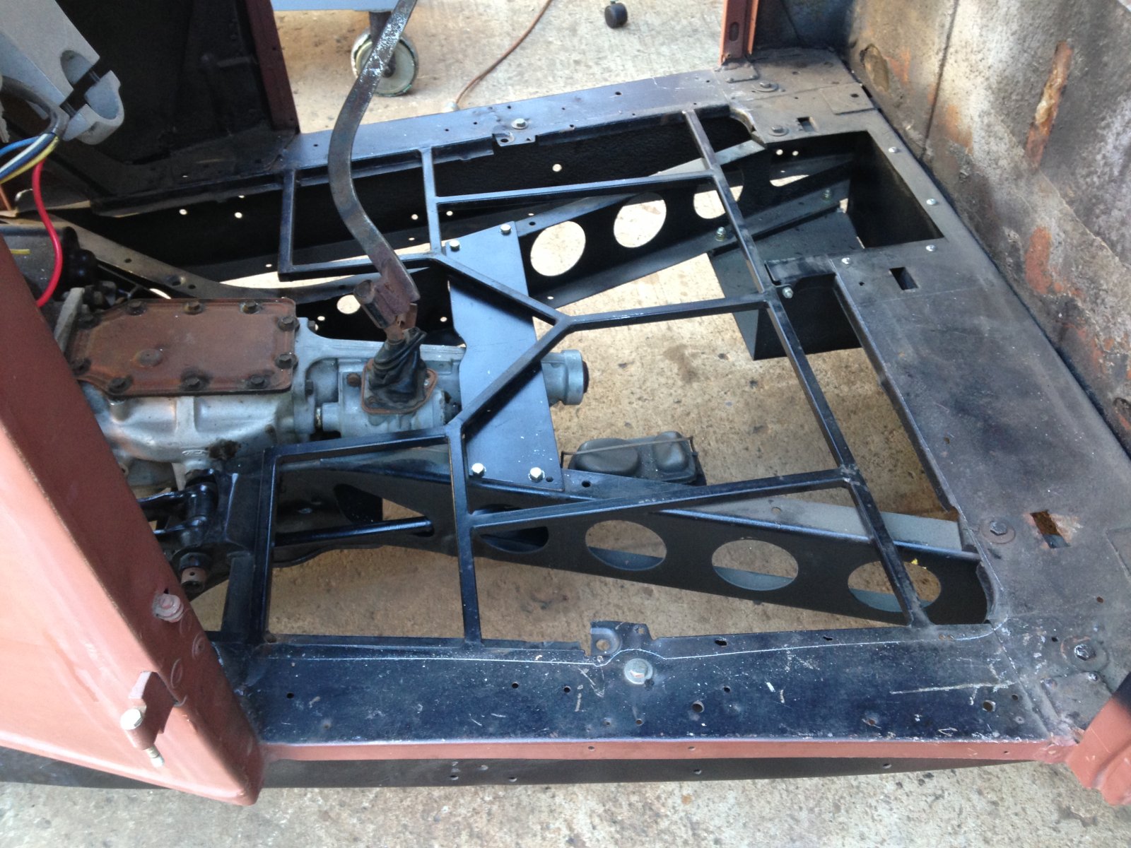

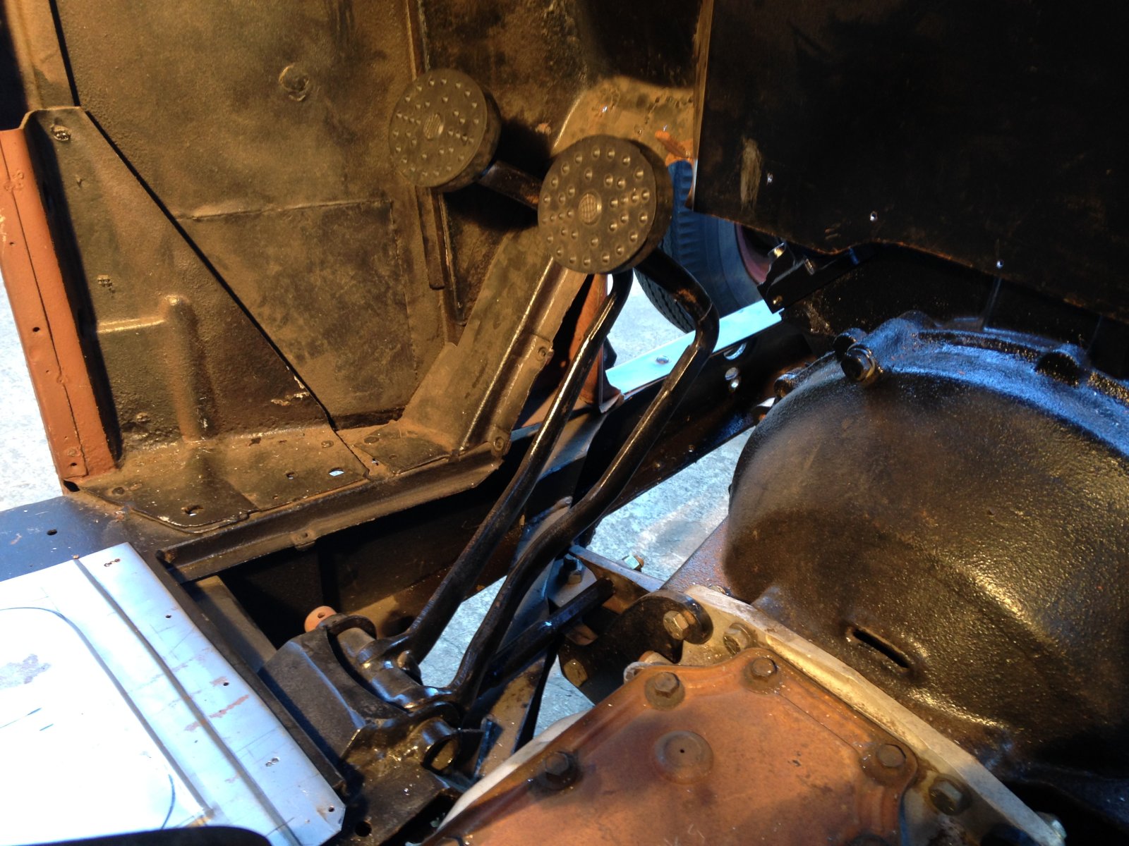

    It was time for pedals and floor. The issue with the pedals was clearance around the side mount coming off the bell housing. From memory I notched the crossmember in that area, rotated the pedal ***embly and mounted it with the pivot point higher and further back than it used to be. Some heating and bending then tabs were welded on where needed for linkage. Clutch fork linkage is a straight shot forward and brake linkage is a straight shot back to master cylinder. For all this to work I had to change the toe board angle a little.
    I built some tubing structure for the floor. You can also see the plate bolted across the top of the x member to help tie it together. Master cylinder and battery locations can be seen here.
    Next came floor panels and trans cover, can’t really call it a tunnel. I welded the back part in permanently and decided to rivet the front panels in so it can come out for future repairs.

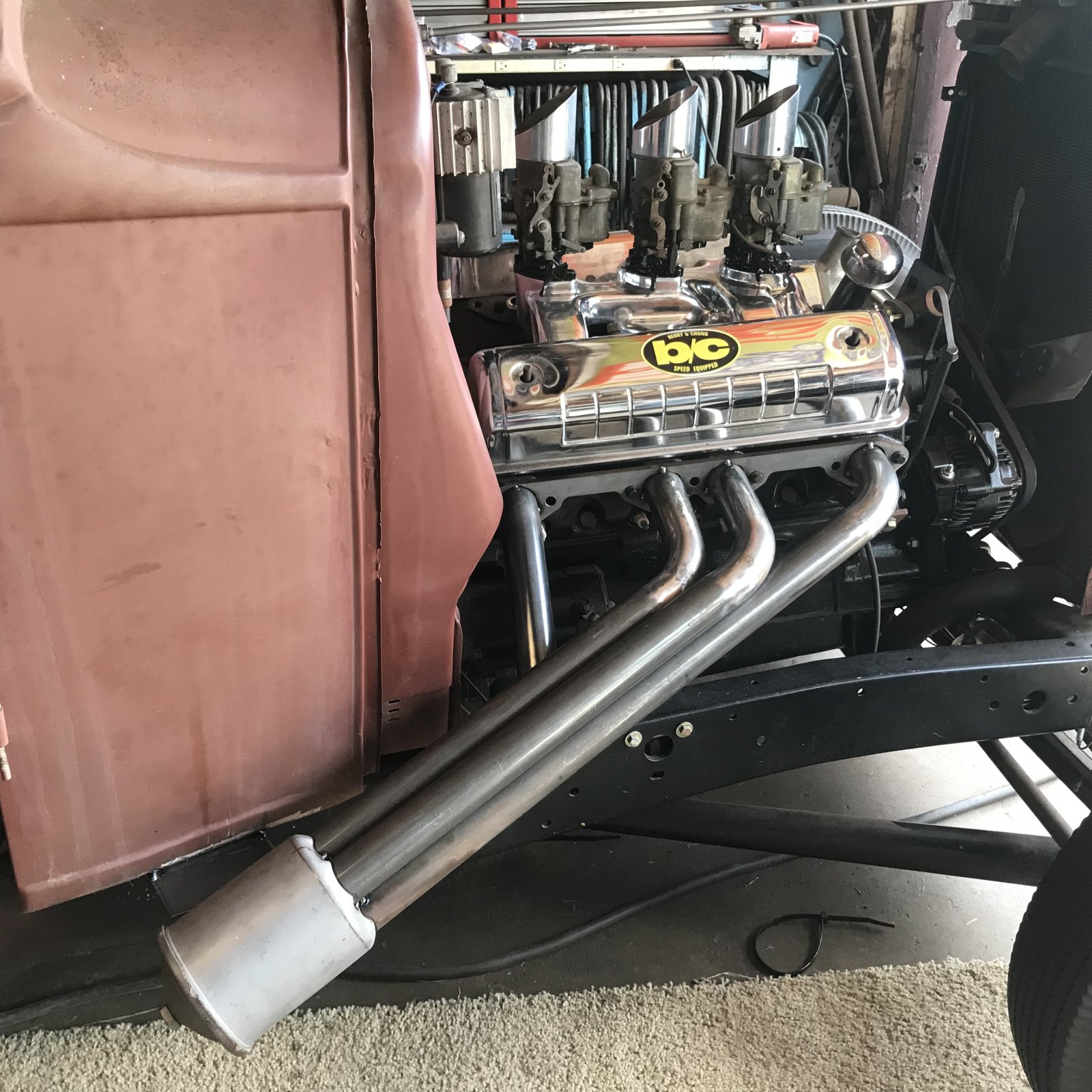

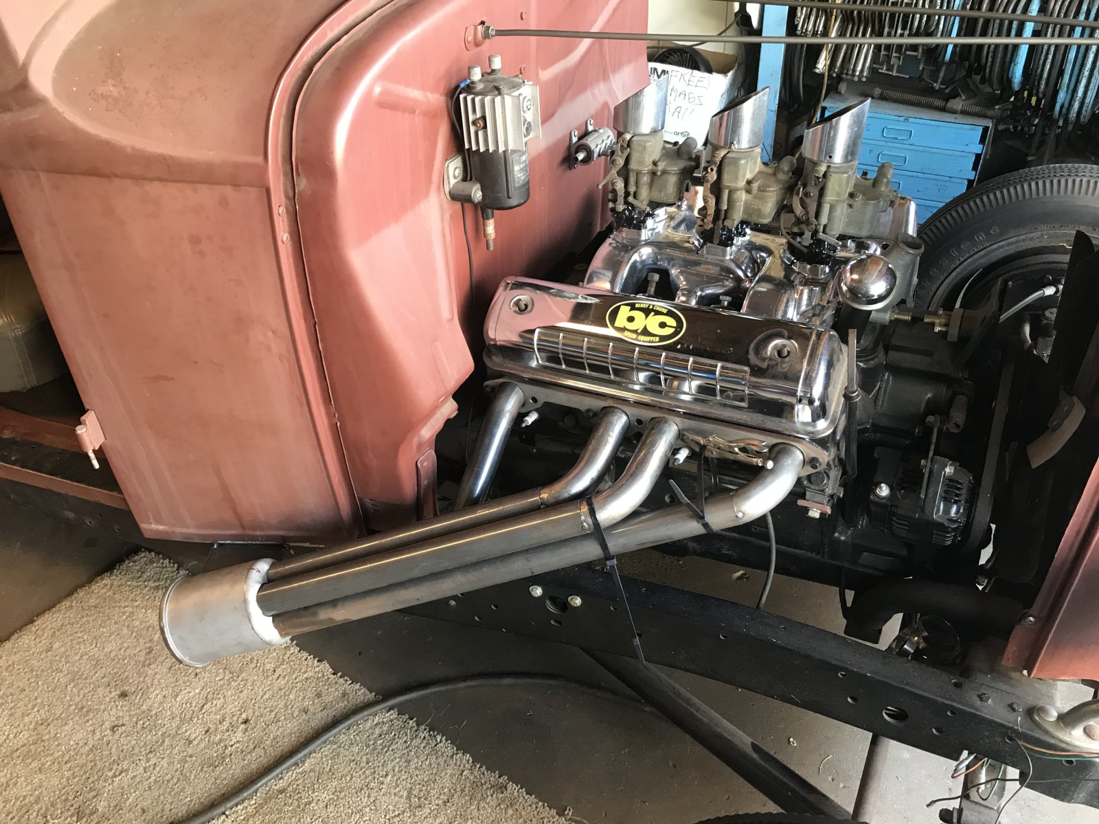

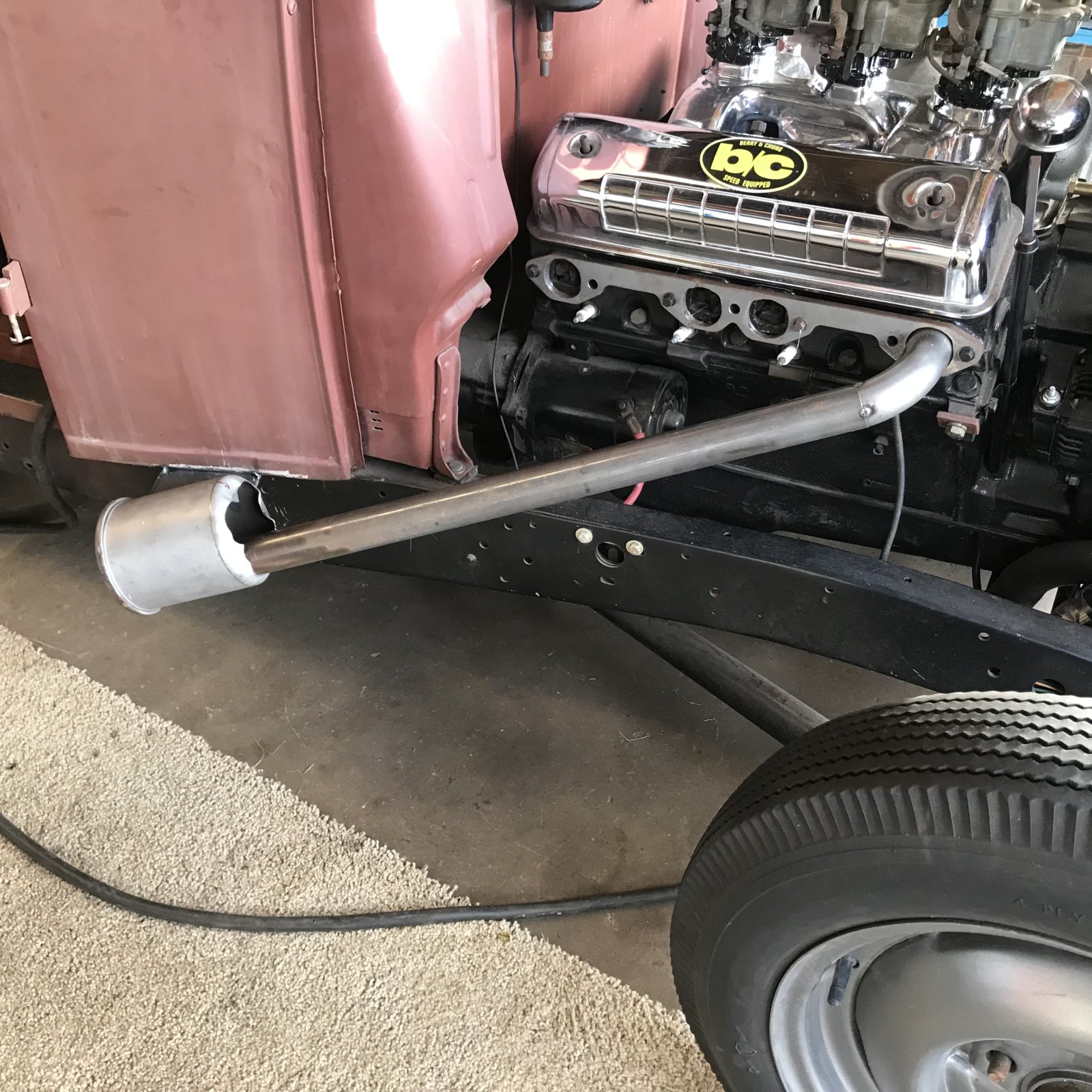

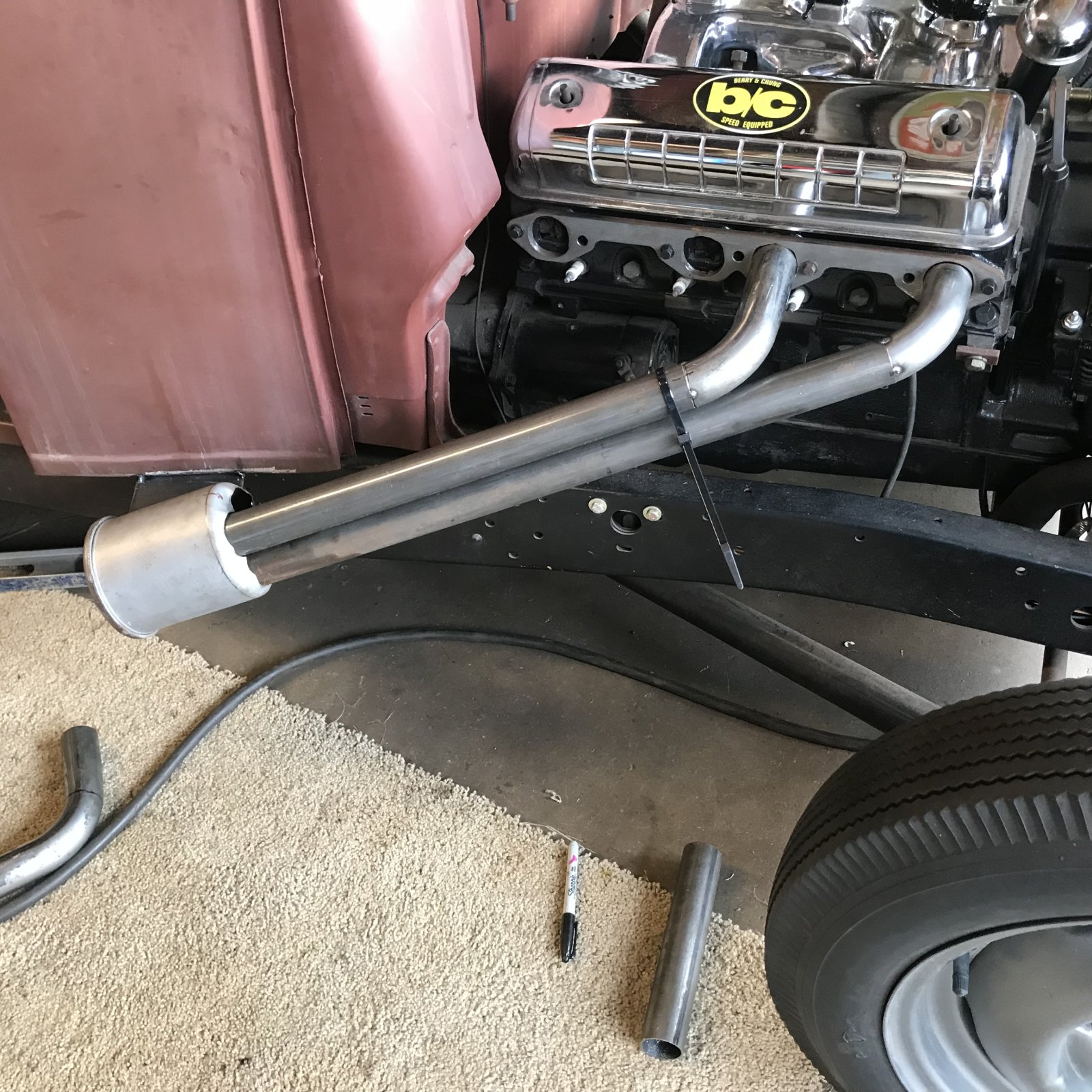

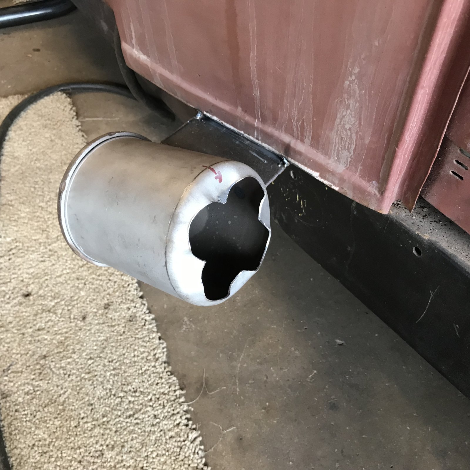

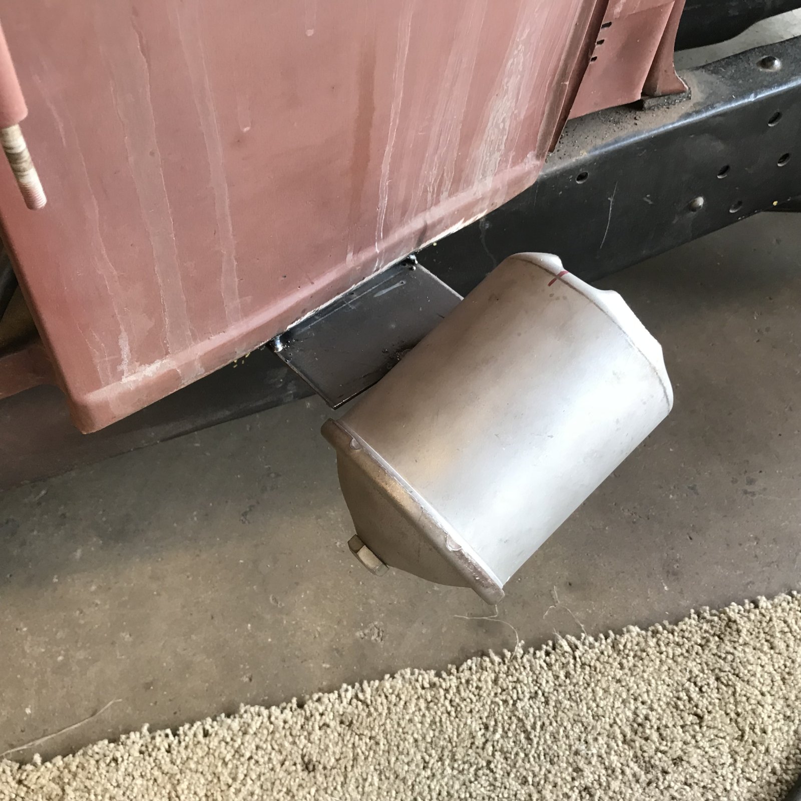

  20. Next came headers. I wanted oil filter canister collectors like some of the hot rods I remember from my childhood. I found a pair of canisters, cleaned them up and cut out the bottom to fit 4 tubes. I located them right beside the frame rail because I planned to cut hole in the frame rail and run the exhaust straight out the side of the collector, through the frame and out the back. Since the cowl was getting patch panels at the bottom later I didn’t worry about tack welding a plate to locate both collectors in position. Then I began fitting and tacking tubes. Then the individual tubes were fully welded and sanded smooth, then put back in place. Everything got ***embled and tacked together. Headers were removed and welded on the bench.
    IMG_2030.jpeg IMG_2031.jpeg IMG_2032.jpeg IMG_2034.jpeg IMG_2036.jpeg IMG_2039.jpeg IMG_2046.jpeg IMG_2115.jpeg

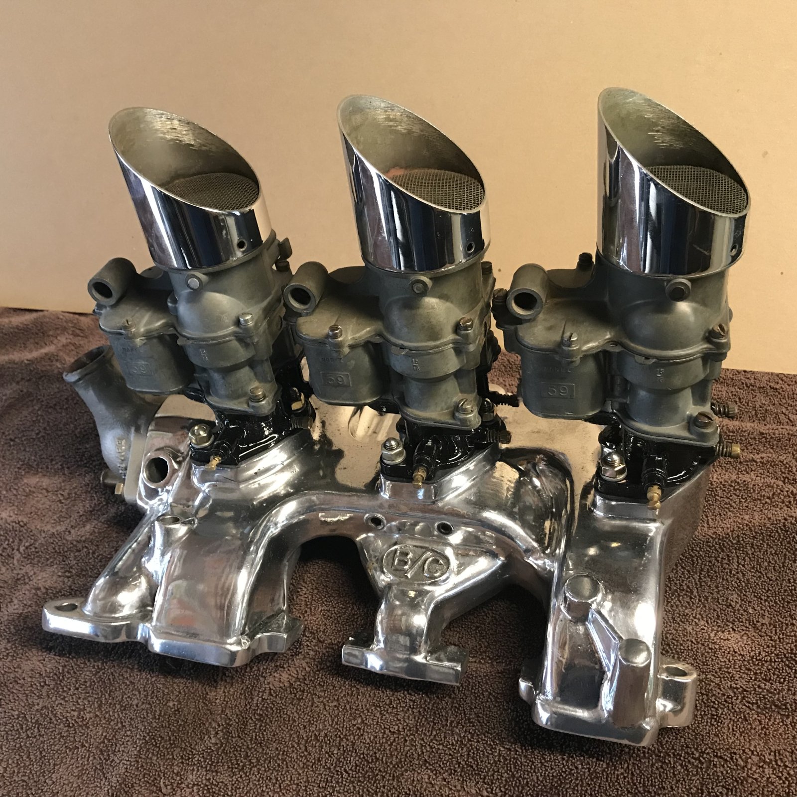

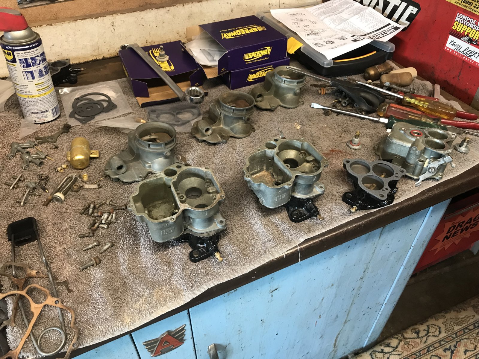

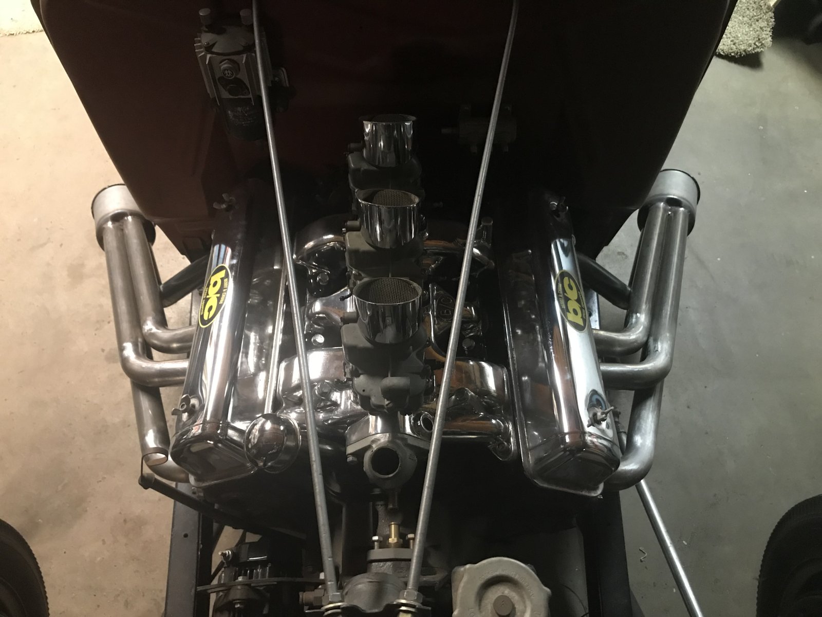

  28. I rebuilt 3 Holley 94s doing the best job I could. Sanded all mating surfaces flat, bead blasted the bases and painted them with black POR 15. This truck was never going to be garaged, just parked outside and covered with tarps to protect it from the elements. I planned from the start to paint the suspension, engine etc black and have a few chrome items. Full paint and detail was never going to happen on this truck. The Berry/Chung intake had some stains on it that bothered me so I took it get tumbled and that didn't remove them so the shop polished it for a good price. I wasn’t planning on a polished intake but it is probably my favorite part on the truck so I went for it.

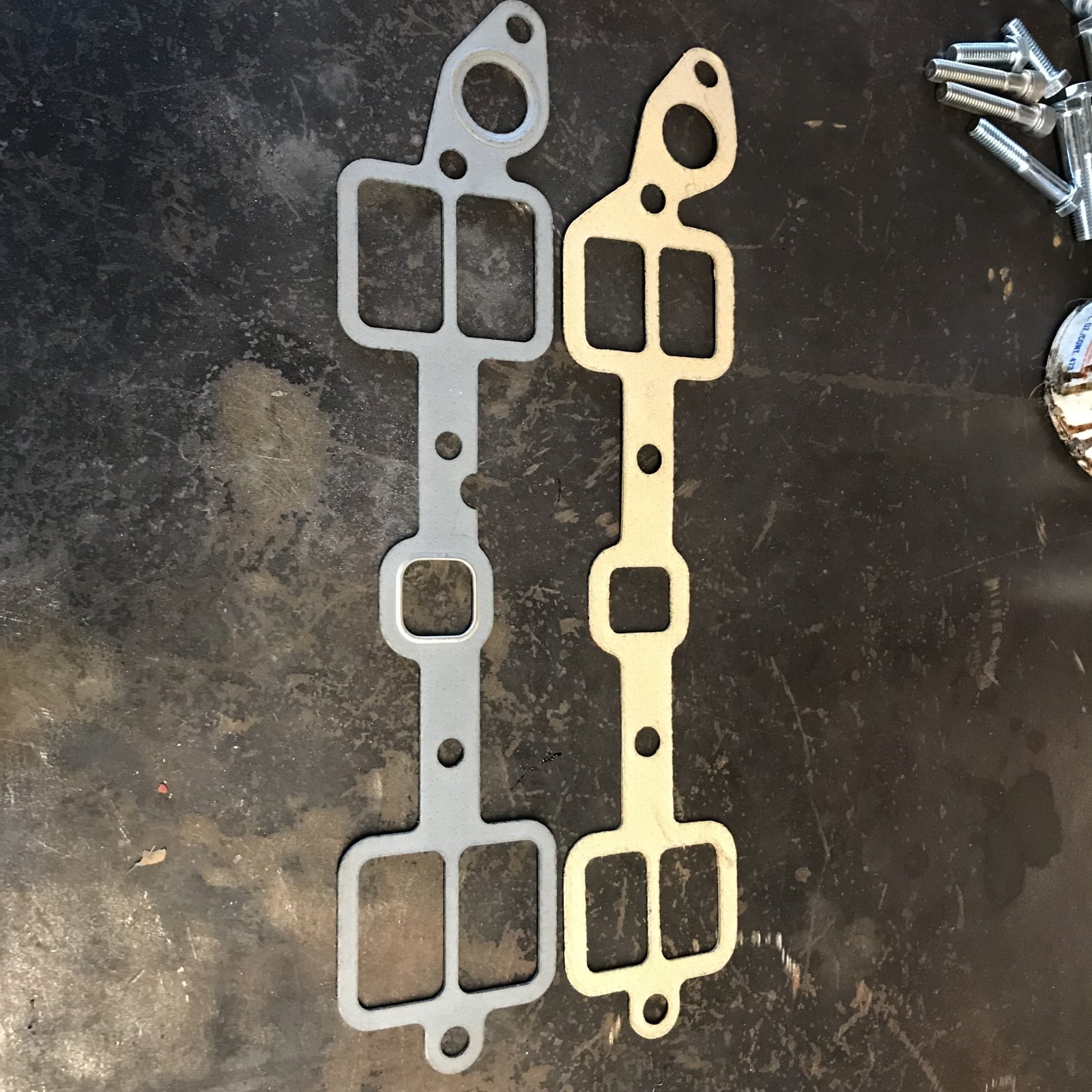

  29. I don’t pretend to know anything about Y block Ford engines but I soon found out the 239 is the dog of Y blocks. Turned out a 272 intake doesn’t bolt on to a 239. Well that was the intake and engine I had and I enjoy a challenge so I decided to follow the advice of a wise man I know and “press on”. I bought intake gaskets for both and you can easily see the port size and location differences. When you overlapped the gaskets there were gaps here and there so I made a 18g steel shim to go between them. This thing was never going to flow like a race engine but I figured as long as it ****ed in some mixture and ran good enough to drive around town I would be happy. A few holes needed m***aging with a rat tail file and I bolted it in place. As long as it ran like a stock 239 I would be satisfied.
