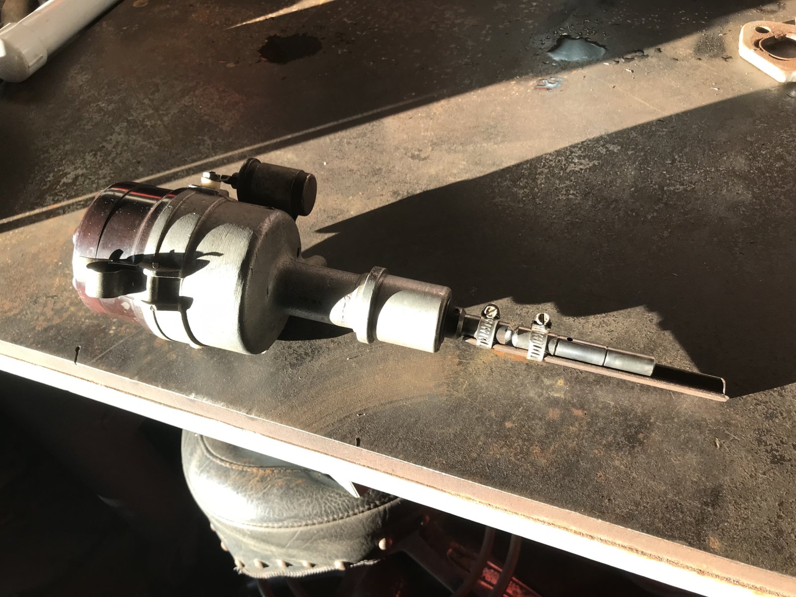

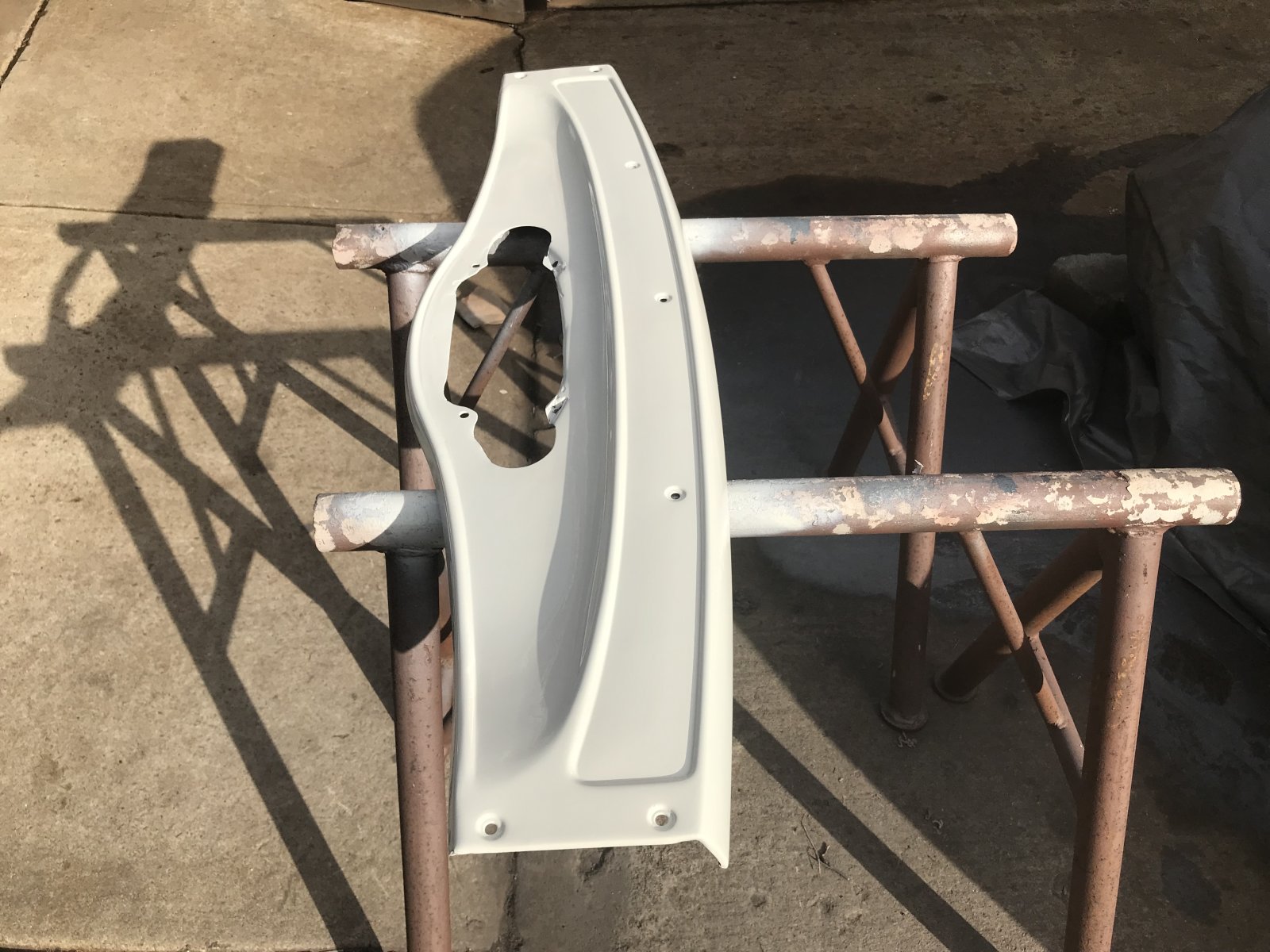

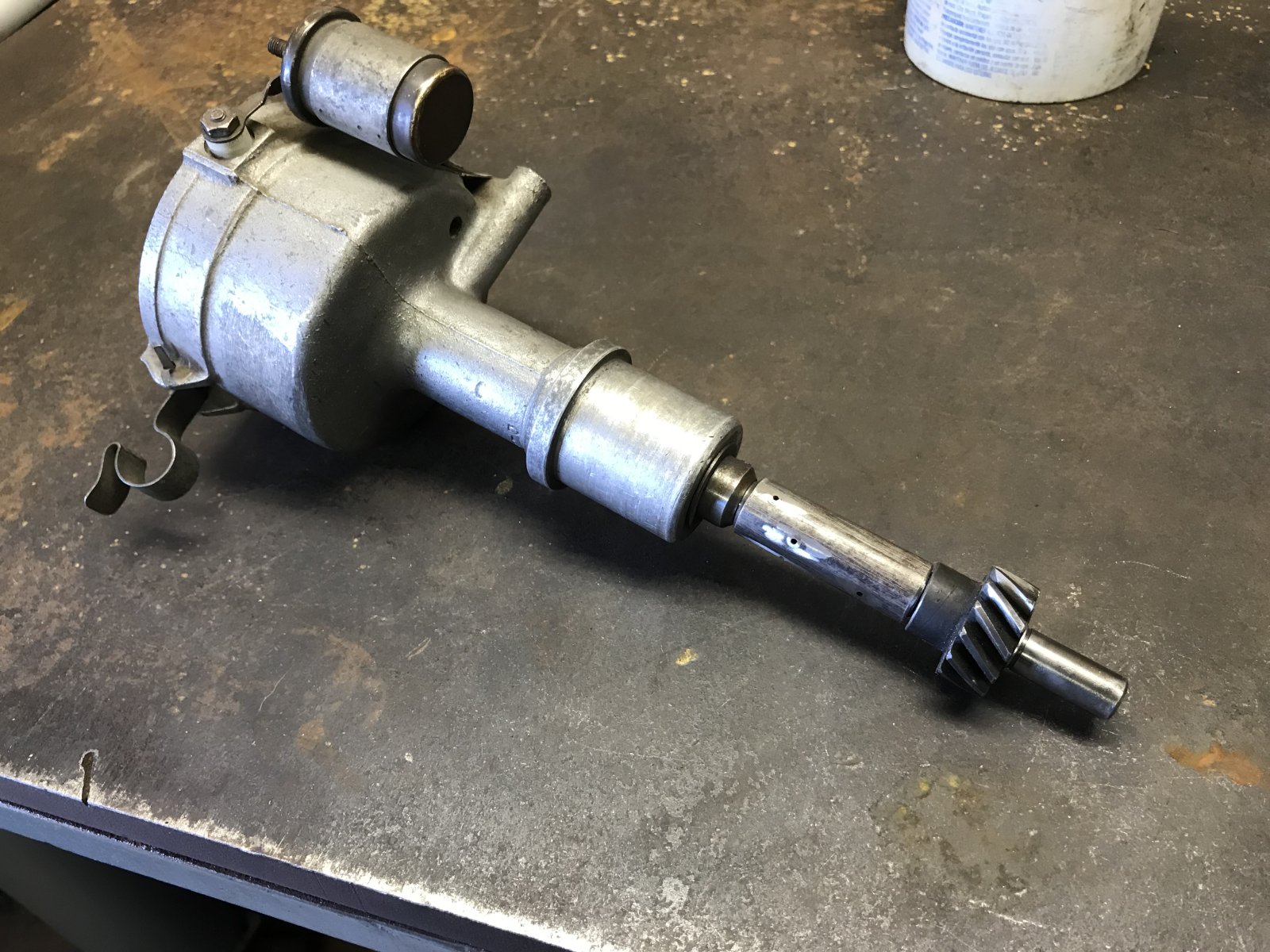

  4. I had been told that the early Y Block distributors were problematic. Not long after that I was walking the Turlock swap meet and spotted an unidentified early Mallory for $20 that looked familiar but I wasn’t sure. I took the gamble and when I got home discovered the application was small block Ford. Well the part that went in the block worked fine, the shaft was just too short and the gear was wrong. So cheap *** me cut some shaft off the original distributor, welded, sleeved and pinned it in place and then installed the Y block gear in the right place. Works great.
    Got lucky and friend hooked me up with this vintage Hildebrandt oil filter block off to relocate the filter for steering box clearance.

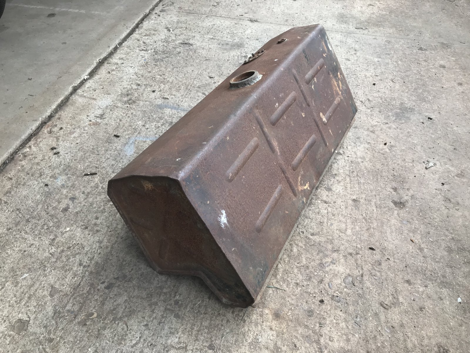

    This is the gas tank I used. I have no idea what it came out of. I’d been tripping over it for a few years. It got rotated and filler relocated, mounts added etc. like everything else not much money invested but way too much time.

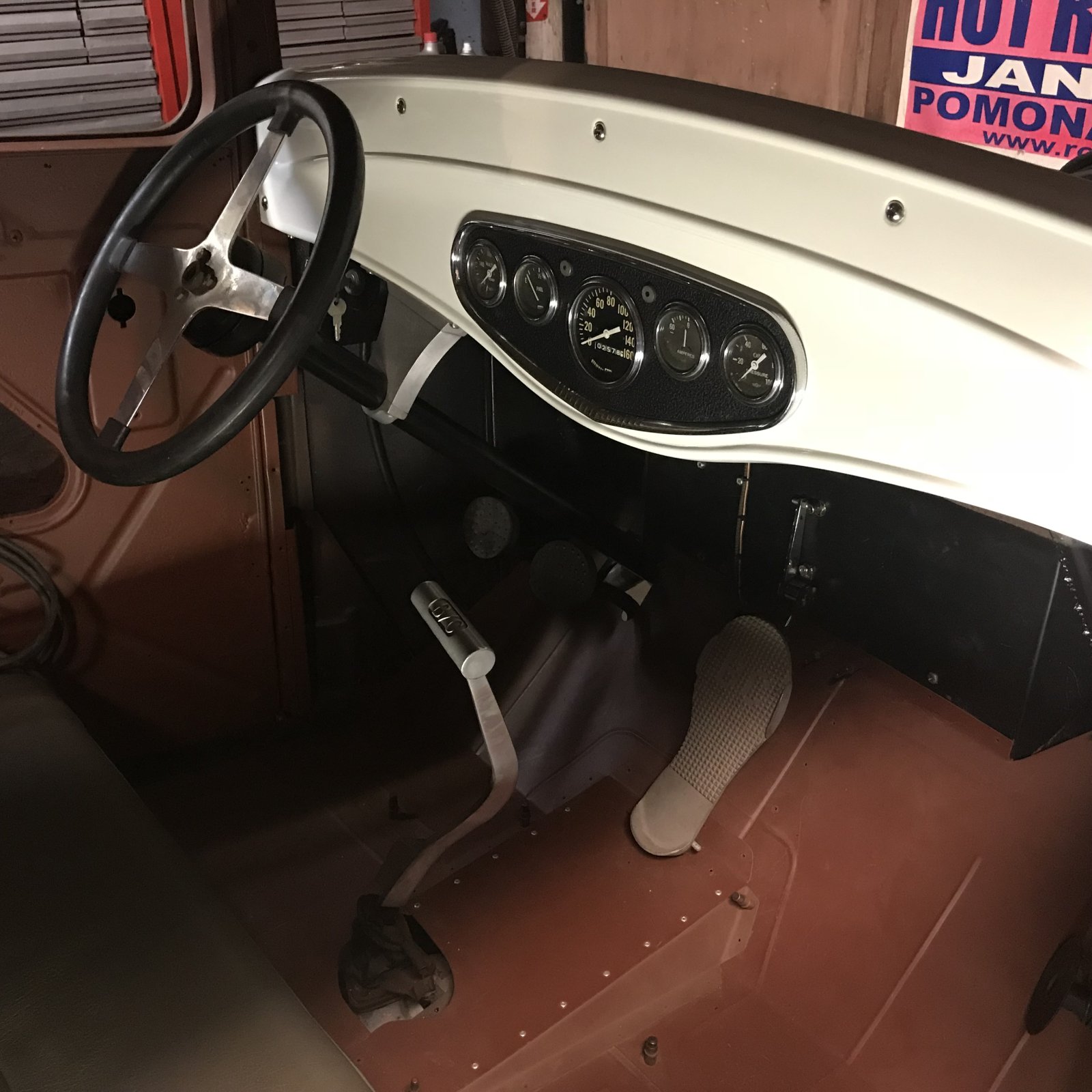

    Dash got painted Wimbledon white and installed along with a couple more Berry/Chung items.

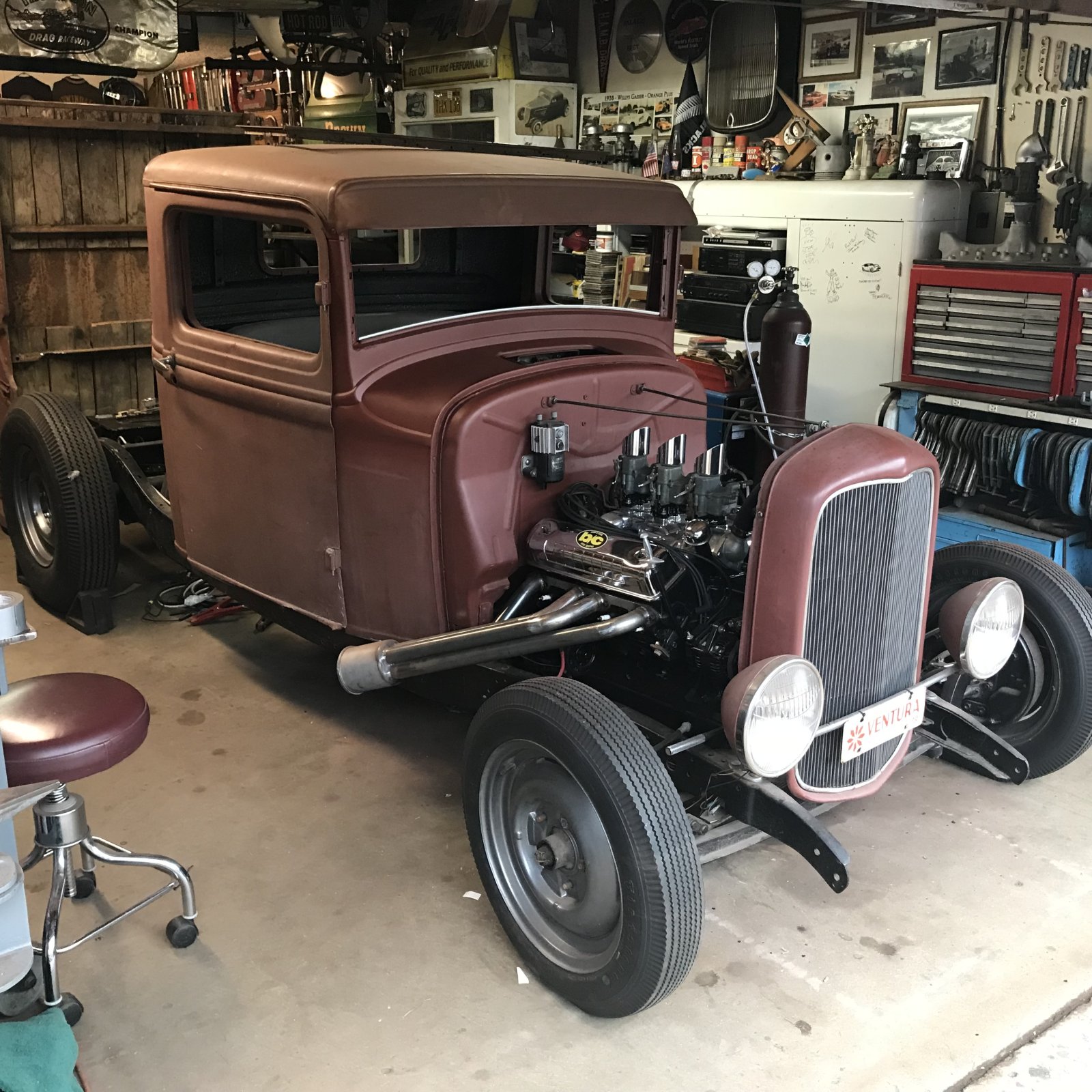

    Starting to look like something.

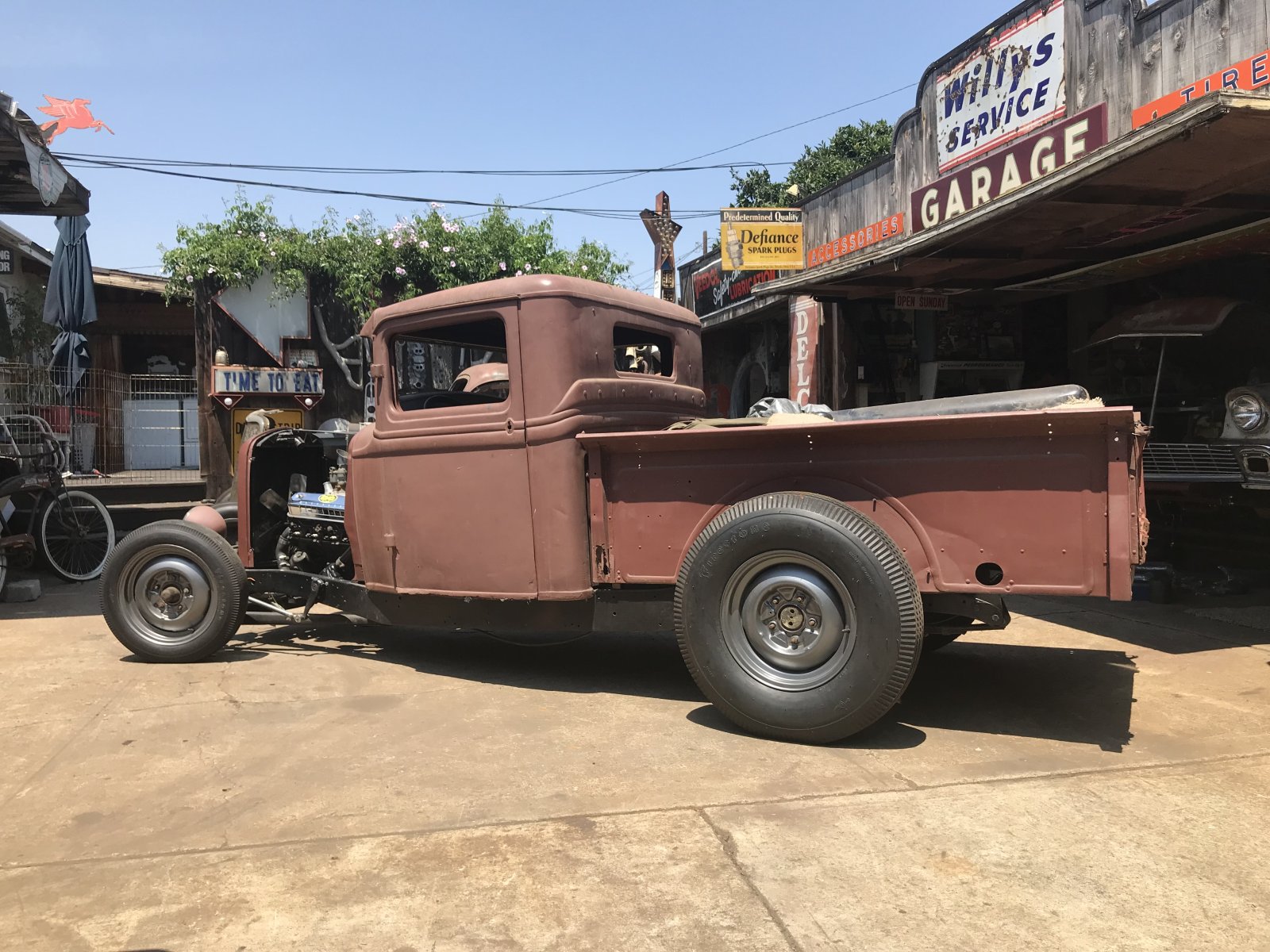

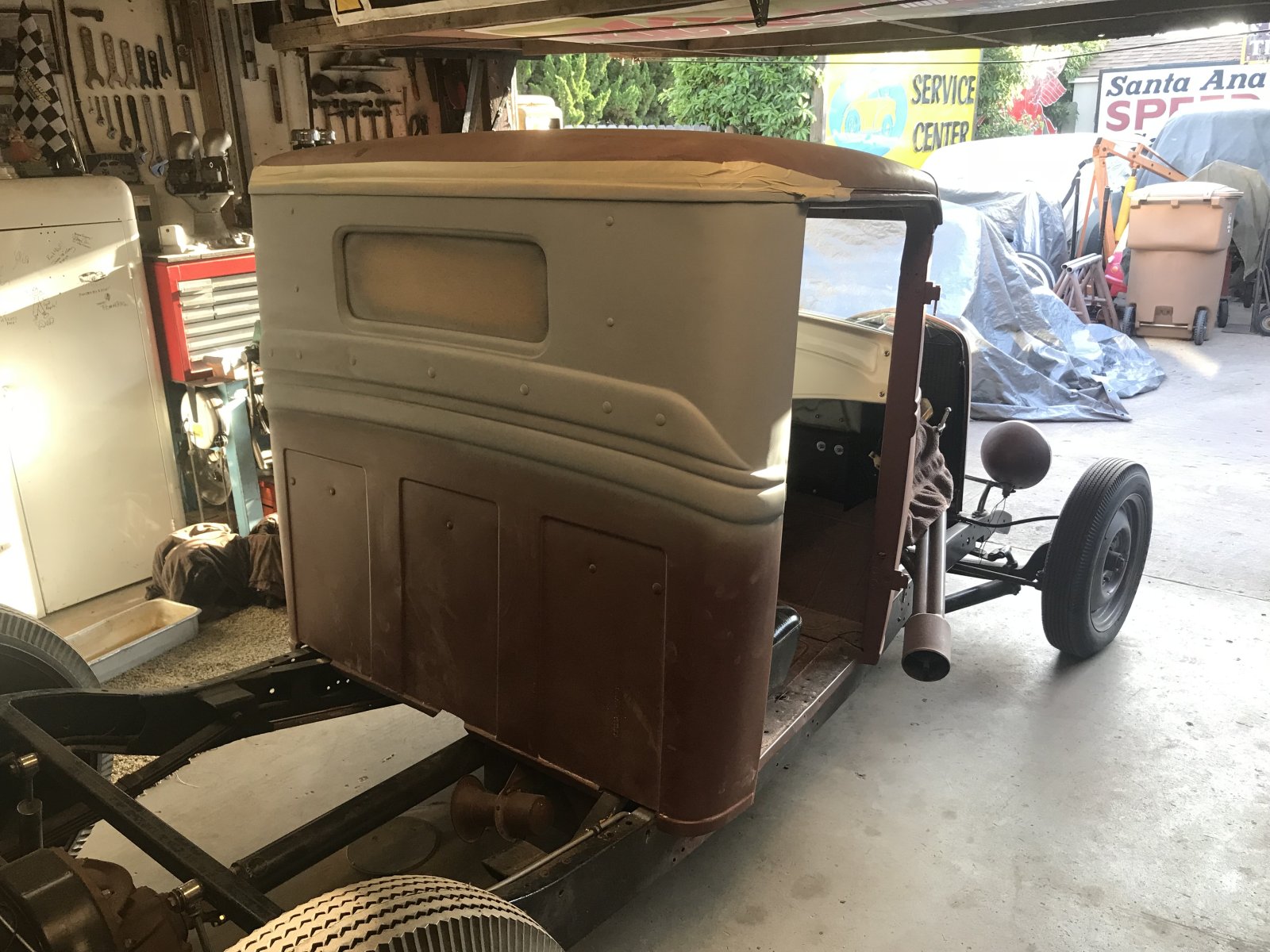

  6. The bottom of the bed was wire wheeled and painted and then the bed was bolted in place. Here you can see some of the dents that needed fixing and the condition of the bed stake pockets. I had to replace 3 of them. The bottom of the doors needed replacing and the cowl needed lower patch panels.
    Bodywork began, one panel at a time followed by my favorite, Rustoleum rusty metal primer. I can do bodywork good enough to make something look clean in primer but the time and money involved in a real paint job is off putting to me, at least on this truck.
    Had the headers bead blasted then VHT primer and VHT header paint, following instructions.
    EVL401, LAROKE, porkshop and 17 others like this.

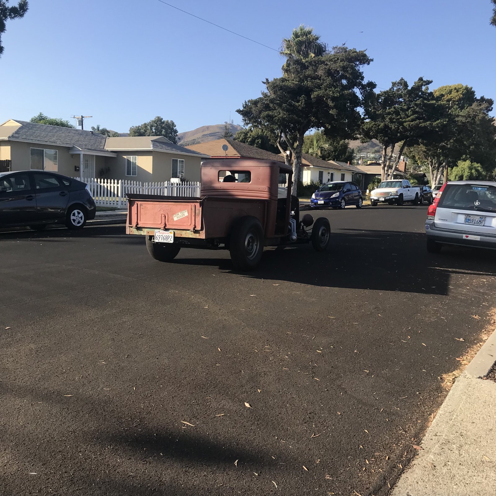

    IMG_4145.jpeg With some wiring and help from my friend Perry we got the engine fired up and now it was time for a test drive. After all the hours spent getting this far I didn’t want it to get impounded on my first drive so off I went to the DMV. In California there are no weight fees for trucks pre 1936 but even with the page in my hand from their own manual they just couldn’t figure it out so if I wanted ***le, plates etc I had to weigh the truck. So I flat towed it to the scales and back to the DMV. Later that day I was ready for the first drive. It happened with no doors because I paid a friend to strip the paint off them for me.
    IMG_3565.jpeg IMG_3568.jpeg IMG_3764.jpeg IMG_3767.jpeg IMG_3770.jpeg IMG_3776.jpeg
  8. Test drive went well. Carbs and linkage needed dialing in. I continued with the bodywork and eventually I was done. Was happy to get my plates. Installed my SCROUNGERS club plaque (NZ) and a pair of repo A taillights. Tailgate is a 36 bought at a swap meet years ago for $10. It was far from straight but I worked on it until it was acceptable.
    Finally my vision for this truck was coming into focus.
    EVL401, 34 5W Paul, OFT and 31 others like this.

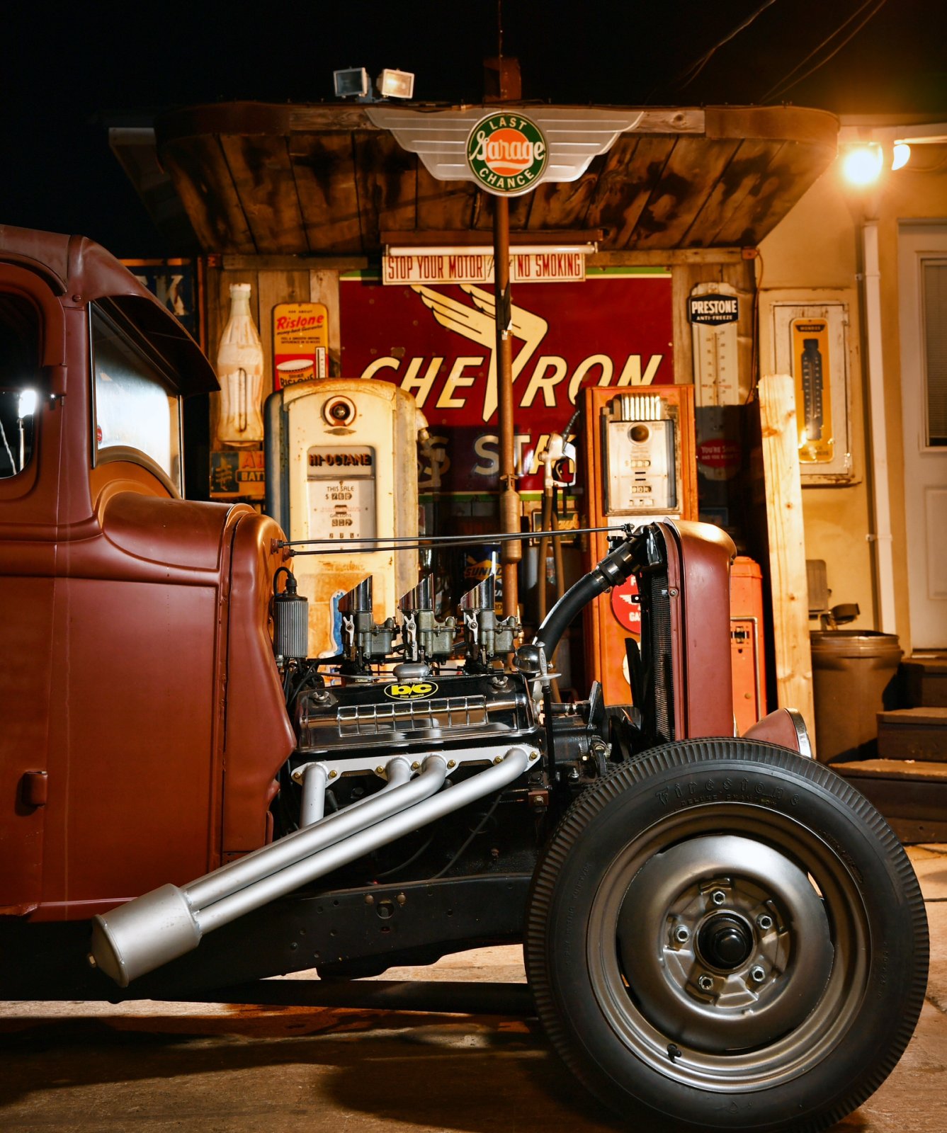

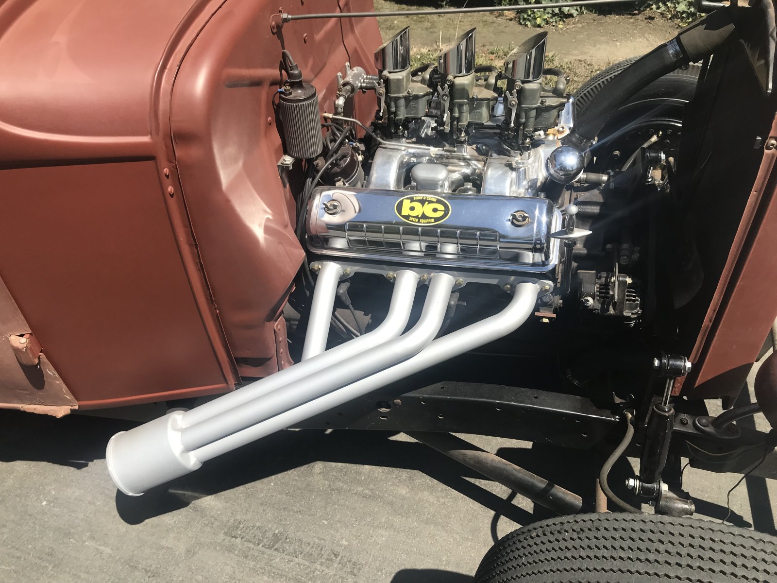

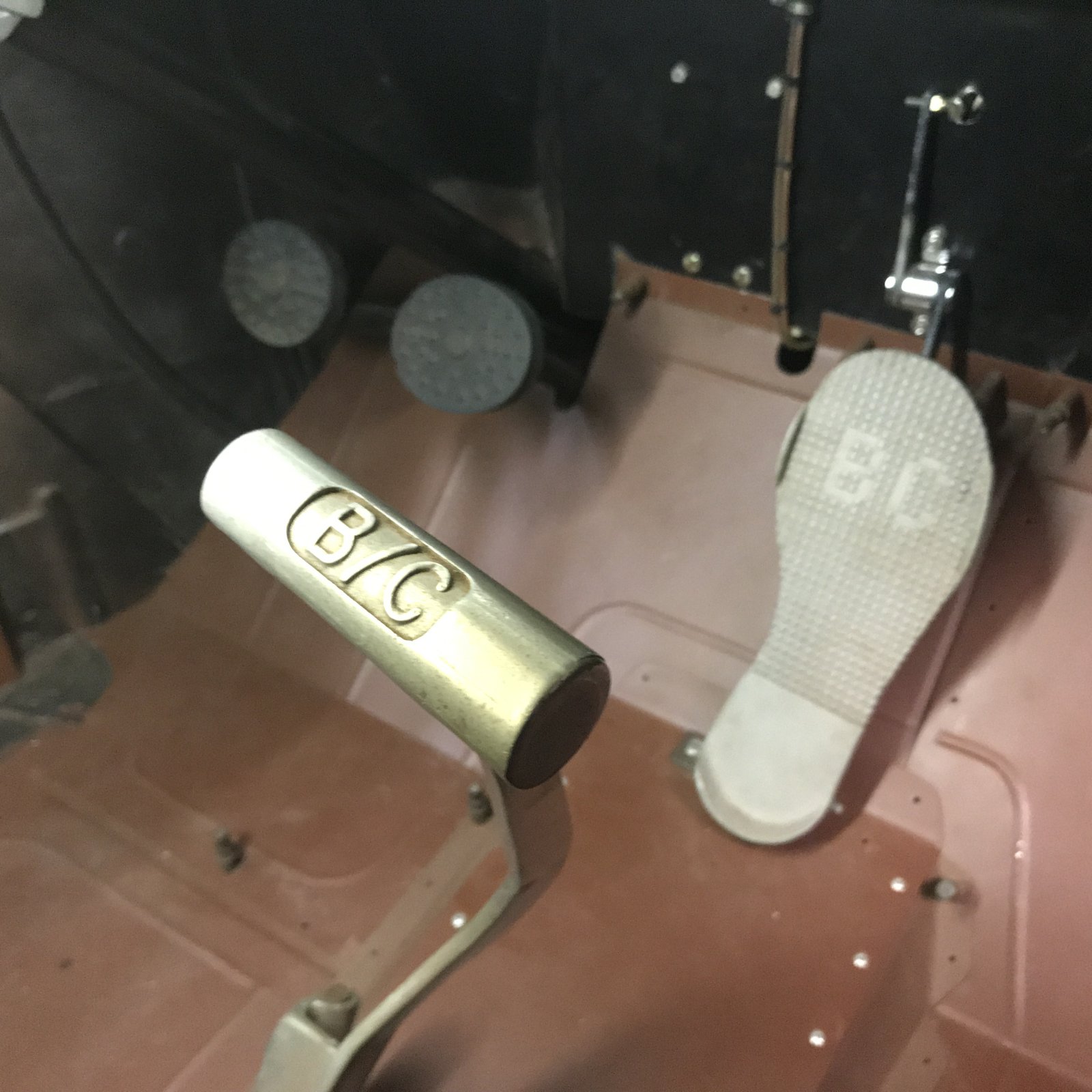

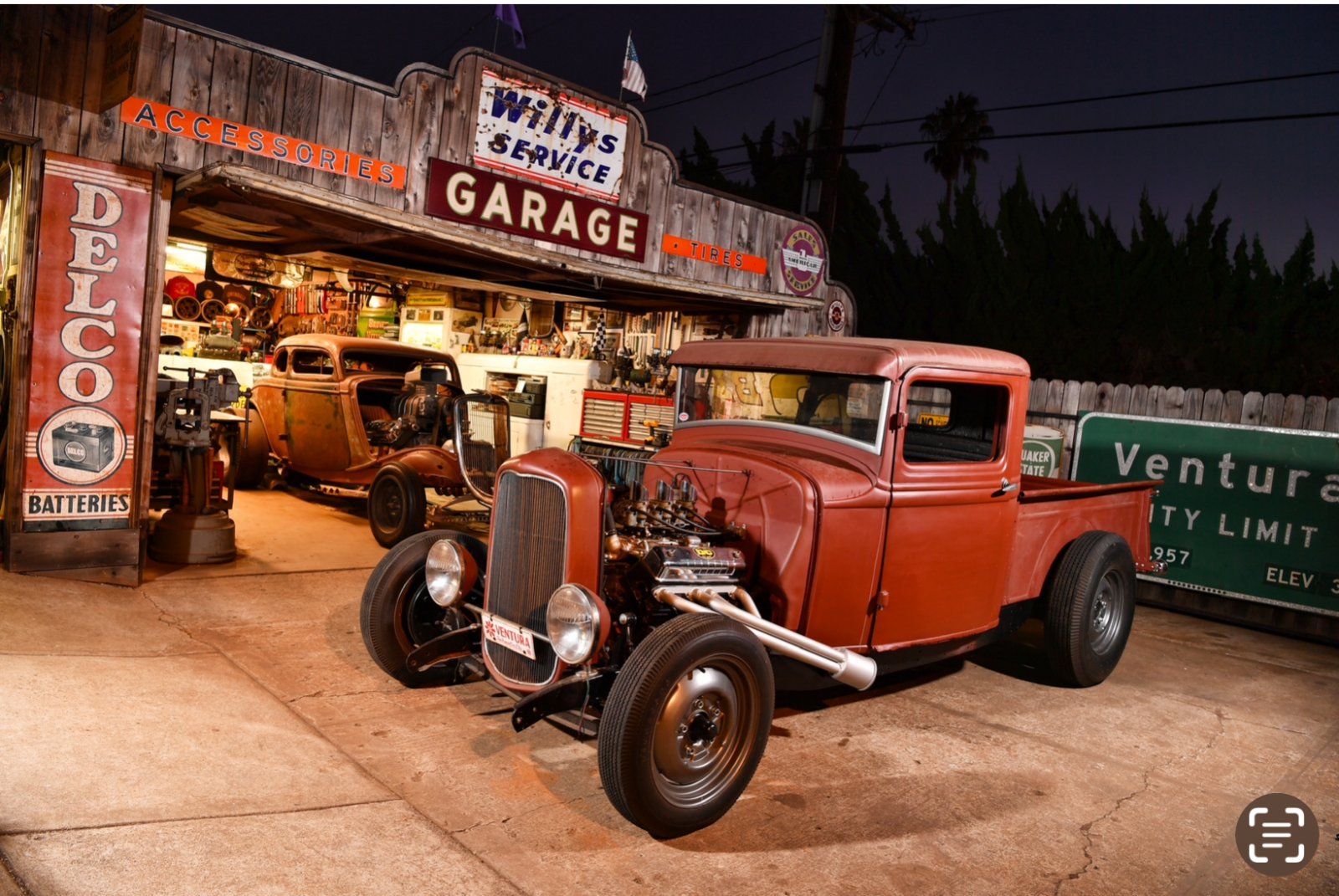

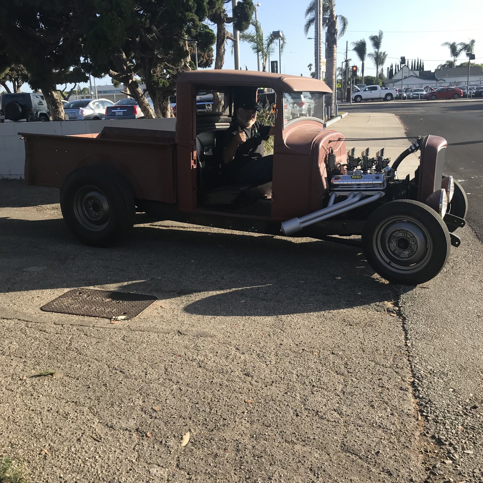

  11. Here are a couple of photos by Take Hayashi who shoots for Japanese magazines. He did a story for Daytona magazine that included some pics of the truck. In the second pic you can see the Berry/Chung dagger dip stick handle. They were very popular in NZ in the 60s and 70s. Also I had to make an adapter for the upper radiator hose to get it hooked up to the radiator. Looks like the dip stick handle was a copy of a USA one made in the 50s.

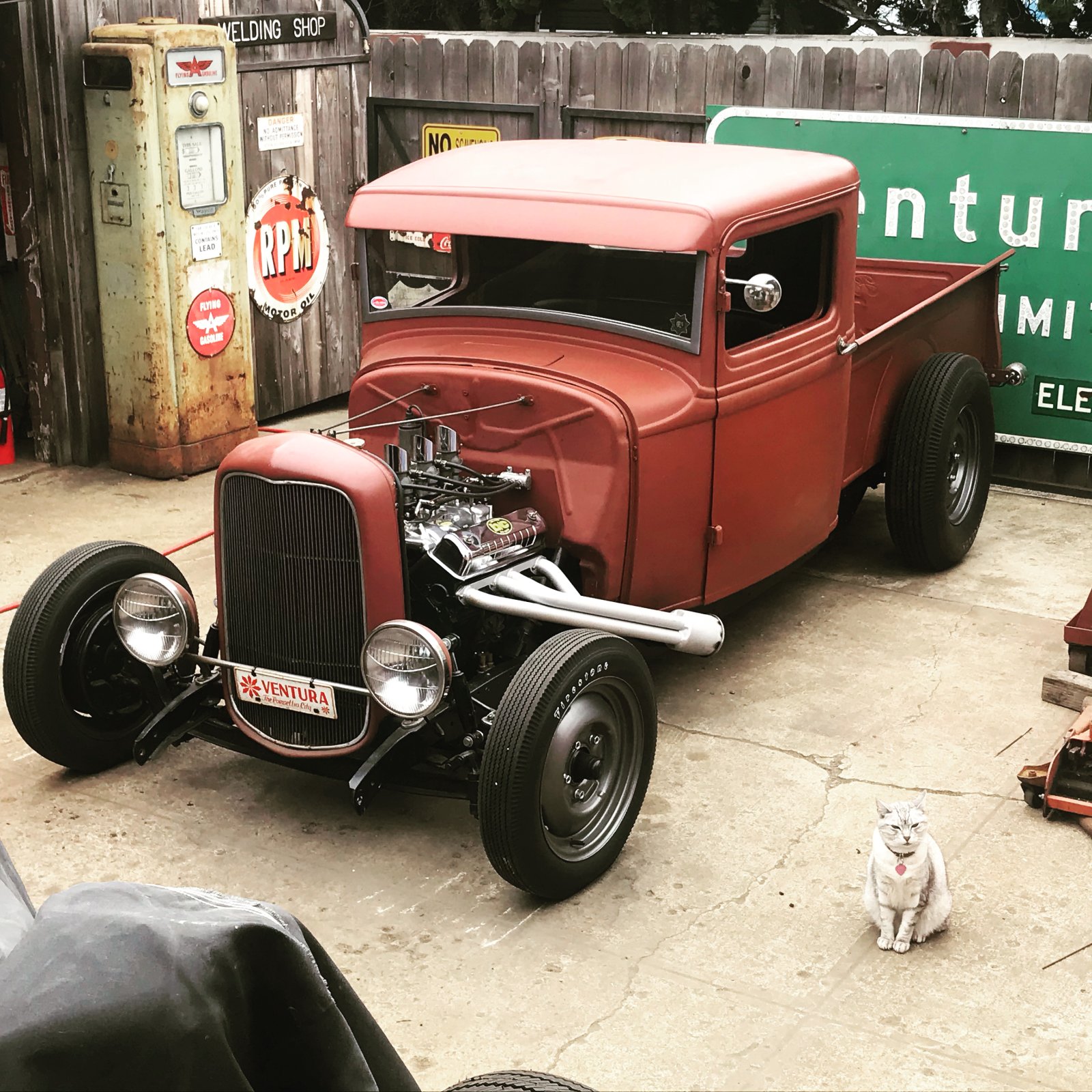

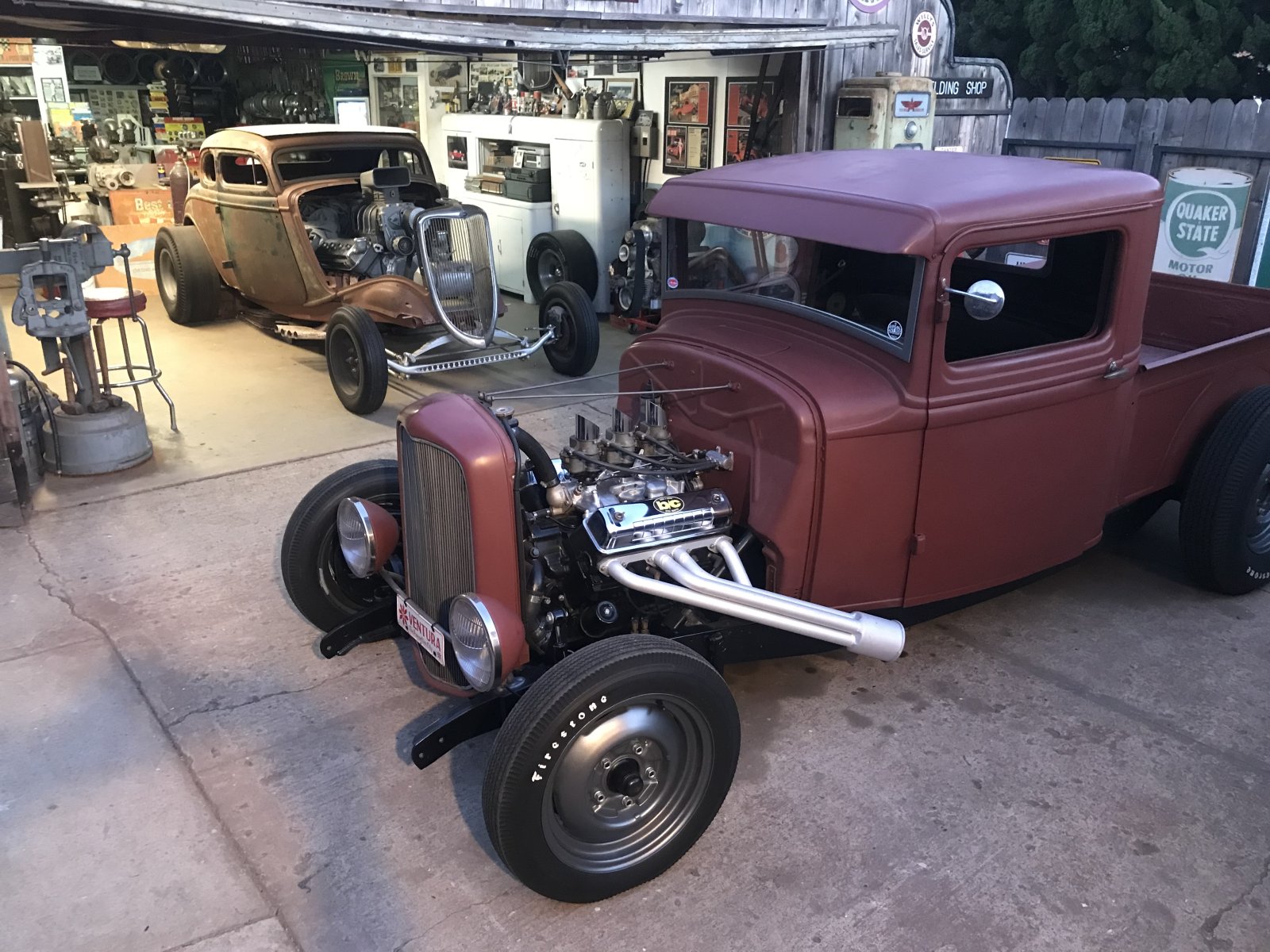

  12. A couple more pics from my back yard. In the first one you can see the trunk I mounted in the bed so I can carry some tools, fire ext’, gas can etc.

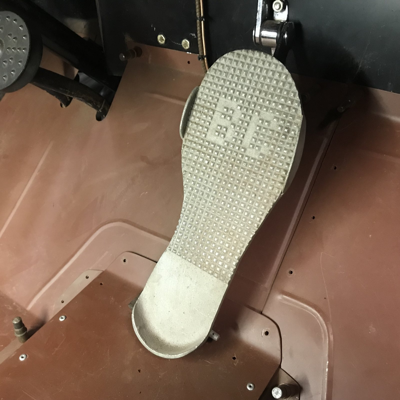

    How did you attach the gas pedal to the firewall linkage?
  22. I have made a little progress on the coupe. I have the engine mounted and a lot of floor and firewall structure fabricated. Next comes a lot of patch panels and body repair. I built the roadster to sell to help pay for a great trip Mary and I took to New Zealand last March. Before that during the covid years I rebuilt one side of my garage so that took a lot of my time. With that and the roadster project done I will have more time for the coupe. I wanted the pickup to be a driver before I focused on the coupe also. So working full time, doing side jobs and the above projects it has been hard to find time for the coupe and that is fine with me, I am in absolutely no hurry. I like having it there to look at. it will be a record breaker before it hits the road, worlds longest mock up.
    EVL401, LAROKE, porkshop and 13 others like this.
  23. TAL-GATR. Top of pedal is connected to linkage with a clevis.

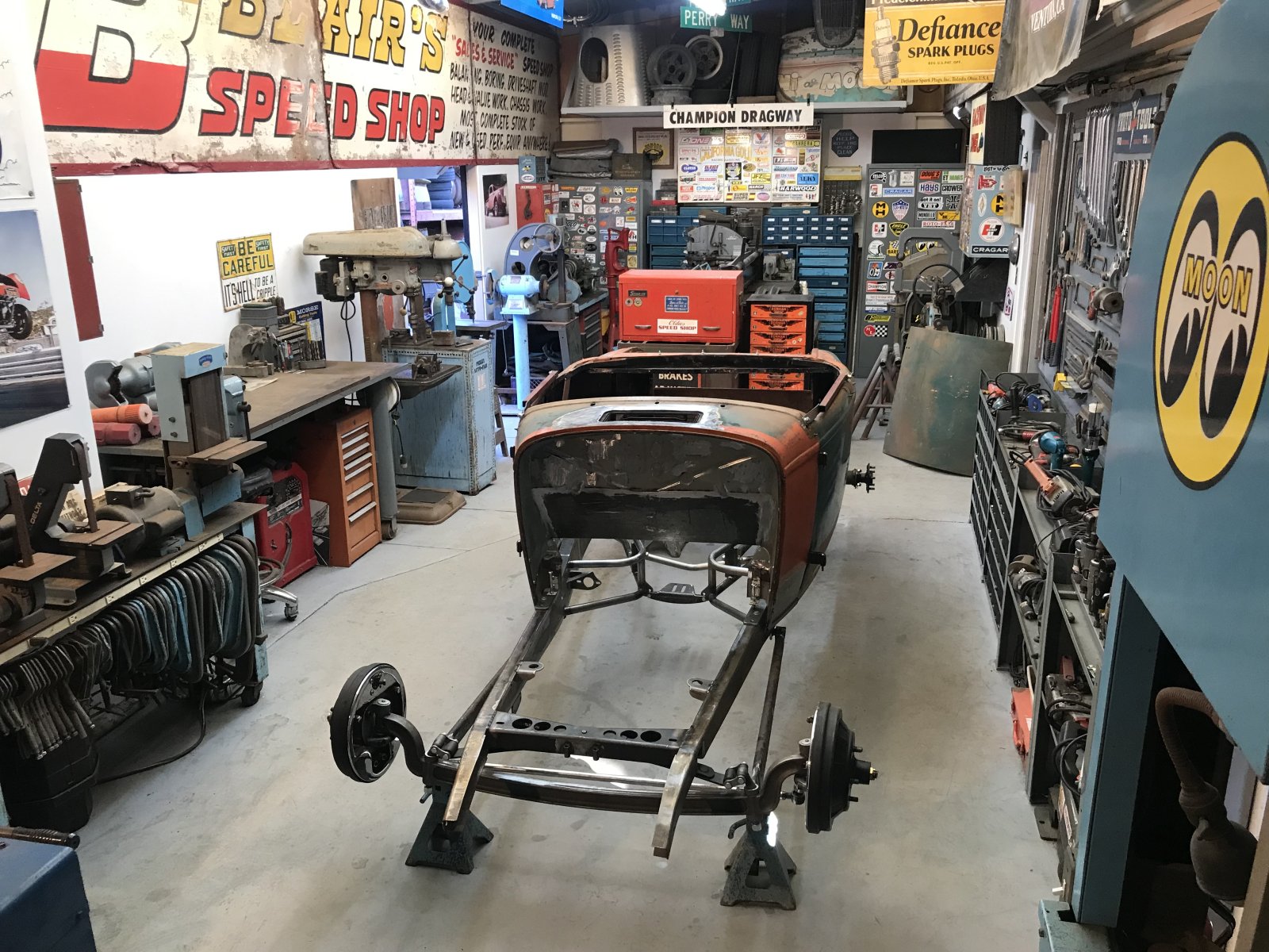

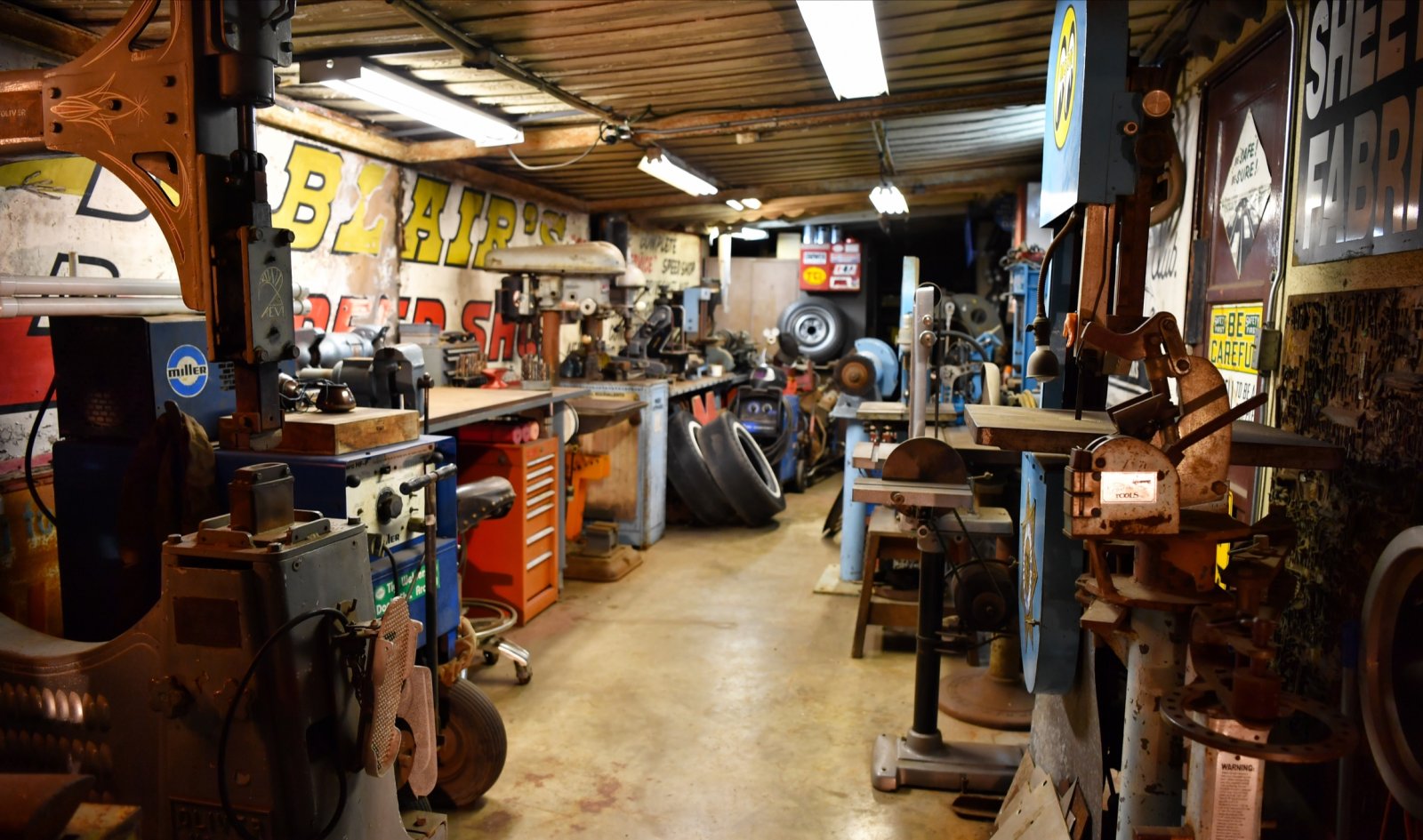

    What About some updated garage pics.
    Your garage was always one of my favorites.

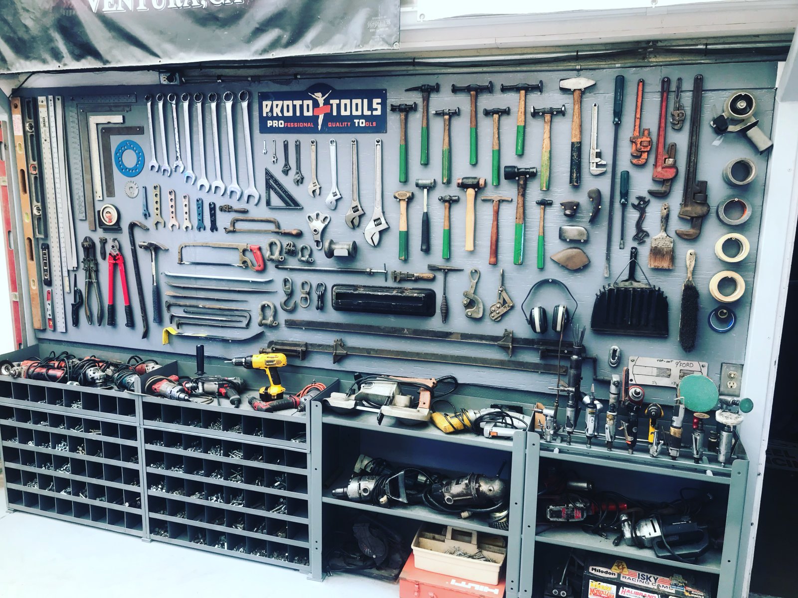

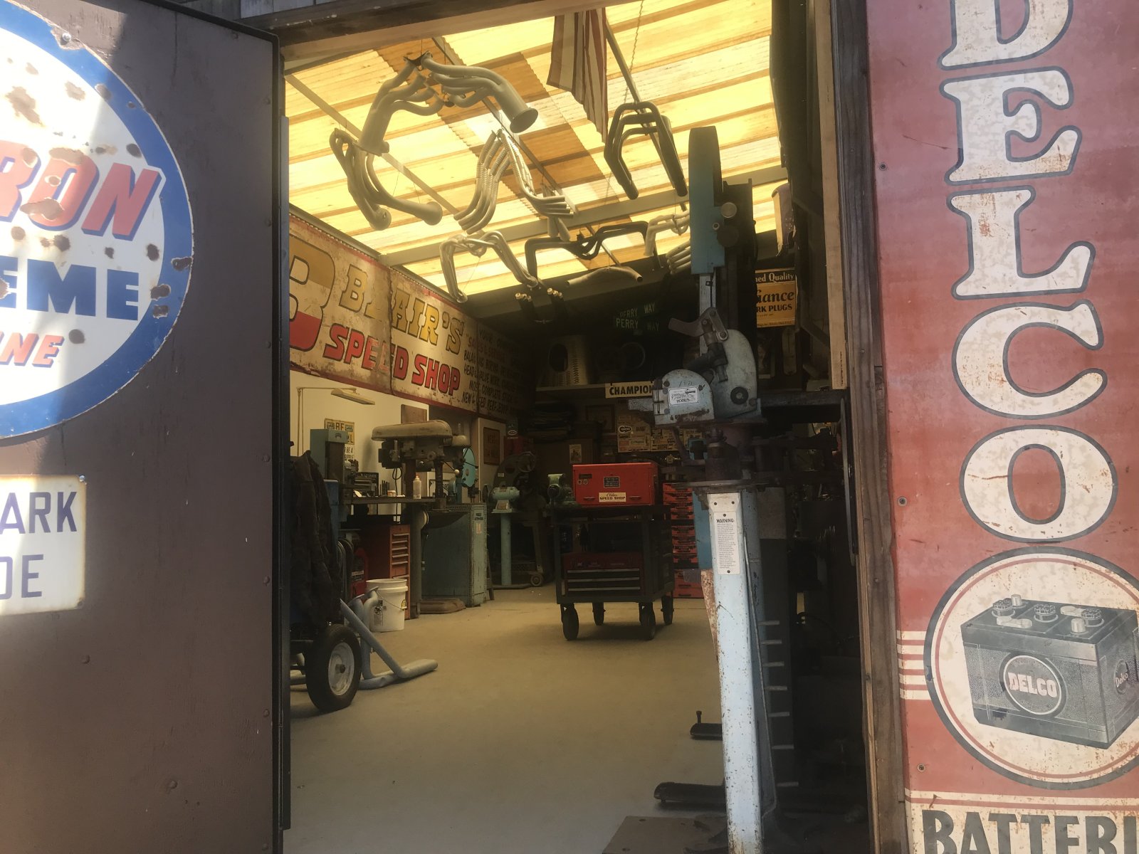

  25. Before…..
    After….
    IMG_7770.jpeg 7FA3B3CC-4455-49D2-B0B0-51C96B050F3C.jpeg IMG_7148.jpeg IMG_1316.jpeg
    EVL401, LAROKE, porkshop and 21 others like this.

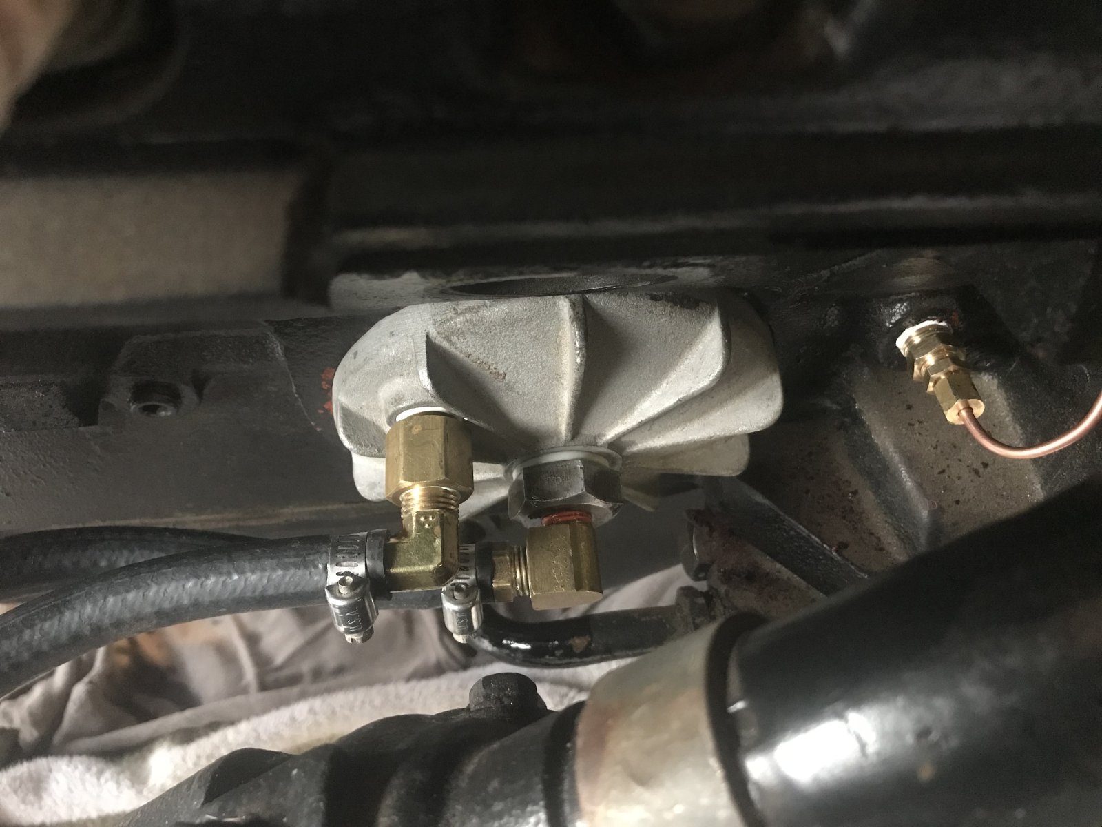

    Ok caught up! Man that turned out great. The rake, chop, headers, it all just plays so well together. Perfect man.
    any shots of your radiator hose cross over?
    enloe and Outback like this.
  28. I will take a couple of pics of the radiator cross over tomorrow.
