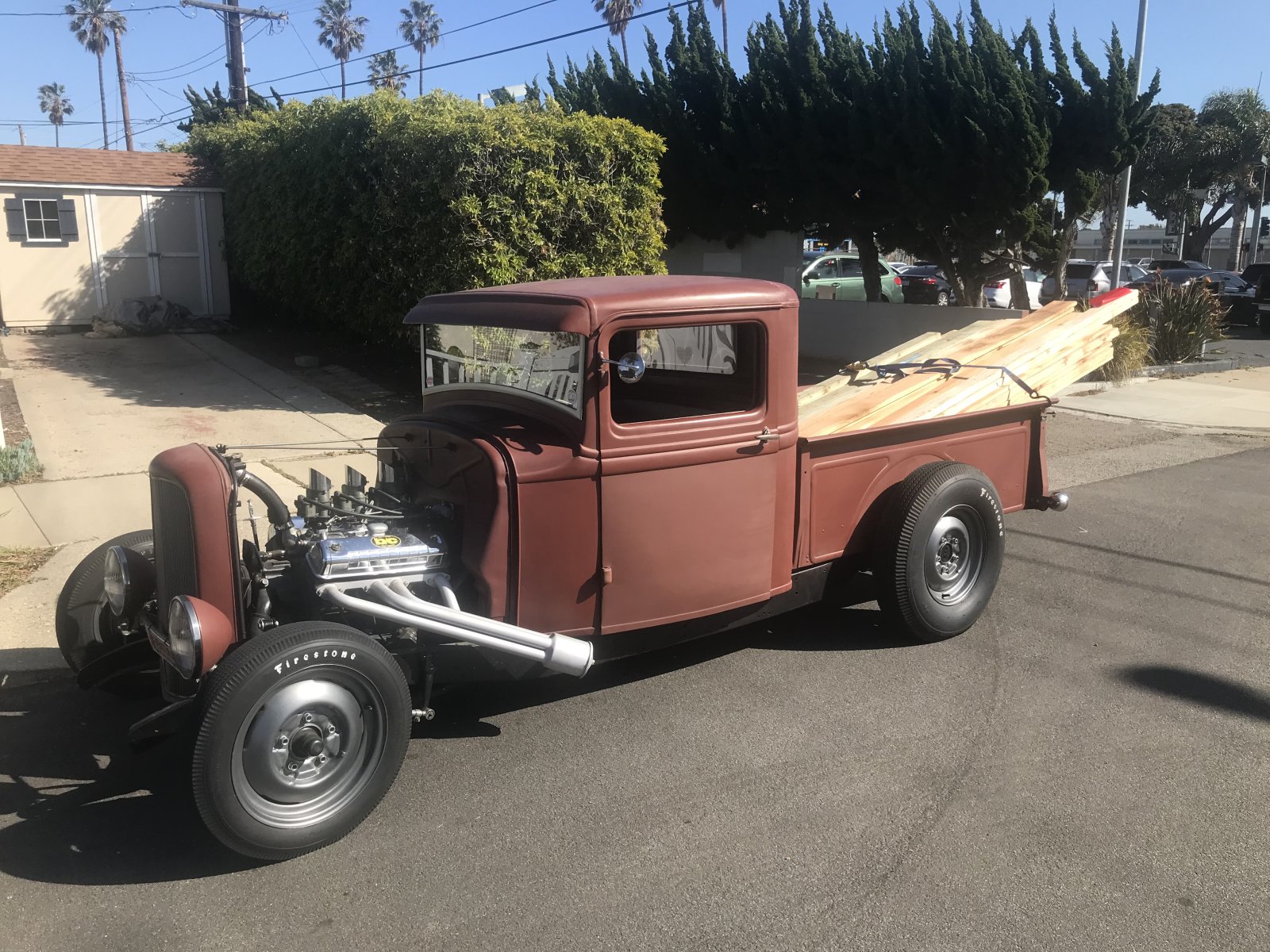

  3. I like the painted wheels look but after a couple of years got a little bored. In the shade or at night I thought it looked kind of dreary so I added beauty rings.

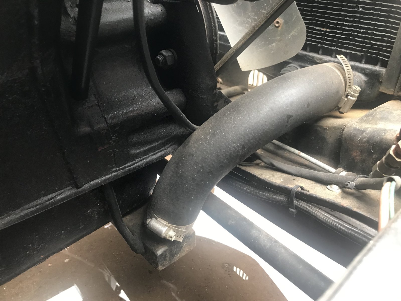

  4. A couple of pics showing the radiator cross over to connect the Y block to my $35 swap meet radiator. It is just a piece of 2”x1” rectangular tubing with a hose connection on each end and something to bolt it to a couple of oil pan bolts. I welded a pipe thread bung in the bottom so I can drain the cooling system.
    Truck has been a good work horse. I like the look of a shortened bed but it is too handy as is.

    Thanks for taking the time to take those photos I appreciate it!
