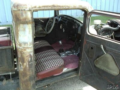

  4. I used a ford mini van 3rd seat in my 33...was chopped 5.5" so I sat it on the floor, all the way back. Had to take 3 inches out of the front of the seat bottom. 33interior.jpg
