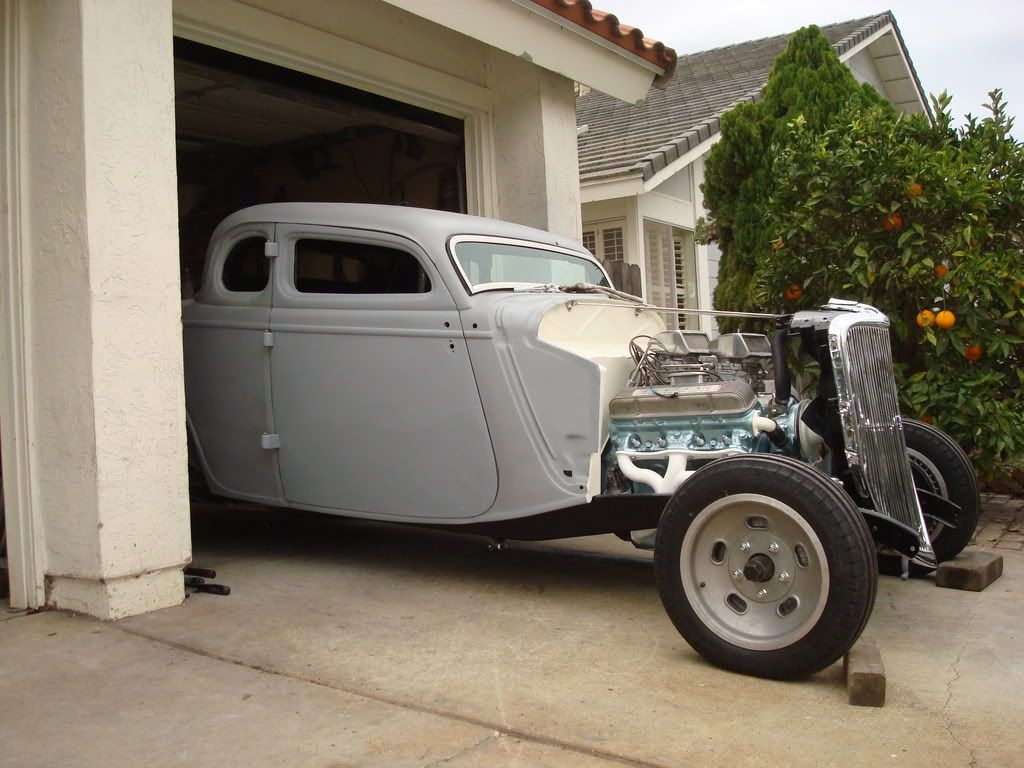

    Great lookin hot rod!!!

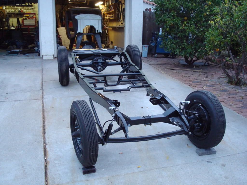

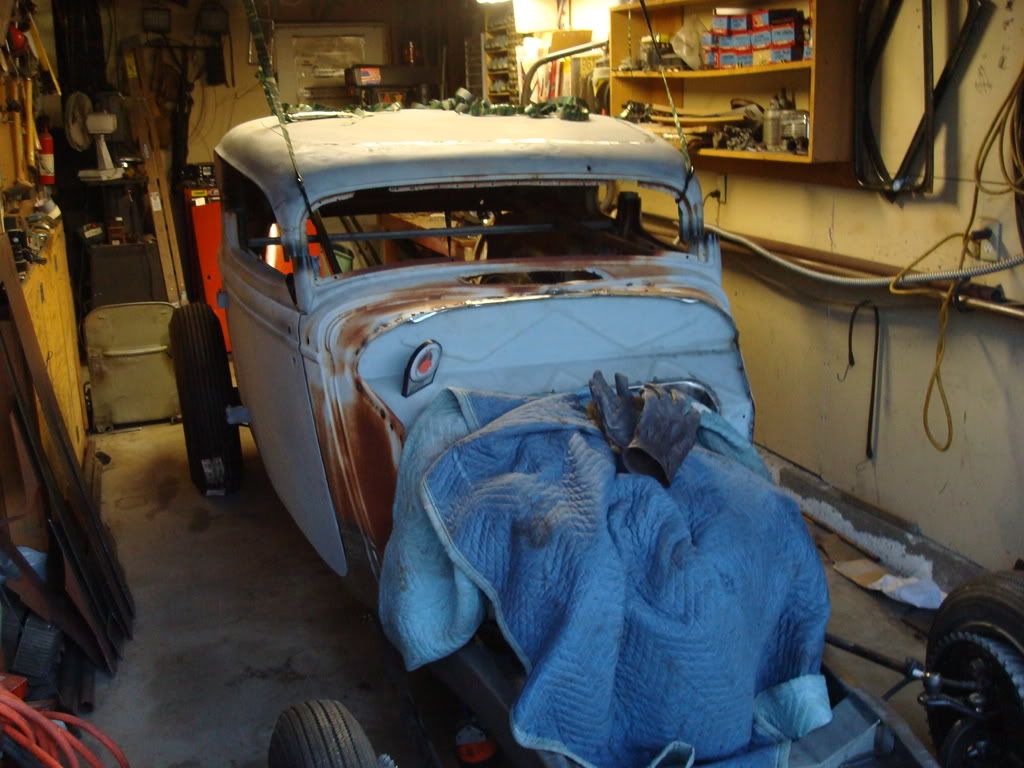

    here's some of the build pics, didn't take a ton of them so these are mostly just during the chop
    you can see the new floors in this picture

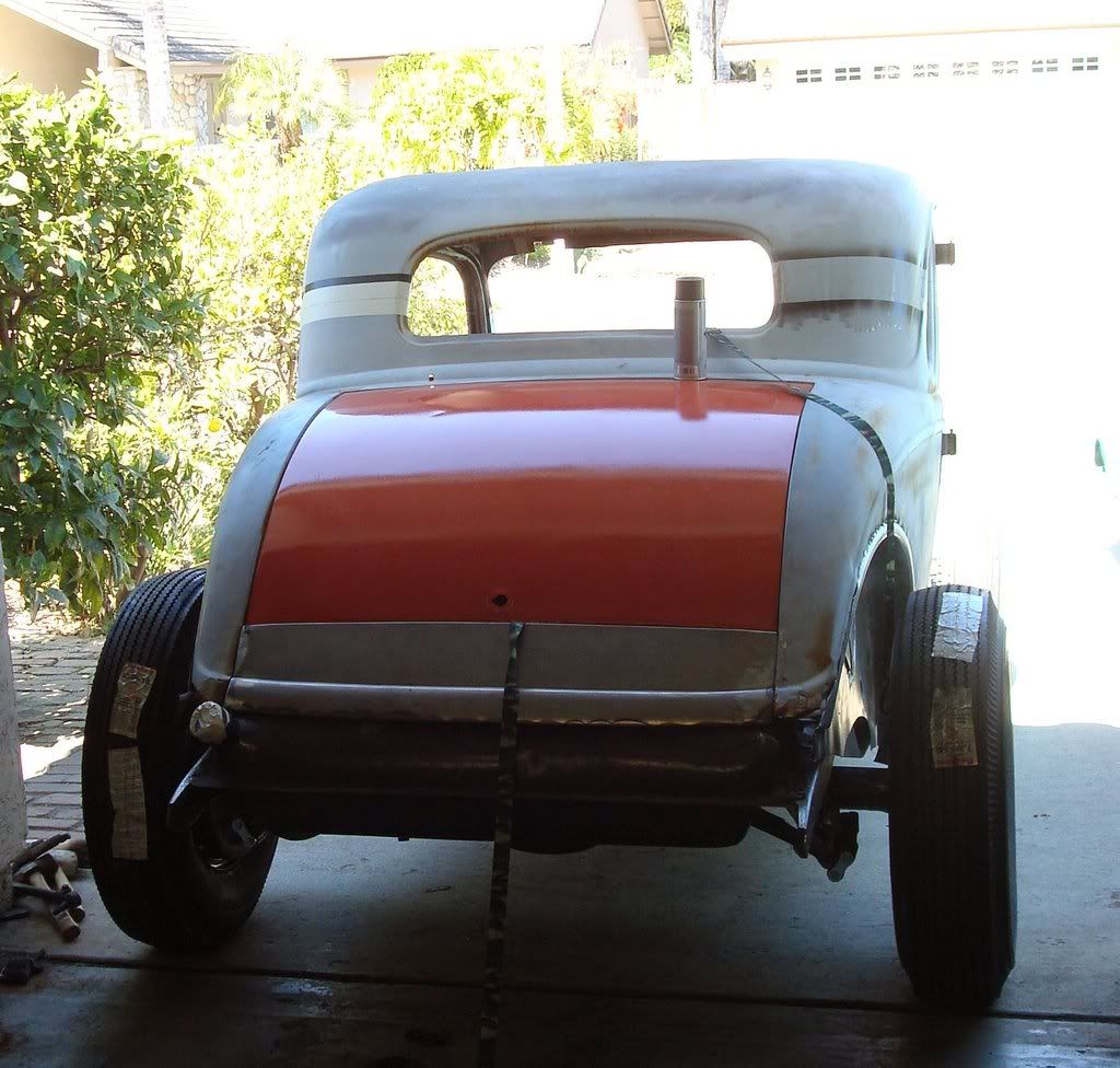

    here you can see how much shorter the roof is with the metal removed

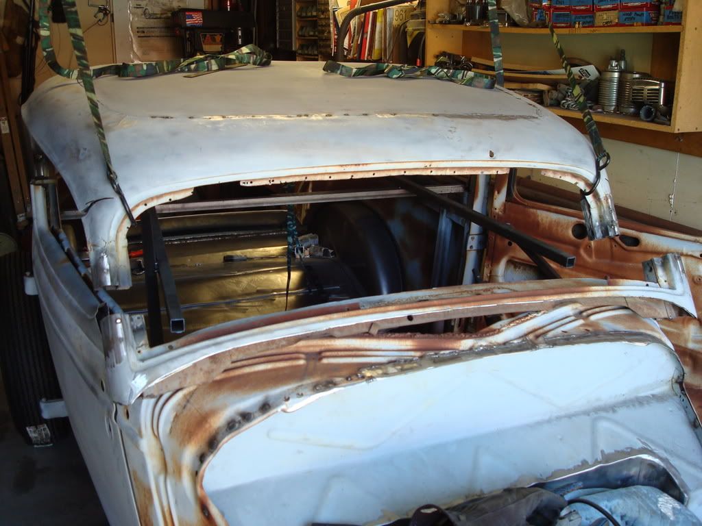

    when you work alone you have to find creative ways to hold stuff in place
    you can see how the cowls going to get cut
    cowl cut
    tacked back at an angle

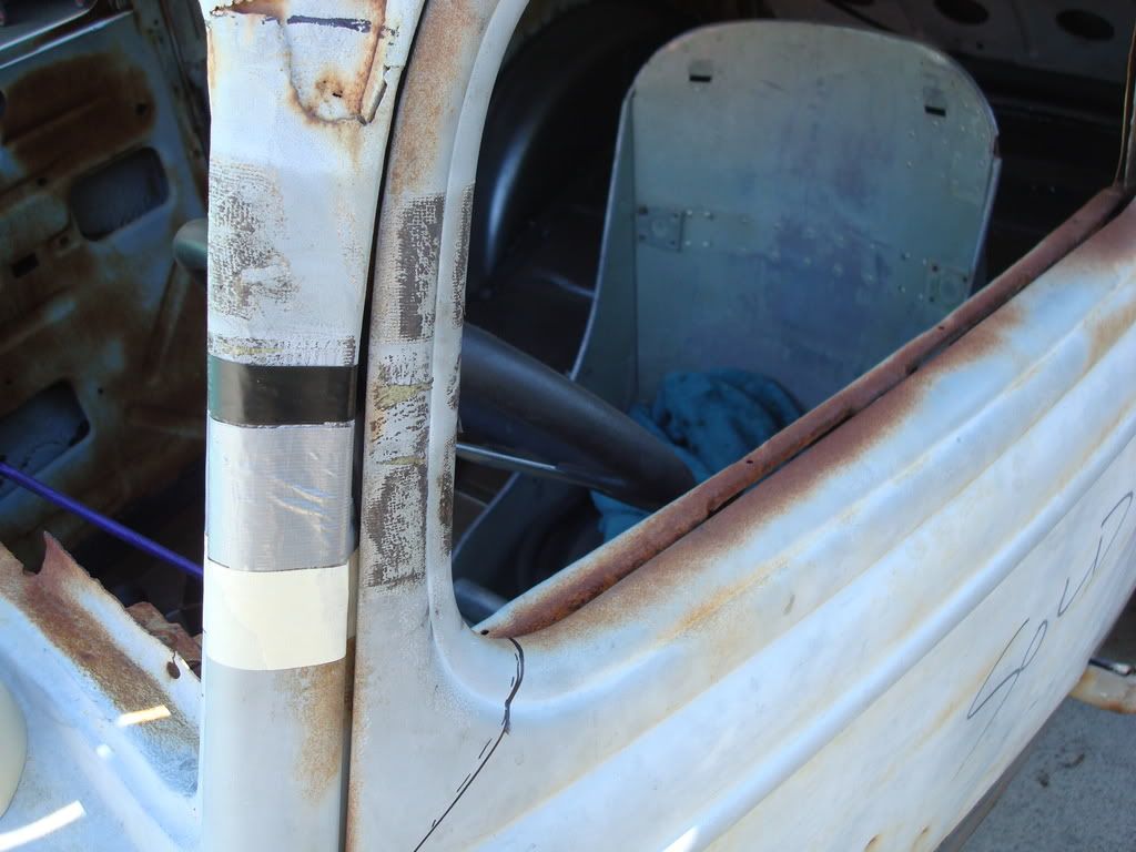

    because the roof is getting moved back you have to cut and slide the upper part of the b pillar forward
    getting closer,
    the outer sheet metal on the a pilars was really bad from rust forming around the factory lead seams, so they got replaced

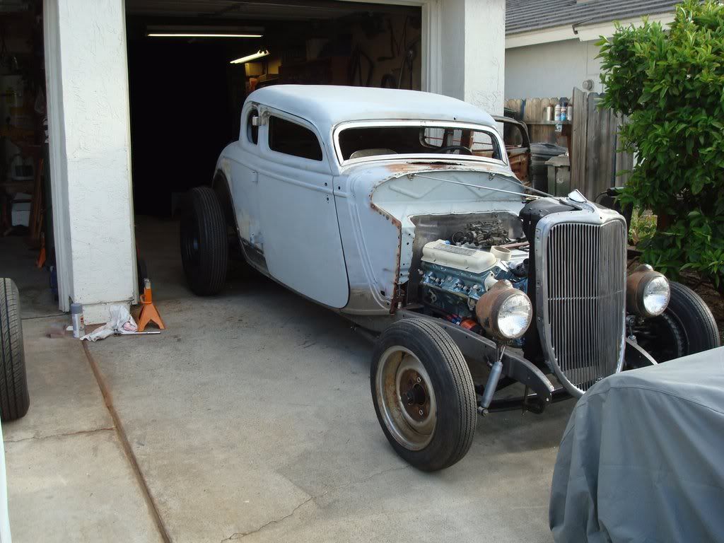

    yes this is one of the bodies from the swapmeet at the 07 scottsdale gg show, i bought them both with plans of doing the other one as a lakes car but ended up selling it to buy a roadster project, you can just see the roof of the other 34 in the first picture.
