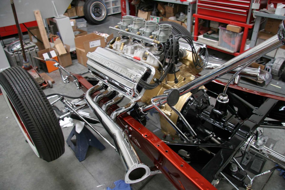

    dumprat
    from b.c.
    Thanks George. Looks tight but doable.

    Looks like plenty of clearance to me

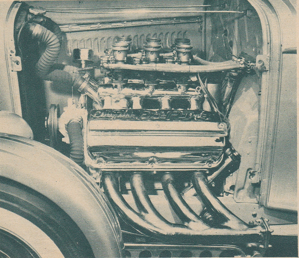

    Not as good a photo, but heres a chrysler with another '32 box...

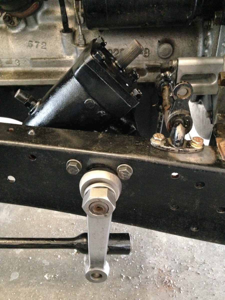

    image.jpeg Those are both 32's but it might be doable. My rising sun box is a little bigger but not much.

    I am keeping my steering box. I just want to know how much clearance I would have with a hemi instead of my little flatty.

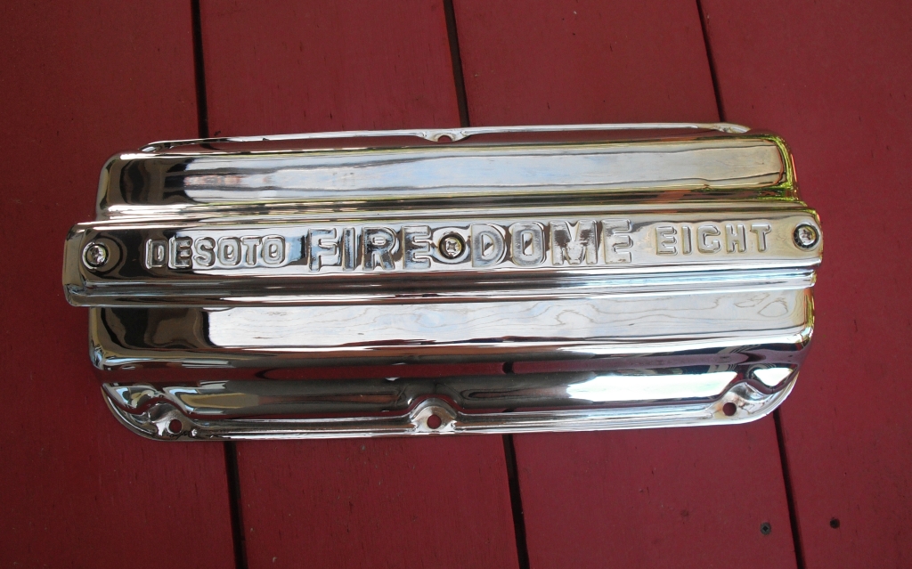

    Nice clean plug wire covers can be expensive and hard to find too. I hunted mine for well over a year. They are really a neat little motor, very well made, and the Desoto is really a nice size. If you were so inclined, you could fit it under a full hood on your truck, but like Vicky says, making headers to fit inside the rails and clear the steering would be hard work. It would probably be do-able, but not easy. I'm putting mine in a '26 T-coupester with a chopped '32 shell, the valve covers fit inside the hood line at firewall, but just break through at the front. With the wider firewall in your truck, the hood side panels would taper out at more of an angle, I think it could fit under a full hood without any bumps or blisters. There was a '32 roadster in Hot Rod that had a desoto in it with a full hood, I will post an engine shot later.
