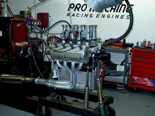

    1. Early Hemi Tech
    Chrysler hemi with Webers.

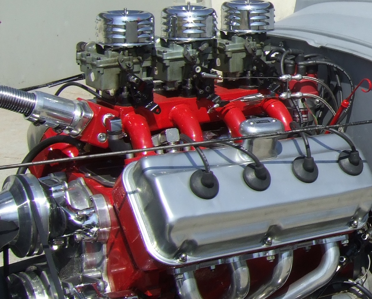

    TR I like the picture of Webers on a Chrysler hemi. However there are a lot of intake manifold choices for the Chrysler. The Desoto gets no love because of the lack of intake choices. In my case if you add the issue of hood clearance then its really bad.

    You could also slant the carbs toward the center of the engine some to give you more clearance for the hood. I've thought of that design myself, it sorta' copies the look of some mechanical injectors I saw on a 440 Mopar once. Since the ram tubes are staggered from the ones on the carb on the opposite bank, you can lean them over quite a bit and gain a lot of clearance. Then you eliminate the dogleg in the intake port and have a straight shot into the head.

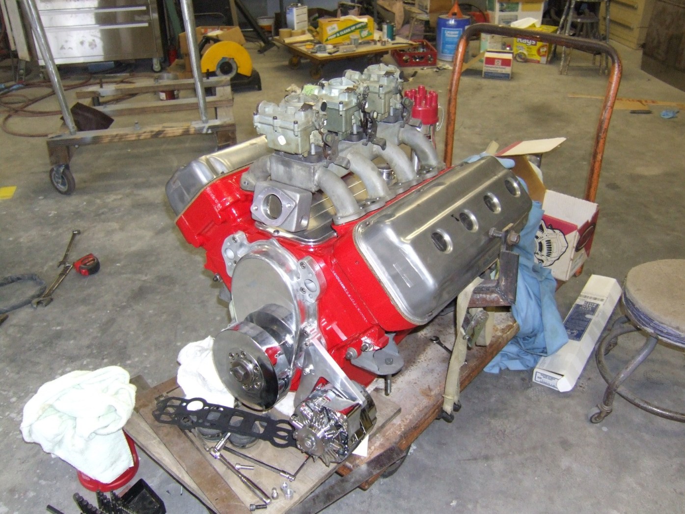

  13. Gullwing
    Joined: May 16, 2007
    Posts: 29
    Gullwing
    [​IMG][/URL][/IMG]
    I just got my manifold back from the machinist. Welded the two pieces to the base. I can then cast them as one piece and save me some cost.

  15. Gullwing
    Posts: 29
    Gullwing
    It's taken a while but I finally got my intakes cast up. This is a unmachined casting. I will probably be a few weeks but I will post a pick after I machine them and polish them.
