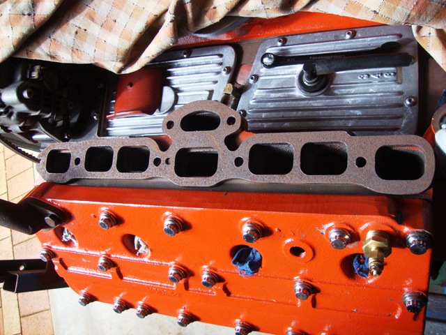

    Does anyone know of exhaust flanges being produced?
  9. fiftyv8
    Joined: Mar 11, 2007
    Posts: 5,401
    fiftyv8
    from CO & WA
    I think on one of the other Cadillac flathead threads way back when it was mentioned that somebody was making them, but that is a good few years ago now.
    I made extractors and got a full 3/8" flange plate cut out to match my exhaust gaskets from a laser cutting shop.
    Only thing was I then needed longer studs to account for the added thickness of material.
    Plus I needed a 2nd gasket that was trimmed to fit for the intake manifold which sits on top of the new exhaust flanges.
    Checkout my attached pic's.
    I did end up getting a 2nd set of flanges cut out as I decided not to have that opening that heats under the intake manifold. I'll use the other set on a 2nd engine I have one day I guess.

    Yes, now you have posted that is the name of the outfit I was thinking of, the name posted here ages ago...
    Dealing direct with the laser cutter I got me 2 sets of flanges cheaper and sourced longer studs from a shop who made U bolts, as they were best placed to cut threads on tensile shaft.
