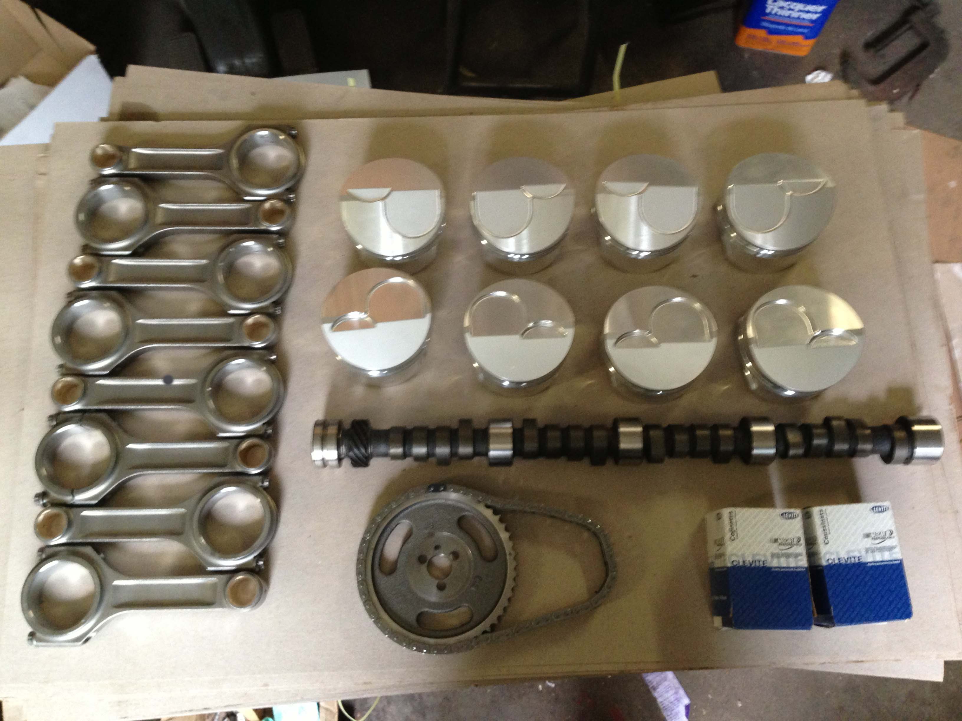

    Only thing vs. the more common motors is that they were only produced for 8 years and in never in really large quantities (unlike other early big blocks like nailheads, big block Pontiacs and FE Fords). This means cores are tough to come by and therefore expensive. 409's are through the roof and 348's in useful condition are going up fast. This seems to be getting worse as renewed interest in these motors has resulted in the production of great new pieces like the Edelbrock aluminum heads and all the stuff from Lamar Walden.
    You can't just throw one together for a couple hundred like an SBC - so you may as well build it right and that can get expensive. Summit sells a re-ring kit for Chevy 350 for $85 (rings, bearings, gasket set). I paid $120 for the gasket set for my W motor.
    On the other hand, there probably isn't a more visually impressive motor for a hoodless car this side of an early hemi.
    Here's mine - .40 over 348 block, 396 BBC forged crank w/mains turned to fit (3.76 stroke) 409.5 cubic inches -----forged rods, custom forged pistons 10:1, custom cam grind, oversize ss valves, new springs, guides, screw in studs, guideplates, roller rockers, etc, etc.
    I probably put more money in this motor than all the smallblocks I built over the last 40 years combined. It was nice to do it right for once and to know it was worth it because I have something unique that will be a source of pride for years.

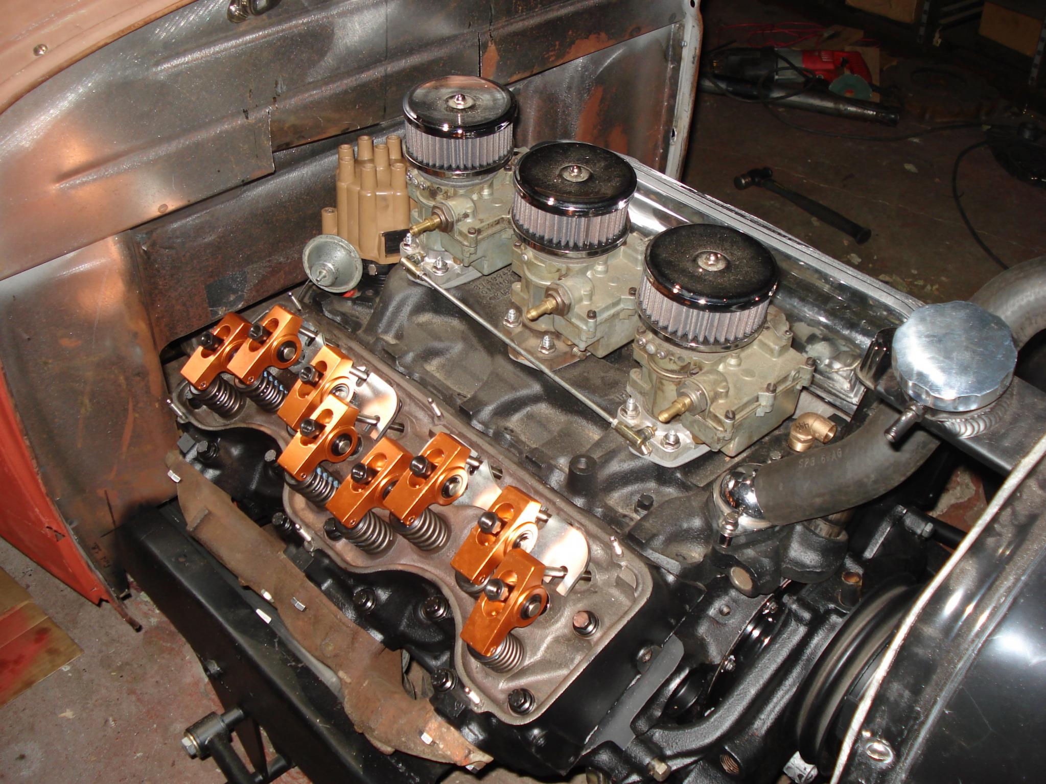

    my 348 going in my Merc.
