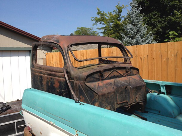

    The car was living about 30 miles south of Missoula. I've got it tucked away and I'm knee deep in a parts sort right now. Once that's all settled I can get back to building my ch***is. I'm itching to move forward. I'm on the fence about fixing the top where it was hacked out, filling it, or filling and chopping. I'll spend more time staring at it and the answer will come.

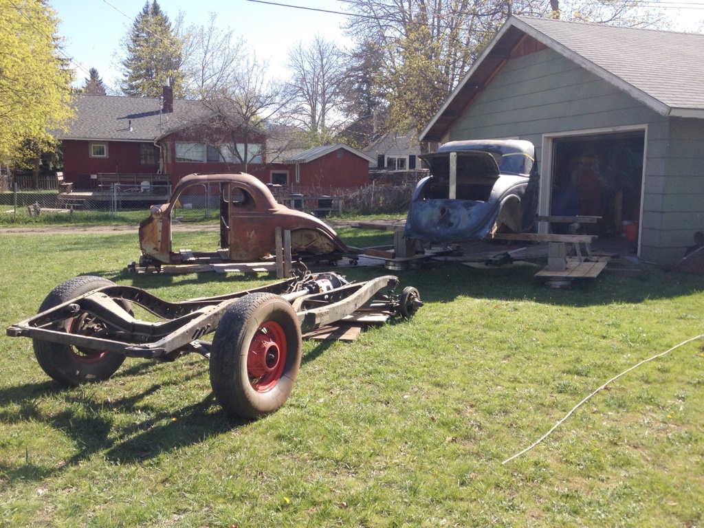

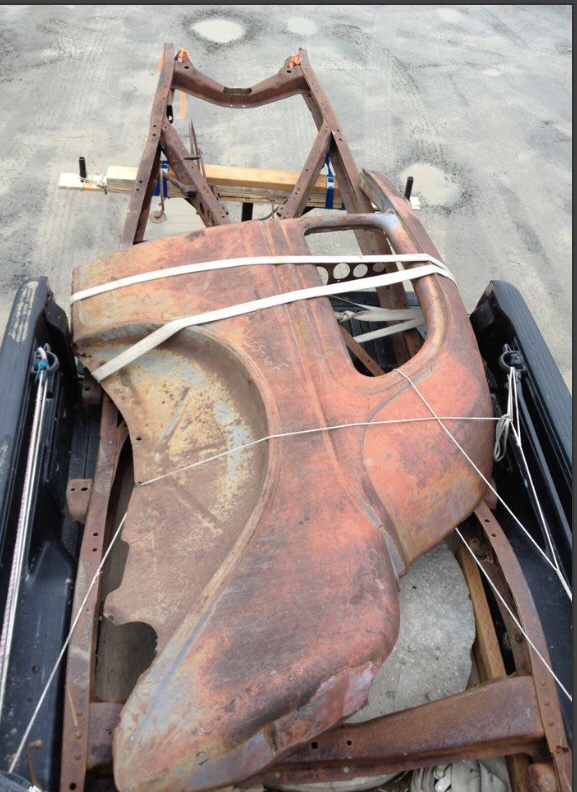

    So it's creeping up on a year since I brought home the 3 window. How about an update? First I'll get caught up to the point in the '35 Ford project to where I got the car, then I'll go from there. I'd been scooping up all the '35-'36 stuff I could afford for a while. I drug all this (and more) home:
    The frame had been hit and was unhappy:
    So I tore it apart and straightened it:
    And started to re***emble:
    This is around the time I got the 3 Window. I am overrun:
    More to follow....

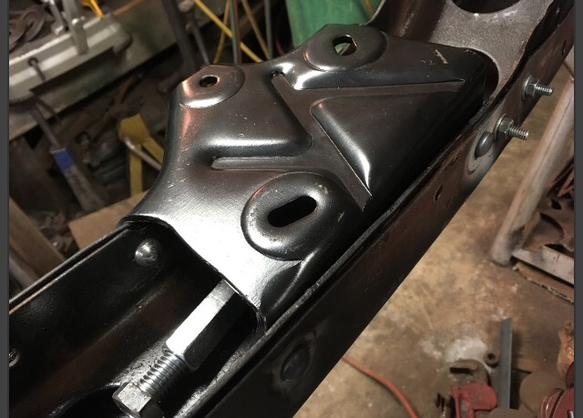

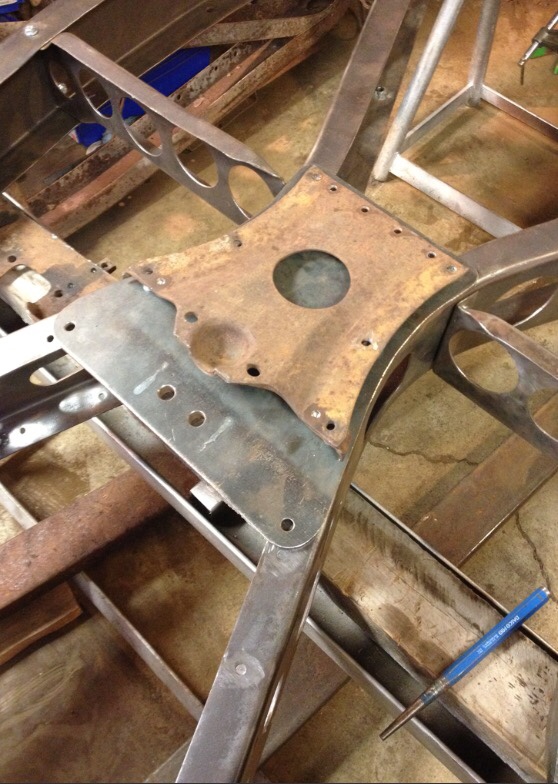

    I started riveting the frame back together with a '37 and later style steering mount:
    And started test fitting parts:
    Its a tight fit. That rams horn and the '35 pedals are a no go. I had to do a lot of pig surgery to get that shifter in.

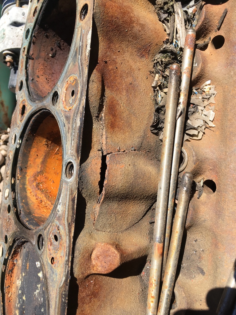

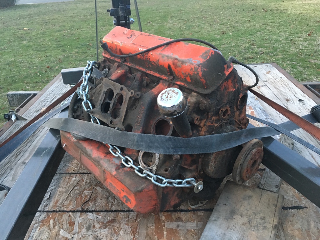

    I already had a 283 and a T10. I scored another free 283 out of a boat but it was toast. Someone hadn't winterized it and the block was ruined. At least I got a flywheel from it. I just scored a 327 with 461s on it last week. I think its a winner but I haven't torn it down all the way.

    You need a 67-72 chevy pu drivers side rams horn to clear the steering box.
