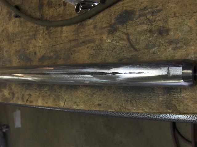

    HPIM7067 (Small).JPG HPIM7069 (Small).JPG HPIM7073 (Small).JPG HPIM7082 (Small).JPG HPIM7083 (Small).JPG HPIM7089 (Small).JPG HPIM7090 (Small).JPG I ground down all the plug welds and the ugly factory seam, as well as all the factory orange peel. I went over some areas with a flat file, this let me know where more material needed removing and to just straighten things up. After i ground off the factoy seam i grabbed some grinding dust off the floor and sprinkled it the legnth of the weld and bounced it on the bench a couple times, poor mans magna flux;) I draw a line down the tube right where the dust stayed with a sharpie. I then cut down the line with a cut off wheel, i make a second pass with the wheel cocked abit to open up the cut more. The factory weld is full of, well who knows what, but i burn all the bad out and weave side to side to fill in all the porosity. I had to sharpen the tungsten a dozen or more times as stuff pops up out of the weld ....man it's ugly:eek:

    This is the ultimate answer to the "Failed '36 Wishbone" thread...
    Great work Harv, I have always done them the easy way by adding an upper link. Your way is better.

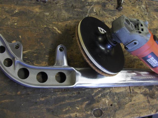

    HPIM7173 (Small).JPG HPIM7175 (Small).JPG HPIM7174 (Small).JPG HPIM7179 (Small).JPG HPIM7186 (Small).JPG HPIM7183 (Small).JPG Welded, ground, filed, repeat several times and all is deemed good. The last pic in the above post is shown below, weld ground smooth. Welding up the factory seam is a pain for sure, no matter how many times i go over it there will still be pin holes, albeit very small ones. Tomorrow the final polish will be done, 7" scotch brite pad at the ready. These pads lose about 50% of their affectiveness in the first minute, so i plan my strategy before hand, hitting the areas that need the most smoothing first and then move on.

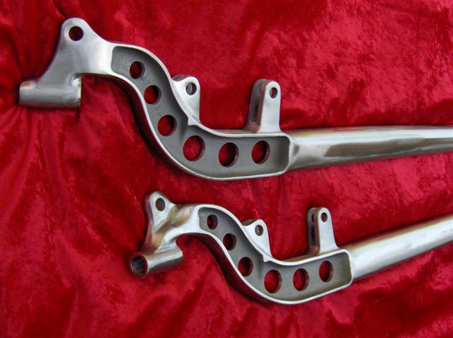

    HPIM7206 (Small).JPG HPIM7199 (Small).JPG HPIM7215 (Small).JPG HPIM6664 (Small).JPG HPIM7205 (Small).JPG HPIM7208 (Small).JPG HPIM7166 (Small).JPG They're done, well atleast my part....thanks for the kind words guys:)
    These were done for a fellow HAMBer, and per his request they are 60" from axle to tie rod center, 2 3/4" shorter than stock. There are a few threads on here showing these bones mounted in front with a front wishbone yoke. Both ways work, it's just a matter of preferance and/or frame style. Old parts saved from certain death to live on under a cool traditional hot rod...how cool is that...old parts RULE!:)

  19. Very nice work, some great planning in that work
