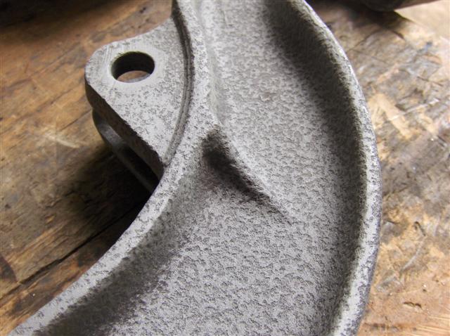

    More parts with heavy pitting, are there any smooth rust free hot rod parts on the east coast:) The pitting looks like that hammerite paint, note the nice smooth metal where the washers were.

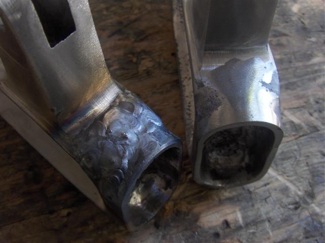

    I removed the tubes so it's easier to modify the ends, and re-enforce the joint since the weight of the car is now hanging off the tubes. Since the original spring mounts are no longer needed they will be removed. I have seen 35-36 bones with this mod before and they usually cut them off just past the recess. While there is nothing wrong with doing that, as seen in the pic above, one side has a recess about an inch longer, so to keep each side looking uniform you have to cut the ends at an angle...I have a different idea. After studying them for awhile, I drew what I thought would look good, the dark curved Sharpie line. After looking at it it reminded me of a runner on a sled, so I cut them off square.
    After cutting them off, I cut out a pie shaped piece so I could bend the rear edge in to keep the natural taper. Also I used a cut-off wheel to remove the little web in the recess as they really aren't needed now with the weight of the car not hanging out back. I started polishing the recess, it will be fully detailed before I move on the finishing the ends...I have a special detail that these will be getting, it's not holes...stay tuned.

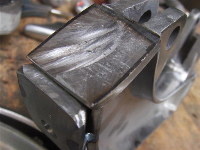

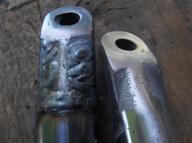

    I snuck in a little more work today between other jobs, here is what I got done. I changed my mind again on the ends, I cut them off at an angle so that they would be square to the recess. I knew before I started that I wanted the ends to slope up to mimic the other end of the recess at the tube connection, here is what I did.
    I stuck a piece of cold rolled bar stock in the mill and cut the sides curved with a hole saw, these will make the ramps at the end. I made cuts at the edge of the forgings with a cut-off wheel and then drilled some holes and removed the piece. I had to grind and do some clean up with a carbide tip on the die grinder to get the piece to fit. Also I made a nice ledge at the rear of the rear bolt hole for the cap to sit on, it came out looking pretty good. The ends will be detailed before I weld them in, I will need to add some heavy welds into the corners to make a nice transition, not looking forward to polishing/blending them...more to come.

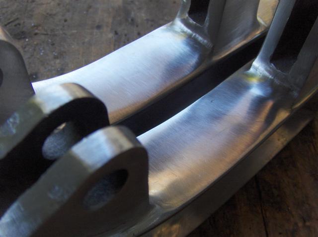

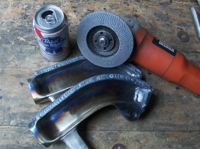

    At the factory they used a big cutter to make a nice machine finish between the mounts. They cut into the area between them as well, since that area is flat there is no way to prevent it. I have done several sets of these bones and some don't have much of an over cut, while others are deep, these are pretty deep.

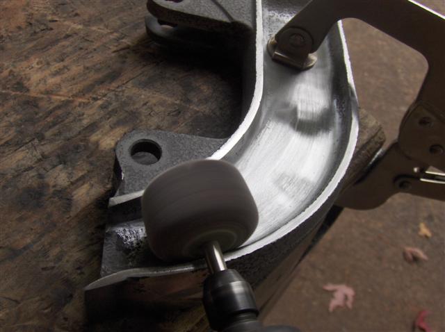

    I start with a barrel shaped carbide cutter to do the majority of removal/smoothing, making sure to move around in a criss cross pattern to help prevent high and low spots, kind of like finishing concrete. As much polishing as I have done I can tell as I go if I can get the results i'm after without having to fill/weld in the low areas, these didn't need any filling. After the bit I use to two different diameter flap wheels and then discs, they are roughed in and looking much better.
    Also, the top where the tube starts always needs filling, I filled these areas as well as some thin/low areas along the edges, ground all down, still needs more work but looking much better.

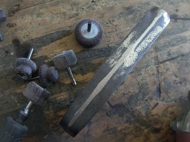

    Polishing the inside edge eats up the flap wheels in quick order. When the recess is as nice as I can get with the wheels, I switch to a chunk of bar stock and emory cloth, standing up for the ends, and laying flat in the long area. I left the end caps off untill I finished the sanding as it made it easier. Also I haven't rolled/detailed the edges yet, more on that in the next post.

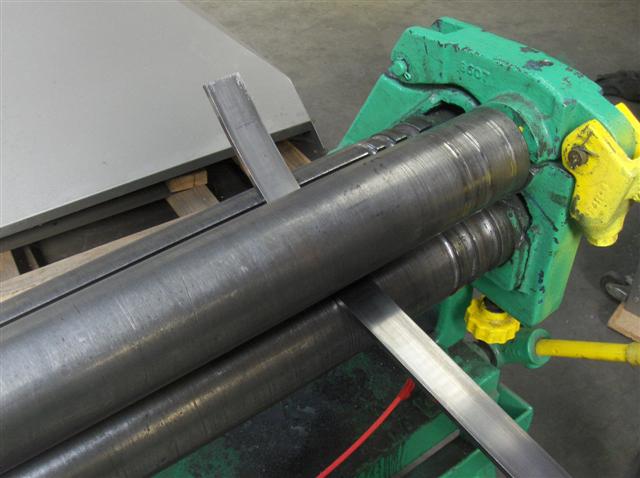

    I ground the bottom side flat as it has a slight dome from the factory. I then ran down to a local shop that I go to often for material or fab that I can't do and had them run a piece of 1/4" X 1 1/4" cold strap through the slip roll until it matched the curve of the ends. After some minor adjustments/fitting I drilled three holes in each for rosette welds and gave them a heavy champher. I clamped them, tack welded each, including the ends, and welded them up. Both pieces had a good size champher, I did that so the weld would be deep as as the edges would be ground thin once the peak was finished.
