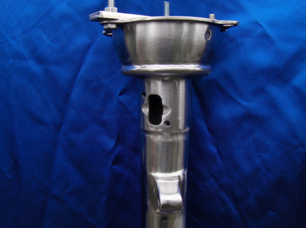

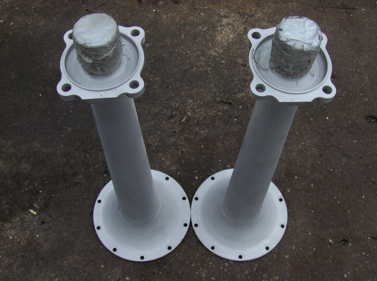

    The tube is done and back in the HAMBers hands, ready to go under a cool traditional hot rod.

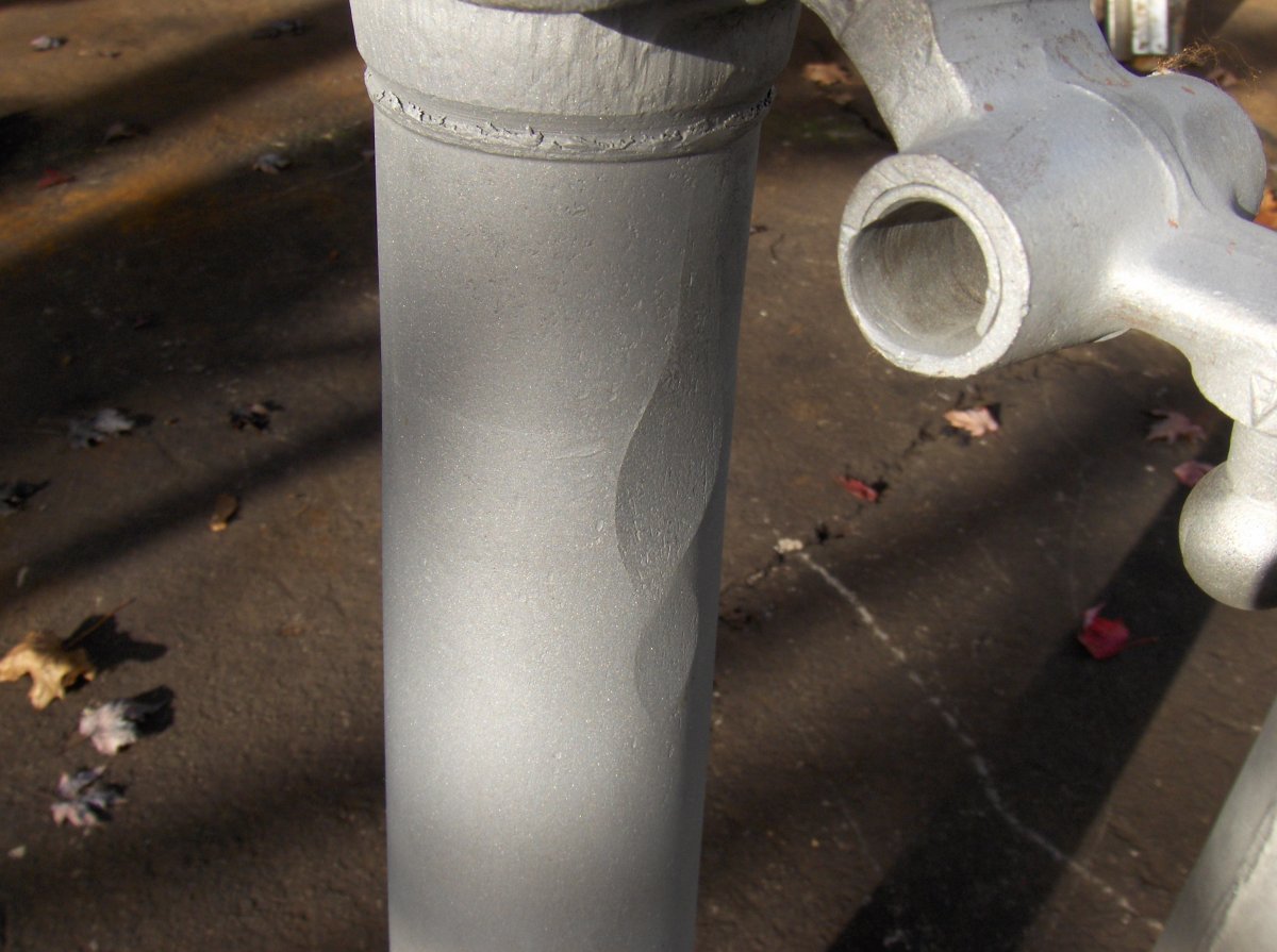

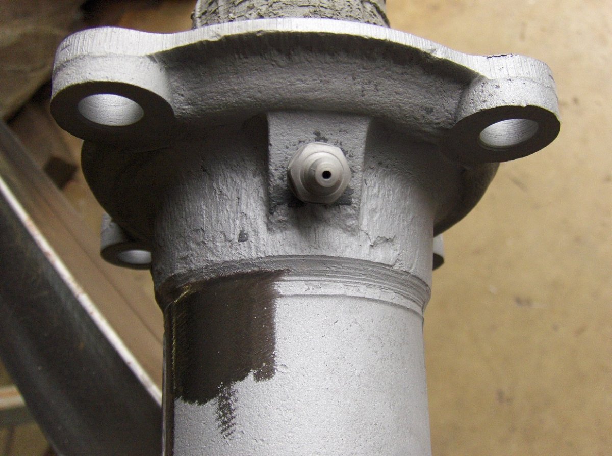

    These were sent from another member for some clean up. After blasting the scars from use are clearly evident. There is a large dent close to one end, and some rub marks, can't find a single tube to replace it, as all my cores are complete and don't want to part them out. Will see what happens when I try and repair it, it still may need replacing. They also have some gouges from years of floor jacks as well as almost worn through shackle mounts, but they will be removed. More in a few days.

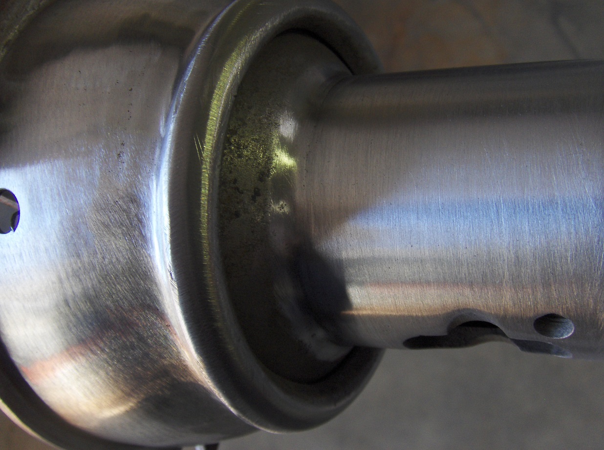

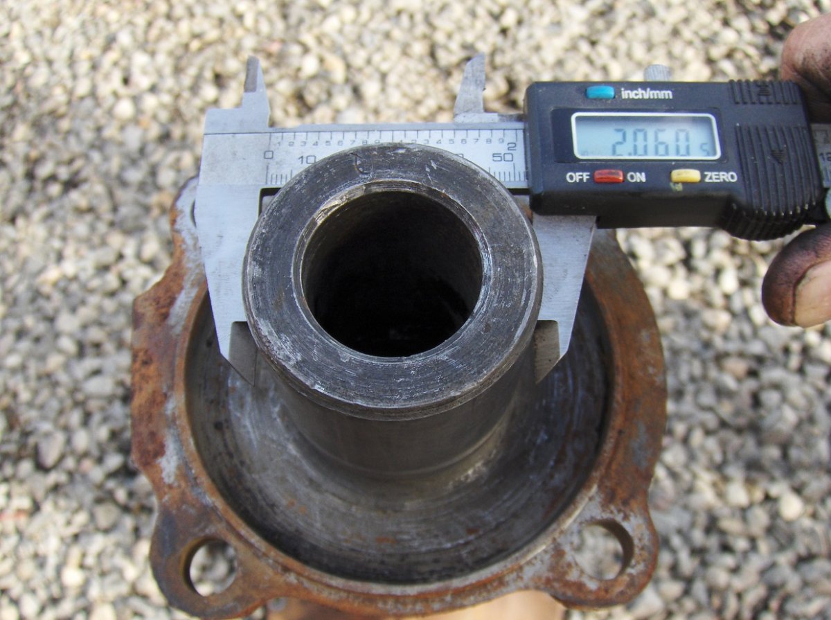

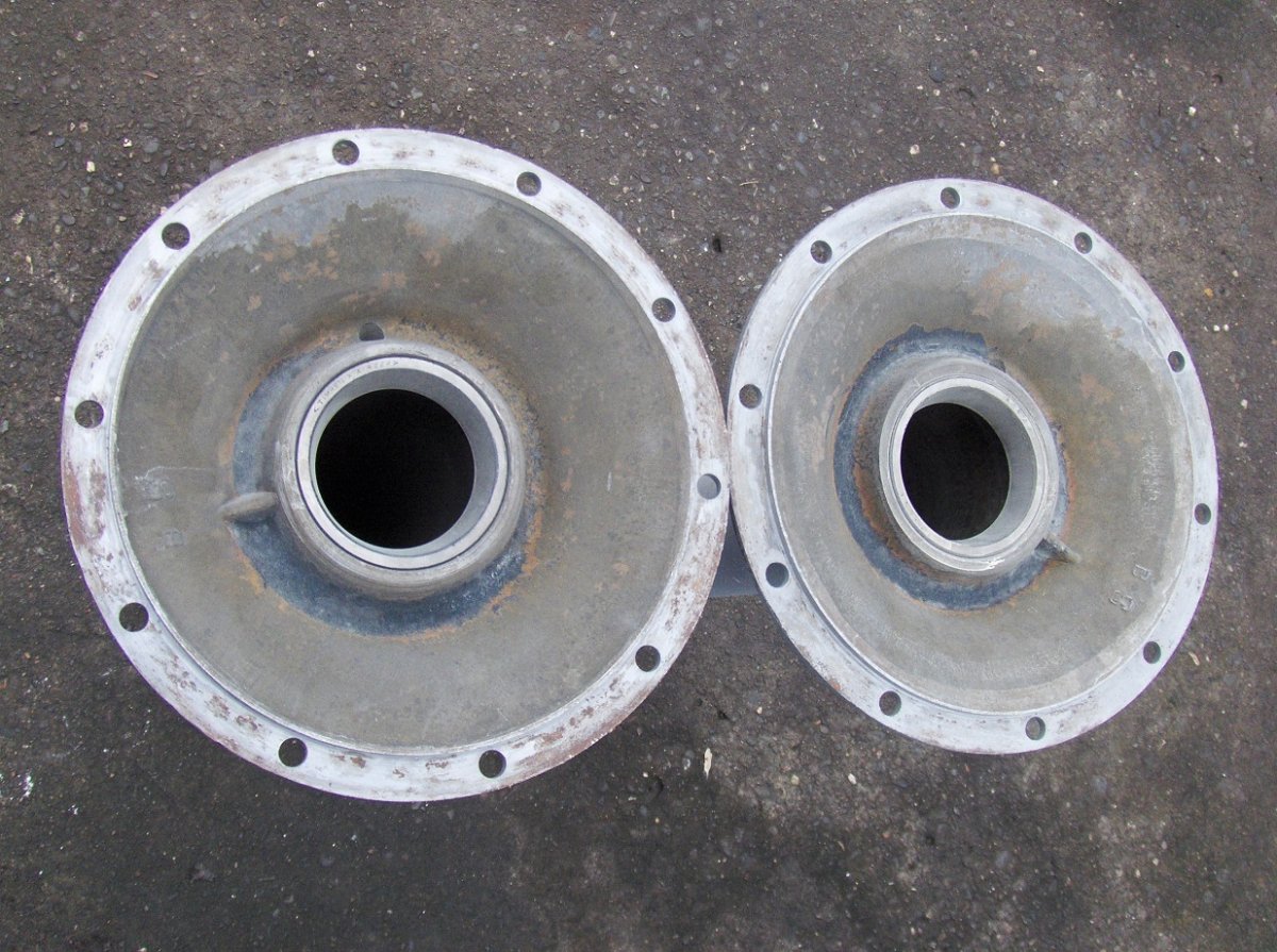

    After closer examination, I noticed that one of the flanges was bent and getting it straight so it would seal again was an exercise in futility. I checked some local resources for bells but all I could find were late ones, so I pulled an early A rear from my private stash that I was saving...oh well, they're going to a good home. :)
    Typical crusty vintage car parts, old grease and spiders, bells came off with no problems. I took them to a local machine shop with a wash cabinet, a half hour and they were nice and clean. While there I measured the bearing area, one measurement vertical as the bearing rides and one from the side, both bells were in good shape.
    Pics next post.

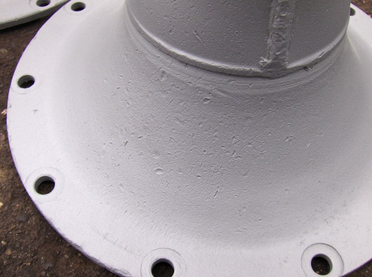

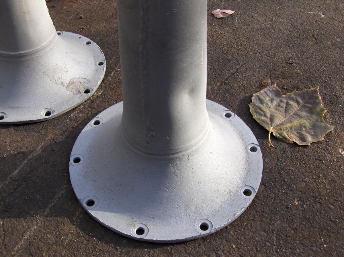

    Here they are, freshly blasted, you can see all the nicks and gouges along the tube and on the bell from rocks thrown up by the front tires over the years, both look about the same. The spring perches were cut off long ago, I would have removed them if they hadn't as the tubes will have 35-36 bone mounts welded on. I told the blaster not to blast the inner flange/bearing area, I didn't want the mating surface compromised.

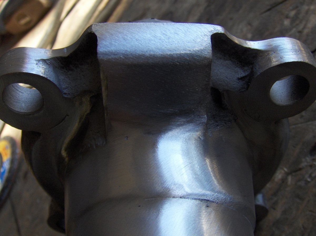

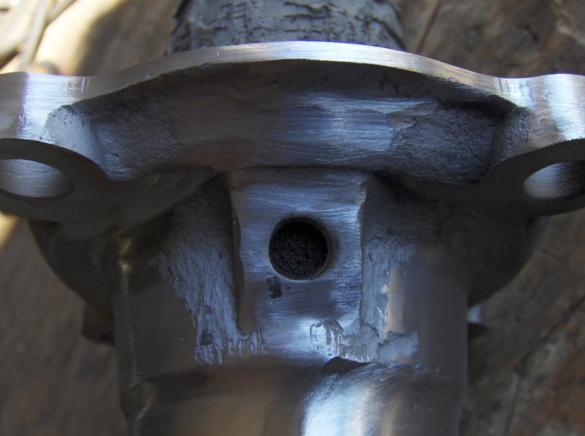

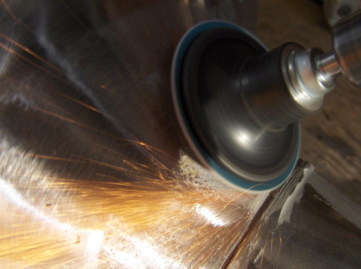

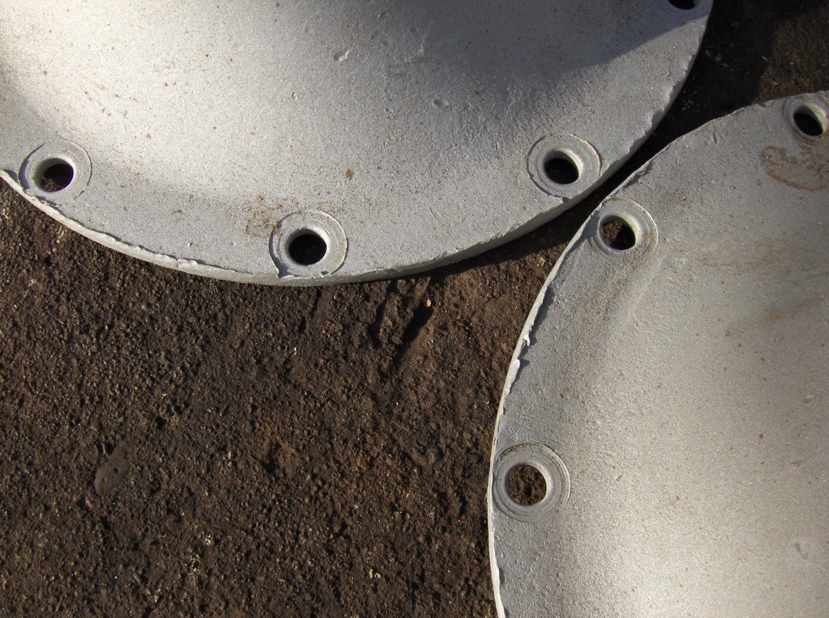

    I got most of the gouges sanded out, there may be a few spots that will need filling after the next grit. I will be leaving the welds, I don't want to try and remove them as the tube would warp from welding. I will clean them up and knock the rough points down, then let the polishing compound do the rest. The area around the bolt holes that were machined will be left, some are mostly gone and what will remain will be covered by washers.
    It's hard to photograph, but where the tube meets the bell it is wavy and not a perfectly smooth transition, I only mention this as it will be apparent after they are chromed.
    Pics next

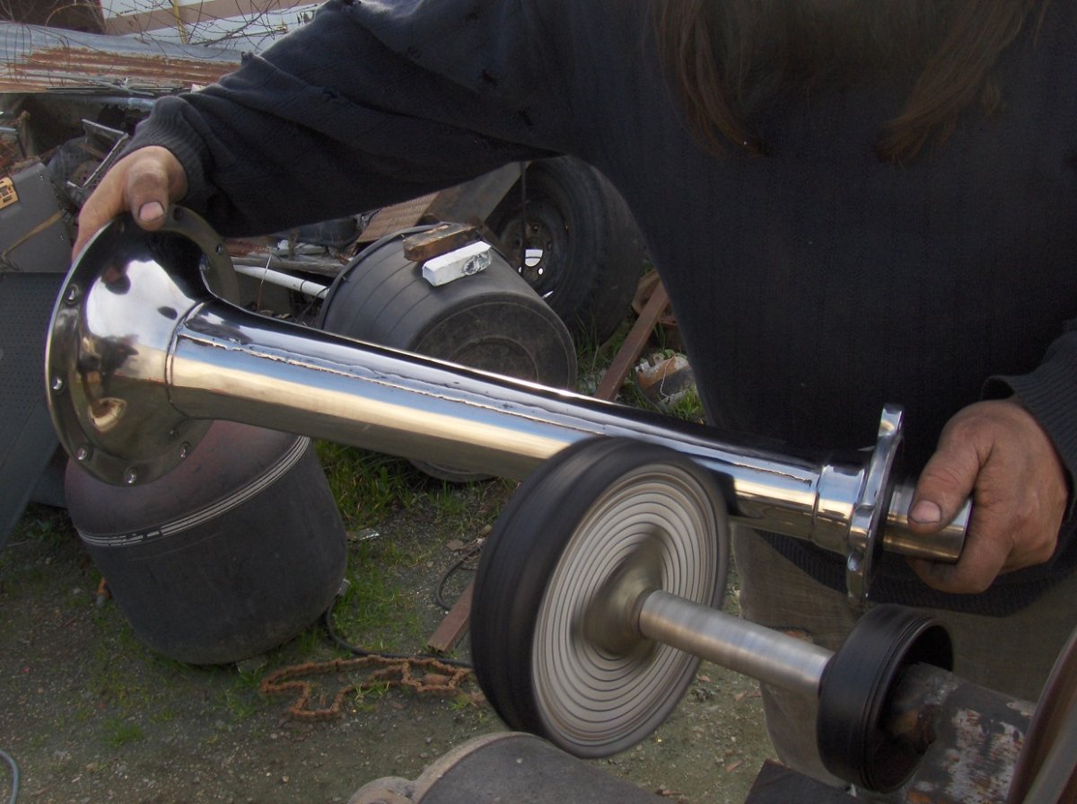

  19. 117harv
    Joined: Nov 12, 2009
    Posts: 6,586
    117harv

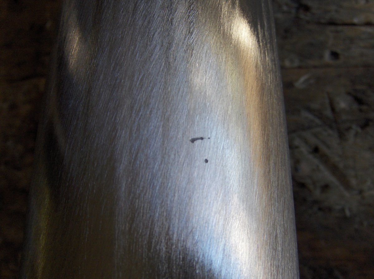

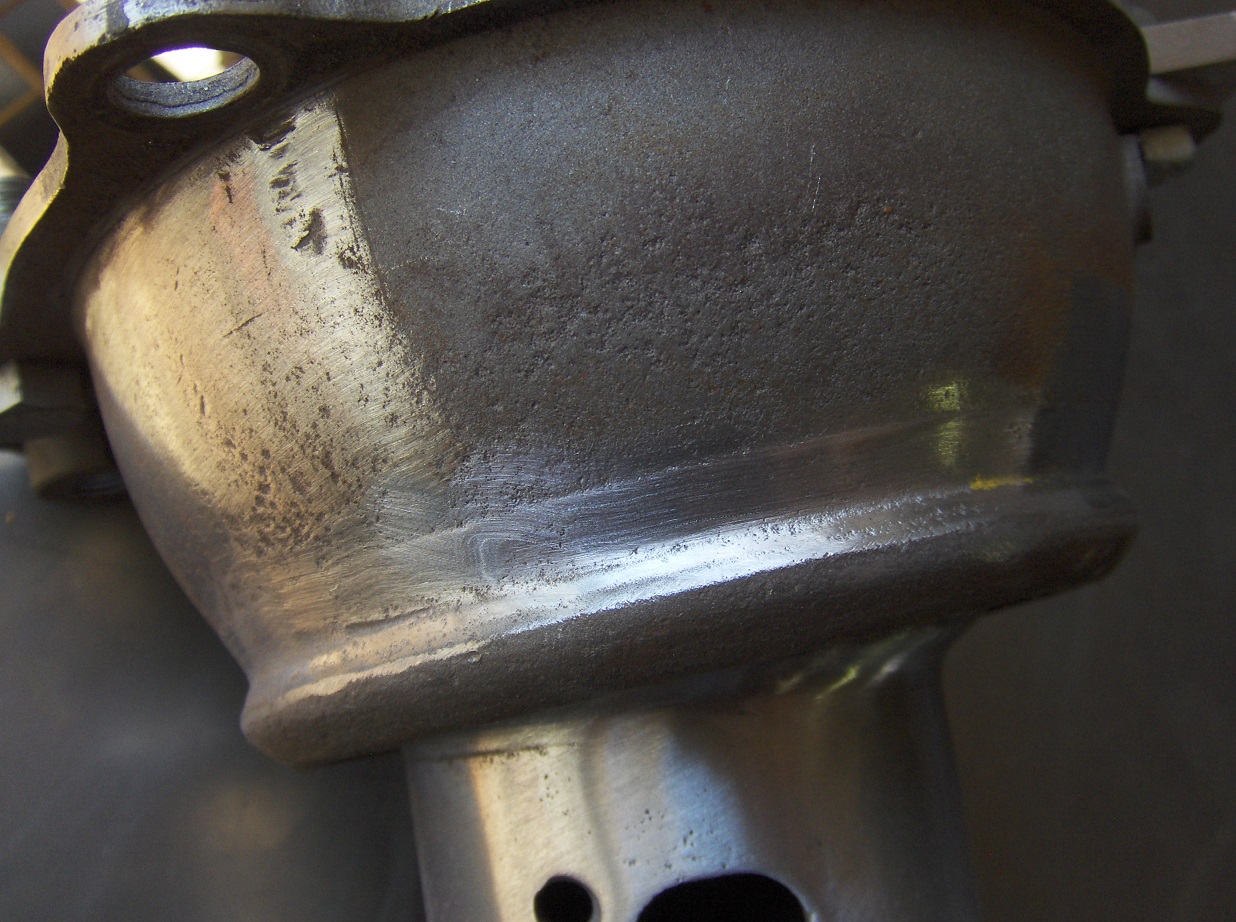

    Some more progress shots, the ends will take some time, lots of low areas, some filling maybe?. The square area where the spring perch was will be smoothed and rounded, no reason to remove it. Again, after doing so much polishing I can tell when a low spot or imperfection just won't sand out, some very small imperfections/scars will need filling.

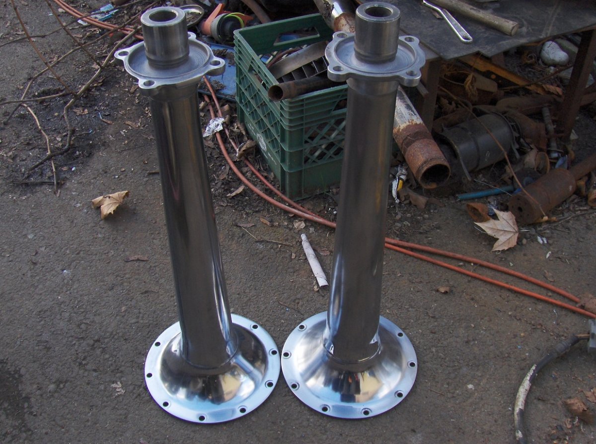

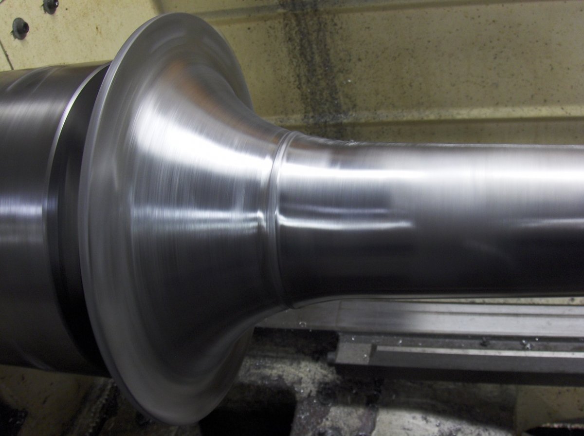

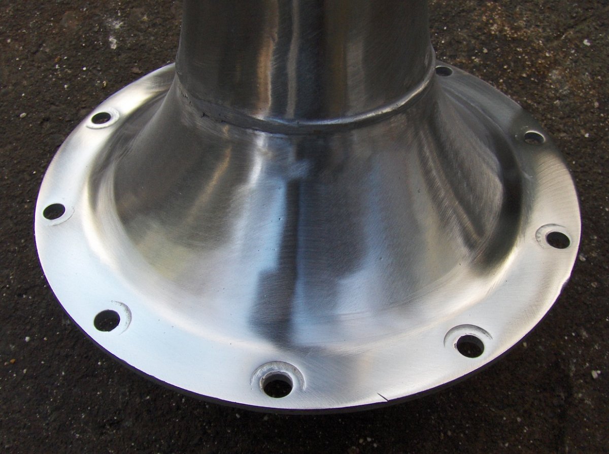

    The compound curve of the bell is very hard to sand, no matter what tools or abrasives I used, it left an uneven surface. I did what I could and then went up to a local friends well equipped shop to use his lathe. It looks like it's really spinning but was just doing 70 RPM. Started with 50 grit and then finished up with 180 emery cloth. Took awhile get the surface where I wanted it, note raw finger tips, but coming along nicely... :)

  23. 117harv
    Posts: 6,586
    117harv
    I used graduating grits of sand paper and wet sanded all until my fingers were raw. I then went over them with a DA sander and 400 grit. The shot of them together is before polishing, and one shot polishing. Final pics in a day or so.

    The addition of the strap to get the peak had me going, I wondered why the extra thickness on the upper side!
    Then we found out...
