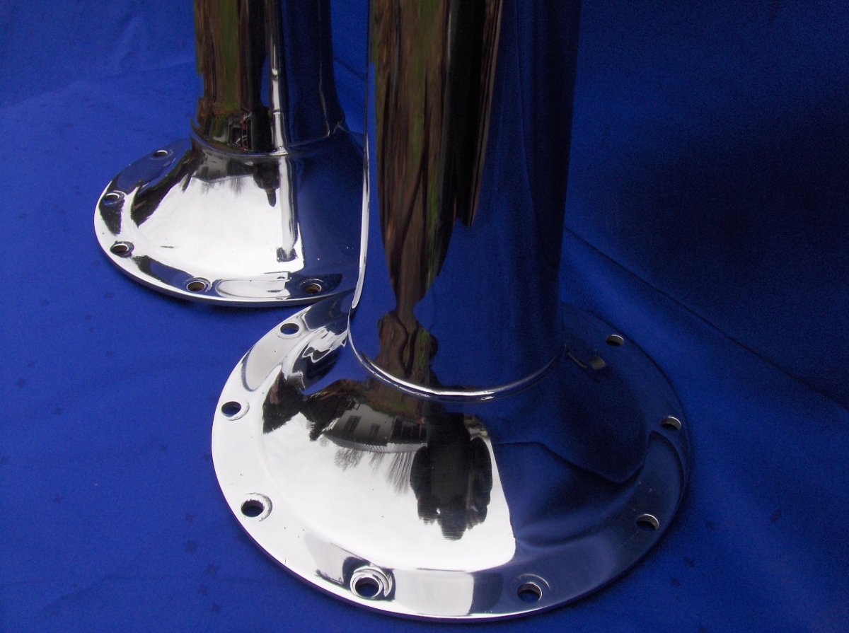

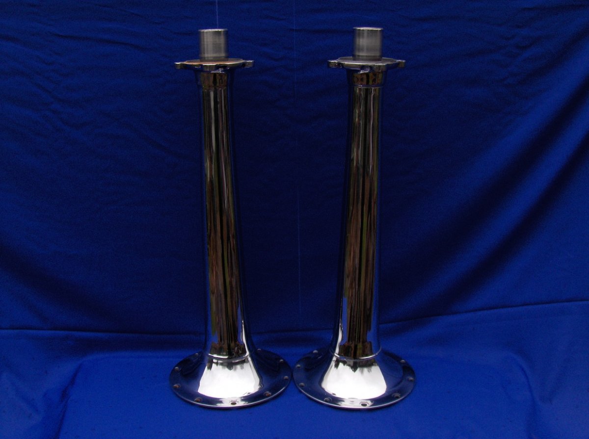

    Just finished up a two speed banjo, the finish was done up to 800 grit final sanding by hand. 020.JPG 024.JPG 025.JPG 032.JPG 016.JPG

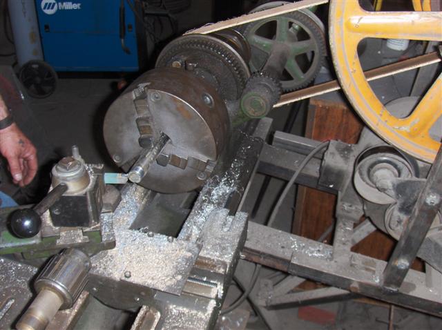

  22. I have a pair of 36 Bones and am using your article to build mine. They will go in a 32 Ford roadster that I bought in 1979. It was a basket case but I am trying to get it on the road since now I'm retired. This also means that I am one a tight budget, so I'm trying to do as much as I can at home. I am running a 300 hp. sbc, 4- speed Muncie and a 59 Ford rear. I said all that to say this. I have cleaned my bones (molasses), cut off the rear kickup portion. I have the 7/8" C.R. and it is turned down for the tie rod ends (Speedway). The oval portion of the bones will be about 44" long. One side has a slight arc of about 1/8" and the other is abt. 3/8". I don't have access to a press, so I am trying to use my port a power. I built a welding table with a 3/8" top plate and have bolted a 3x3x1/4 angle about 30" long to the side that the port a power base will rest against. I have bolted two additional 3x3x1/4" angles abt. 8" long (no reason for the length other than I had them in my pile) . I put one bolt in the center of each of these. I applied force to the center of the tube and it moved abt. 3/4", but sprung back when I released the pressure. Do you think that I should heat the bone to bend it straight. That was a lot justto say that!
