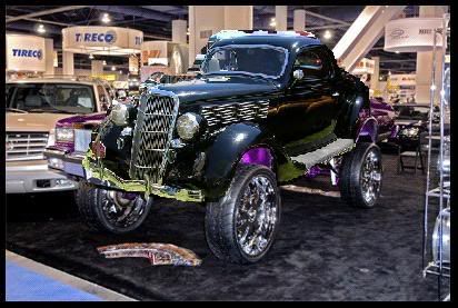

    I got this spyshot of Cab's 35 3 window after his recent top secret changes......

  30. chrisp
    Joined: Jan 27, 2007
    Posts: 1,359
    chrisp
    The customer told me this was a 1934 Packard grille (I'd ask him for a 40 grille and he came back with that), but I doubt it cause Packard grilles are not curved at the bottom and have more bars, I doubt too that this a Chevy even from a COE, they have horryzontal bars, I have no clue of what this is, but I like it and the customer loves it too for it's m***ive look.If somebody knows and have a pic, would be nice. I'm gonna try to post pics tonight or tomorrow night:eek:
