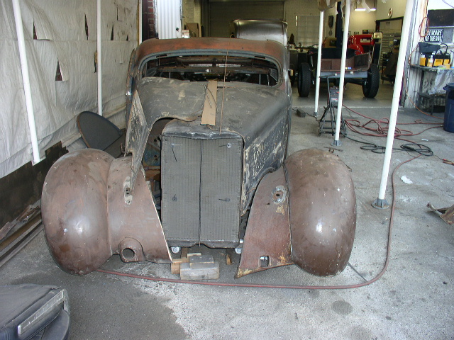

    I just noticed that there is no picture of the grille I'm talking about, the Chevy grille was there just to have an idea of the proportion of the car.

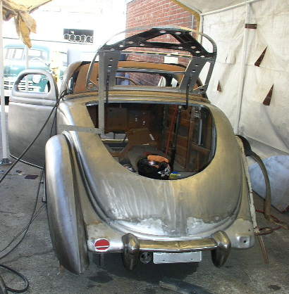

    Here goes
    A little bit of clean up and a 95% done rear fender
    Boy do I love this profile

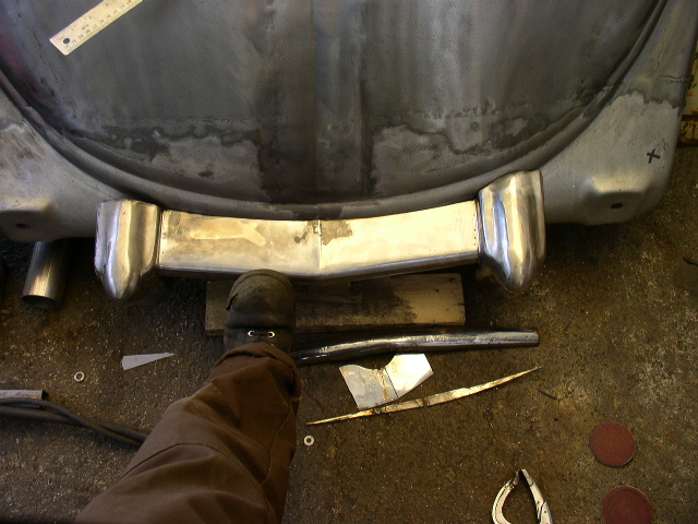

    A rear bumperette from a Merc
    I added a peak, cut the rear to conform to the shape of the body and the right bullet is extended too to be real tight with the body, I replaced the edge too (piece on the ground) cause it was way too rough and now it has the same peak as the rear body panel
    Before fabricating the brackets to check the fit
    The finished product that bolts on the frame through the body at it's original location.

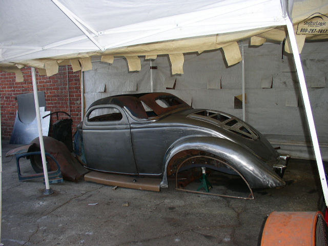

    This week I made the running board, not a straight one, one with a gentle curved edge lengthwise, I still need to extend it at the bottom, it's gona be molded to the front fenders and the lower corner of the fender is now part of the running board. I hate that big gap between the running board and the bottom of the quarter panel, I'm gonna fill that up. I also made the skirt.
    I'd like to lay the grille like that, for 2 reasons, 1 it looks better, 2 the front fender just look wrong now when compared with the swoopy rear, it is too short, too bulky it is more visible from a plain side view.
    The right side fender is hum...
    So I looked around the shop and found a 37 Chevy fender, which coincendly kind of match the rear one in it's general shape, other advantage, it's longer in the front of the wheel opening , just what I need, it would need a peak and get rid of that ugly step (ugly on this car that is) I will see what the customer thinks about this idea. Other thing, thanks to an australian Hamber who swung by the shop today I now know that the grille is from a 45/47 White truck. It's too square and too wide, but it can be fixed, I still love it.
    With a little help this fender could be right at home, we will see.
