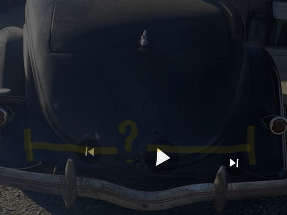

    Good evening , can someone give me this dimension from their coupe or roadster? Would appreciate it greatly .

    Hello all , can someone well me how much wider a rear coupe fender is compared to a sedan fender ?
