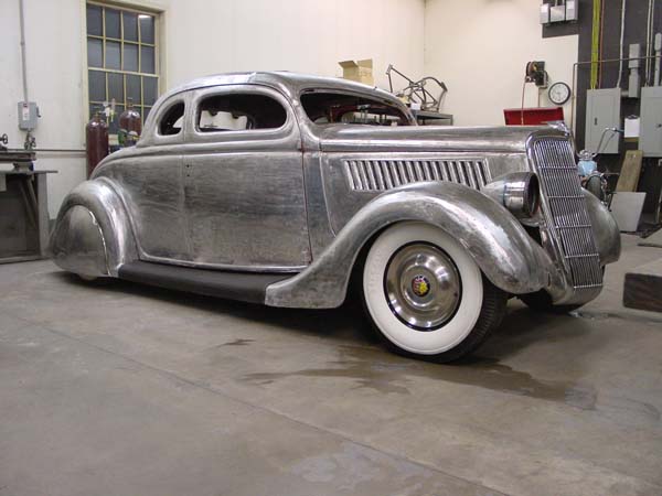

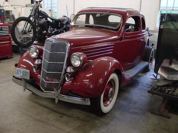

    About three years ago, I started a thread chronicling the transformation of a 1935 Ford five window coupe into a traditional early post war custom. With a little help from a talented buddy, I got from here:
  2. Turkey Rollup
    Joined: Aug 30, 2006
    Posts: 126
    Turkey Rollup
    To here:

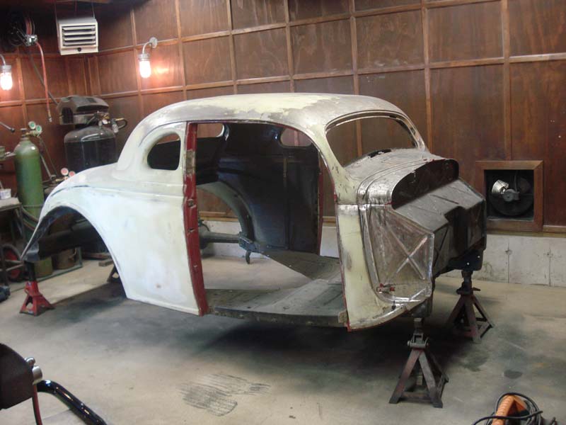

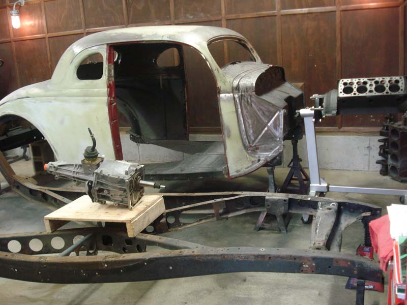

    Here's where it was a few months ago. Body on jack stands and a frame outside leaning against my shop.

  6. Very nice, how much of a chop?

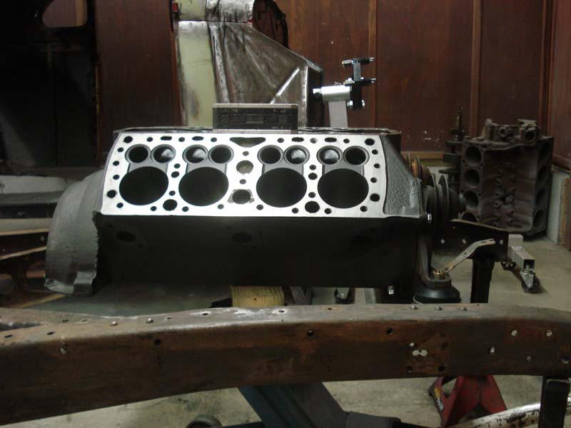

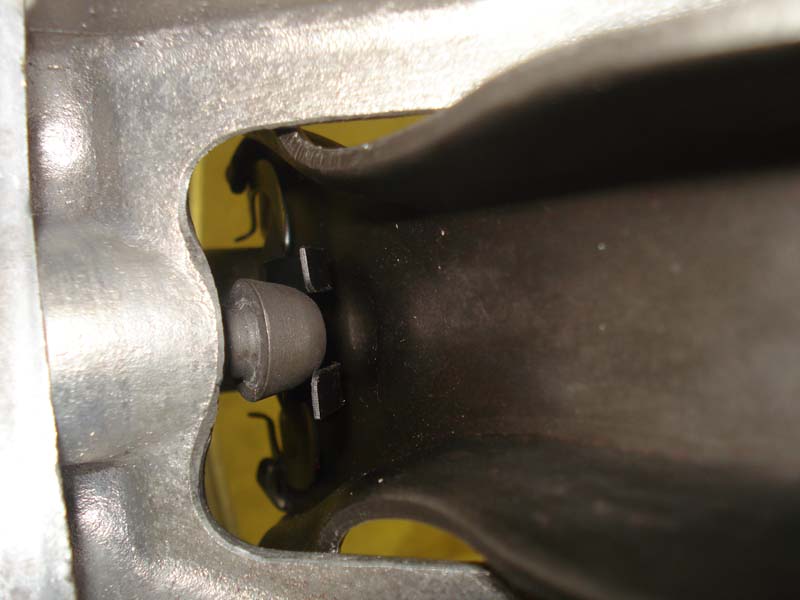

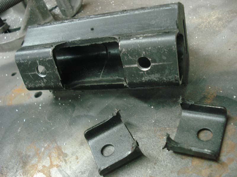

    First up, obviously, is getting the drivetrain situated in the frame. I'm using a 59A flattie, hooked up to a t-5 ( one of my few concessions to modern convenience and know how). I found a dealer with a couple of new-in-box 1995 S-10 T5s, and he was selling them for a song. I knew that this was part of the short run of T5s with "world class" gear sets and a forward mounted shifter. What I didn't realize was that this three year run of s10 transmissions used a Ford bellhousing bolt pattern. So, none of the adapter stuff I had purchased from Speedway would work right out of the box (serves me right for not buying from a small business). Even worse, the Speedway aluminum apapter didn't line up properly with the bellhousing bolt holes on the block, and the clutch fork that they include with the kit collided with the hole in the adapter that it passes through. So I machined and modified everything to fit. Because of that, I couldn't return and exchange the kit for a Ford patterned version. Soooo...A little more time on the milling machine and all components are cooperating.
    Moving on to the back of the transmission: I cut out the top of the x member center. Then, I modified a heavy duty rear transmission mount, turned and milled some spacers at the correct angle to sit on the bottom of the x member center and the right length to keep the drivetrain at the proper angle. I'll get to the pics of gusseting/strengthening that part of the frame later.
    Here's a little pictorial narrative:

    As I recall, It worked out to 3.5" in the rear and around 3.75" in the front.

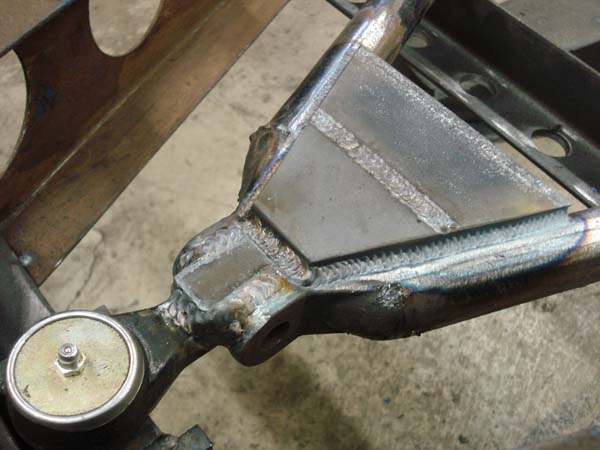

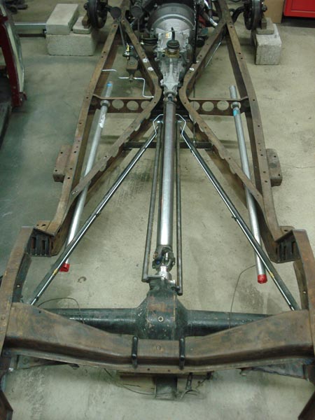

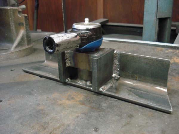

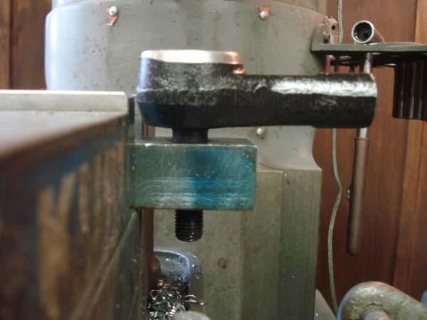

    After getting the engine/trans in place, it was time to hook everything up to the rear end. Obviously, using the T-5 meant I had to convert to open drive. A nicely made conversion kit from Hot Rod Works, and a custom driveshaft from Gilbert Driveline took care of that. The front ends of the rear wishbone needed a new home, so I welded them to a tie rod end, and fabbed a mount system with an appropriately angled mounting hole reamed in the center. I fabbed a couple of bolt on arms to eliminate rear end twist. I'm also going to do a little more gusseting where that tie rod end gets narrow.

  14. Nice fab work. What do you do if that tie rod end goes bad? Or am I seeing something incorrectly?

    Thanks.
    Cut, weld, repaint. I can't take credit for the idea. I've seen it done more than once before, so I'm assuming that a: it doesn't get quite the same stress as a tie rod end used in a steering situation, b: when the suspension moves from full extension to full compression (against the bump stops) that tie rod end pivots all of about two degrees, and c: let's be honest, most cars like this don't get enough miles on them to wear out tie rod ends. But no, your not missing anything. Replacing it would be a hassle.

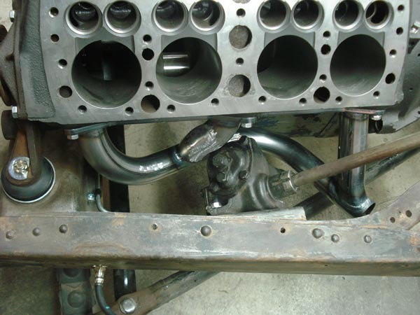

    Ran all the brake lines, fabbed some headers, and started running the exhaust. Oh, and that left side exhaust pic is deceptive. The center tube curves back in the right direction before it meets the header.

    Looks great! Can you explain the function of those 2 rods that run parallel to the driveshaft? Are they to take up the twisting force of the rear axle as load is applied from the driveshaft?

    Thanks. The idea is to regain some of the rigidity lost when I swapped the original torque tube set up for an open drive.

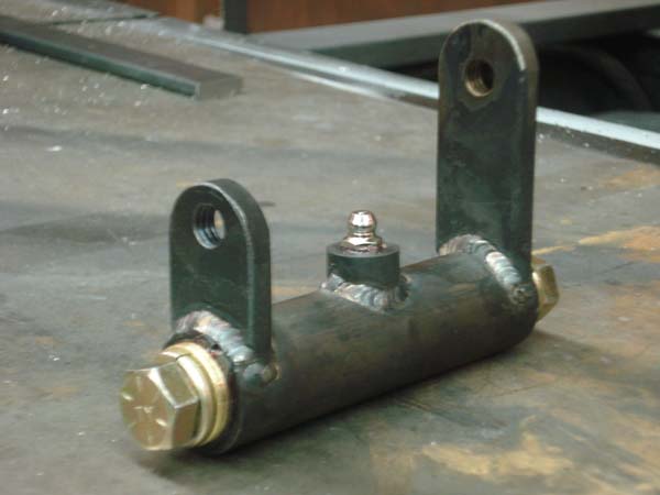

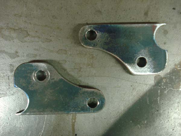

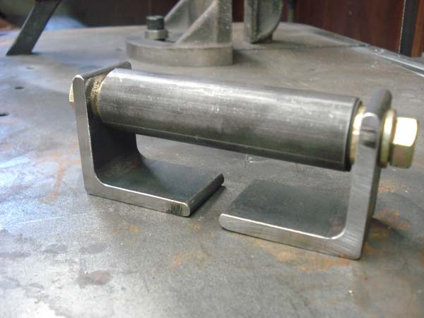

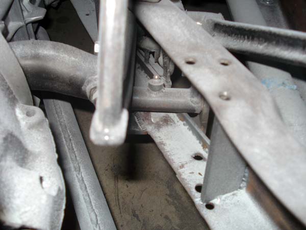

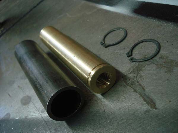

    Here are a few pics of the clutch linkage pivot that I made to get my pedal assembly to work with the particular clutch components that I've got. The frame had the prerequisite hole gouged in it for the juice brake pedal assembly. I've seen it done with a torch, but the previous owner of this car did it with a DRILL! That must've taken forever! This wasn't the easiest/cheapest way to do this, but I had some D.O.M. tubing and bronze rod leftover from an old job. The last pic is of the assembly welded in place and covered in body filler dust.
