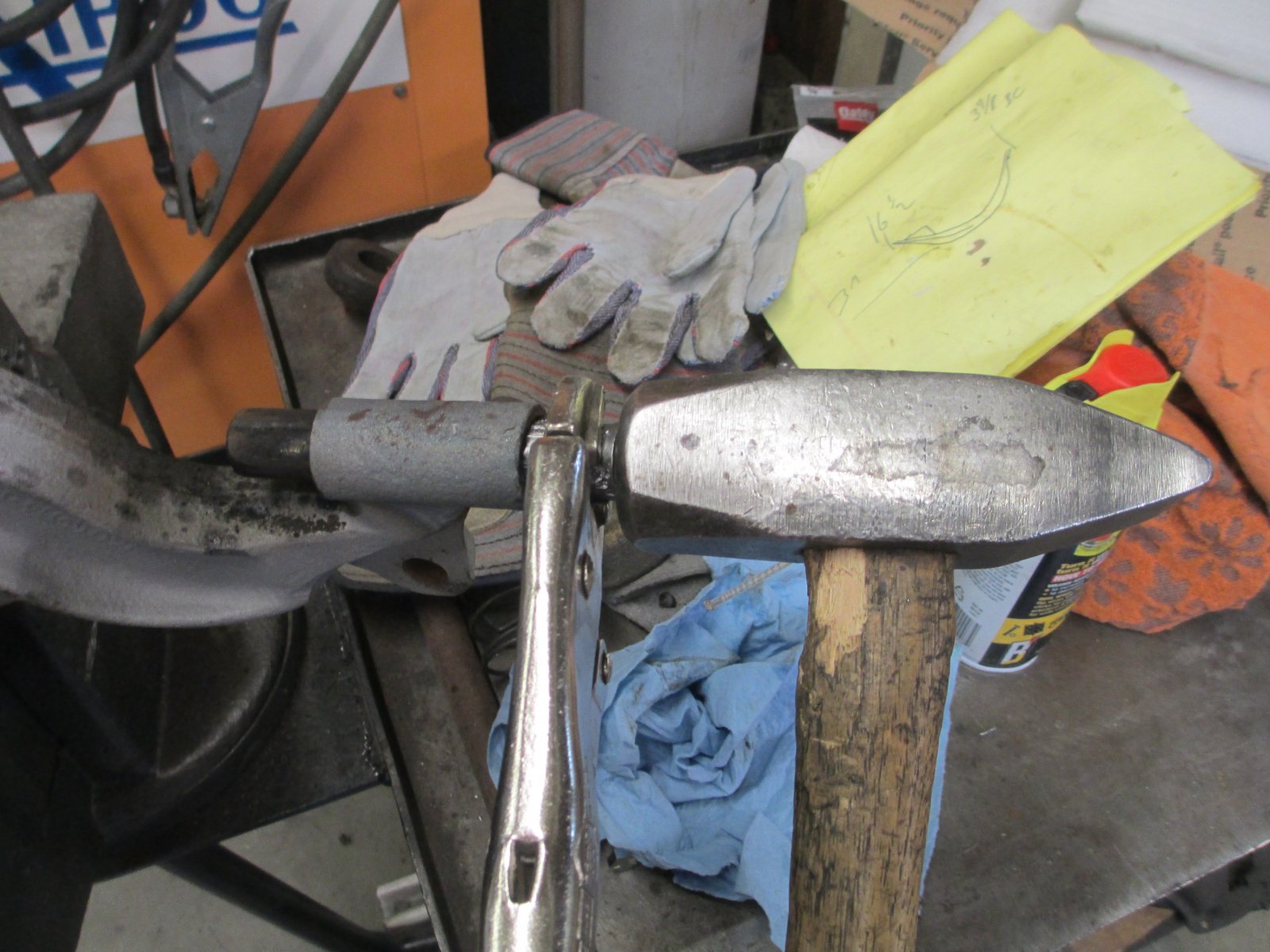

    They are 3/4", if you don't have a torch, take a hacksaw blade and wrap tape around it to protect your hand, and split the remaining sleeve and knock it out. I machined this driver, works great as well. IMG_8401.JPG IMG_8402.JPG
