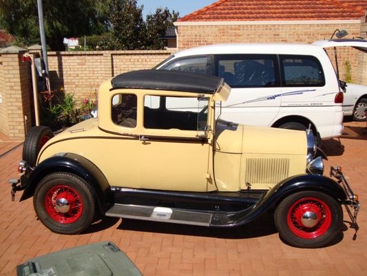

    I used a 35 axle last year on this phaeton and bought another for the coupe I’m building this winter.
    I think it gives an early 40s stance or close enough for not a lot of dollars. B81C4EB4-8771-41FC-9D46-B90977497302.jpeg
    I forgot, I also added 34 brakes to this one.
    The only thing I’m changing this time around is using 32 spindles instead of the stock model A.
    A little more room for bending the steering arm.

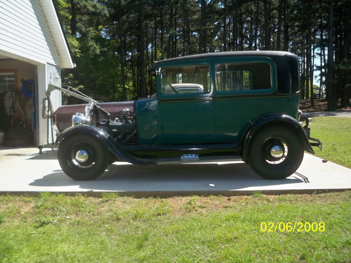

    Kickstarter likes this.
