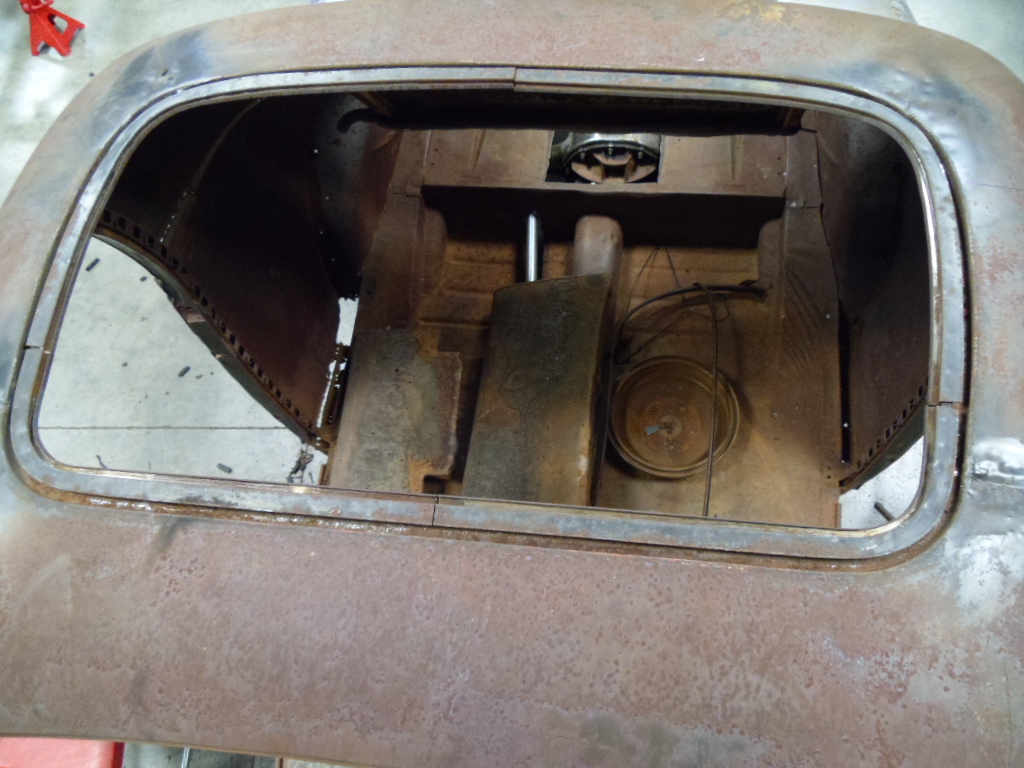

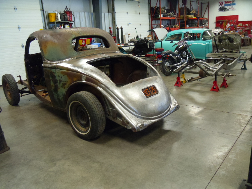

    I straightened the welds on the tailpan today. I also made the bottom corner pieces in the gutter and welded them in. I put the licence plate back in to see how it looks. I have been checking to make sure the decklid skin still fits from time to time

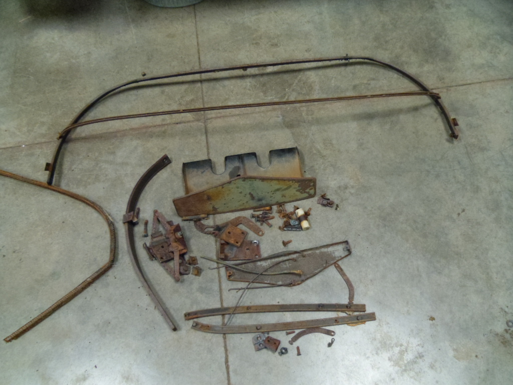

    I got the windshield frame taken apart and I got all of the rubber out of it. I am prepping parts before the car gets sent to the blaster

    I have been inch-worming along. I have been prepping parts for the blaster. I got the headlight off of one fender and I blasted the pedestal and the bracket. I got all of the rubber bumpers out of the garnish moldings. I also got the sunvisor brackets off of the header panel.

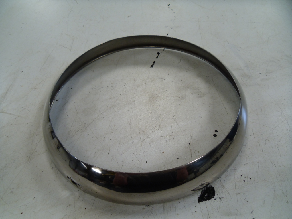

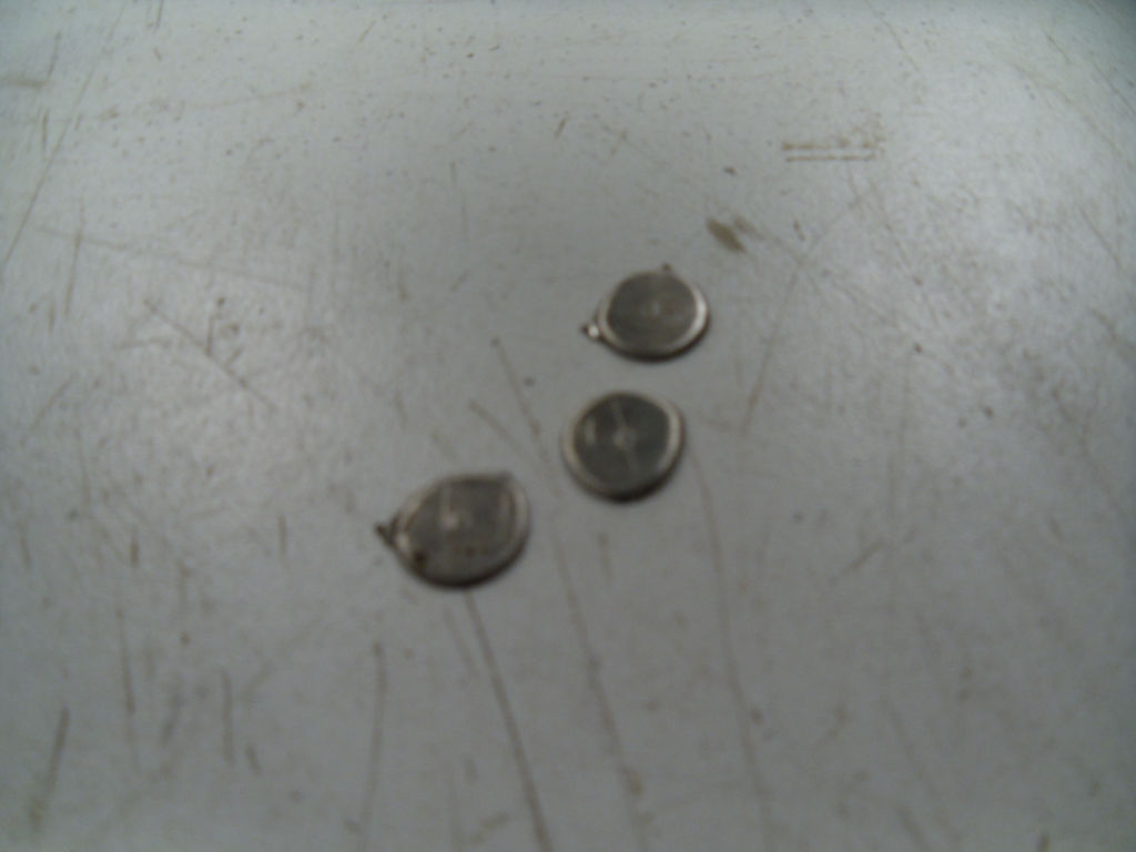

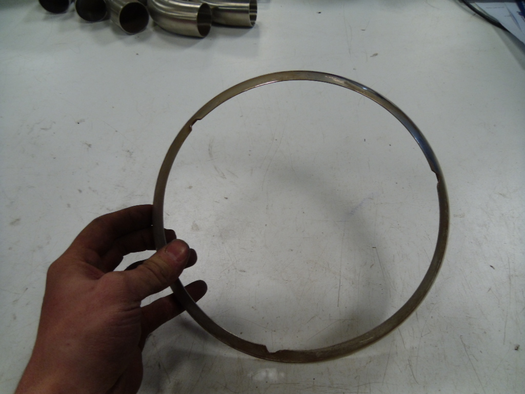

    Here is a little side project I have been working on with the help of Gene. The headlite rings on my car had seeled beam conversions on them. So the original rings had 3 holes drilled through them. I punched out some stainless and then TIG welded them in. I ground and sanded the welds and then I buffed the ring. It's not perfect but it isn't bad. Now I just have to do the other one.

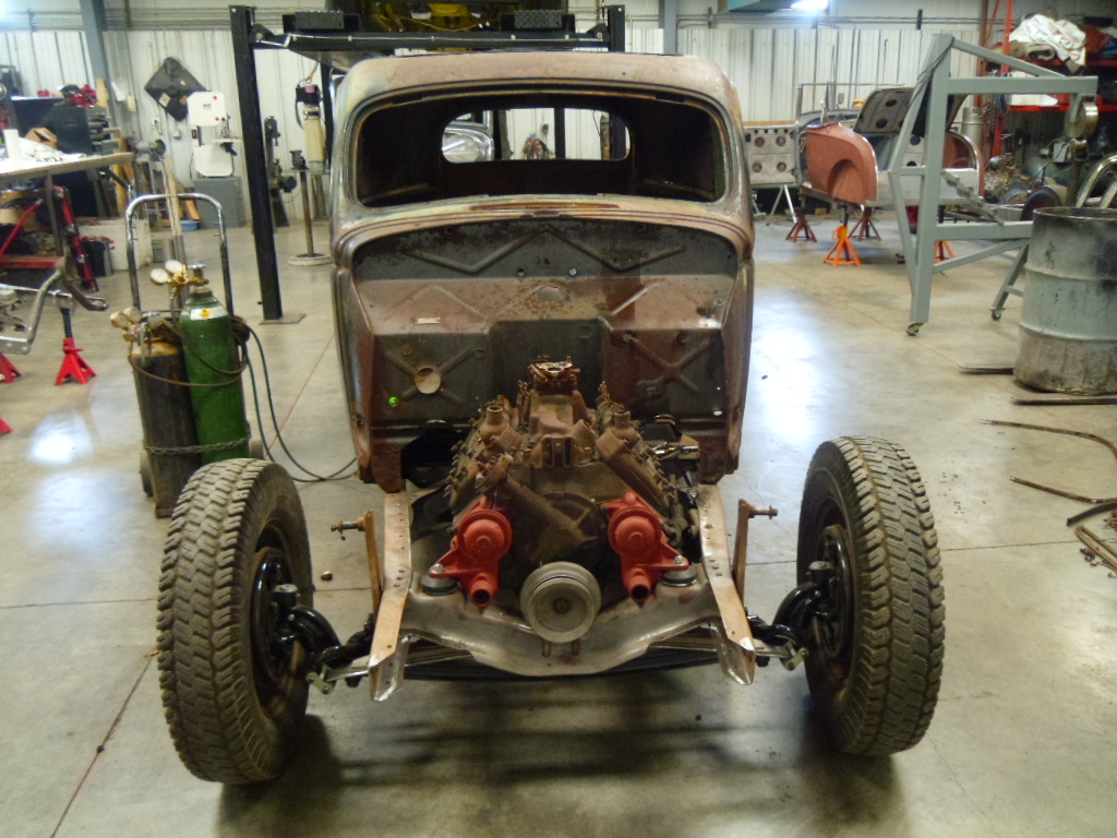

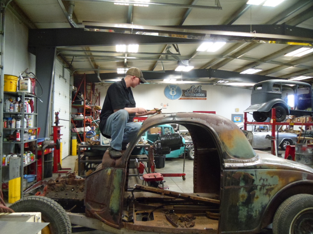

    Today I got the car into the shop at work. I took all of the tackstrips out, all of the screws out of the firewall, the cowl vent. I also took the door hinges off and the door striker plates. The body is almost ready for the blaster now. All I have left is the seel from the roof insert.
