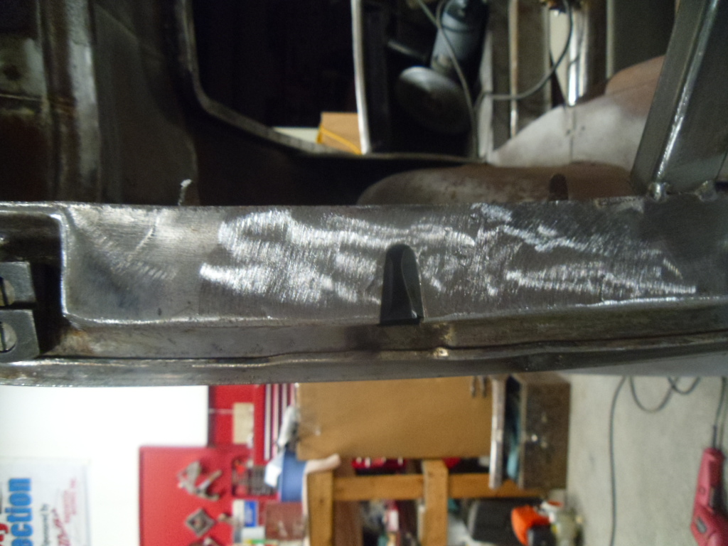

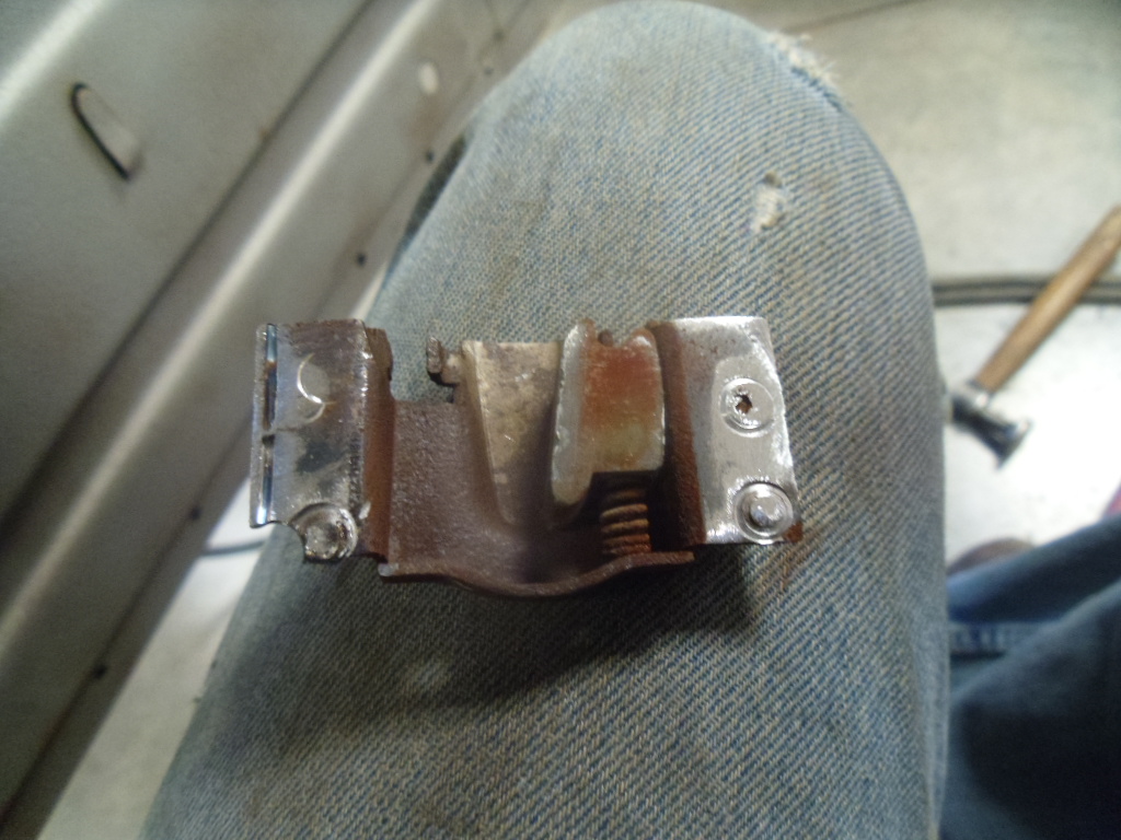

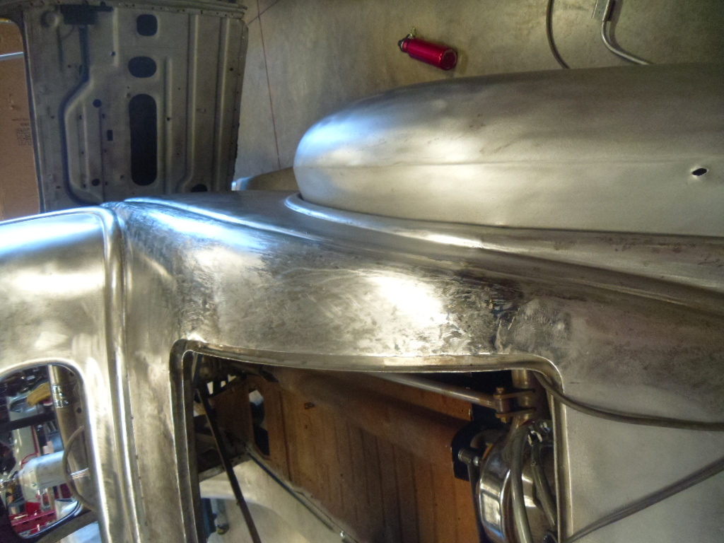

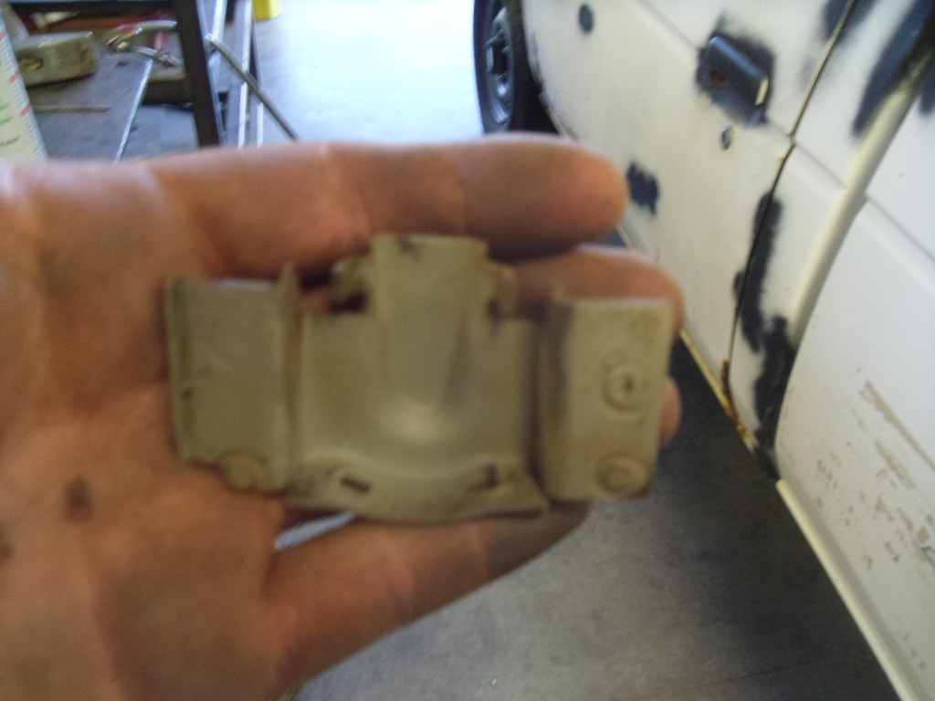

    Gene started to pick and file the upper part of the quarter. Its looking better now. I fixed the sheet metal around the striker where it was wore down. I fixed the rust in the the door jamb. I also took the female dovetail out and fixed it and put it back in.

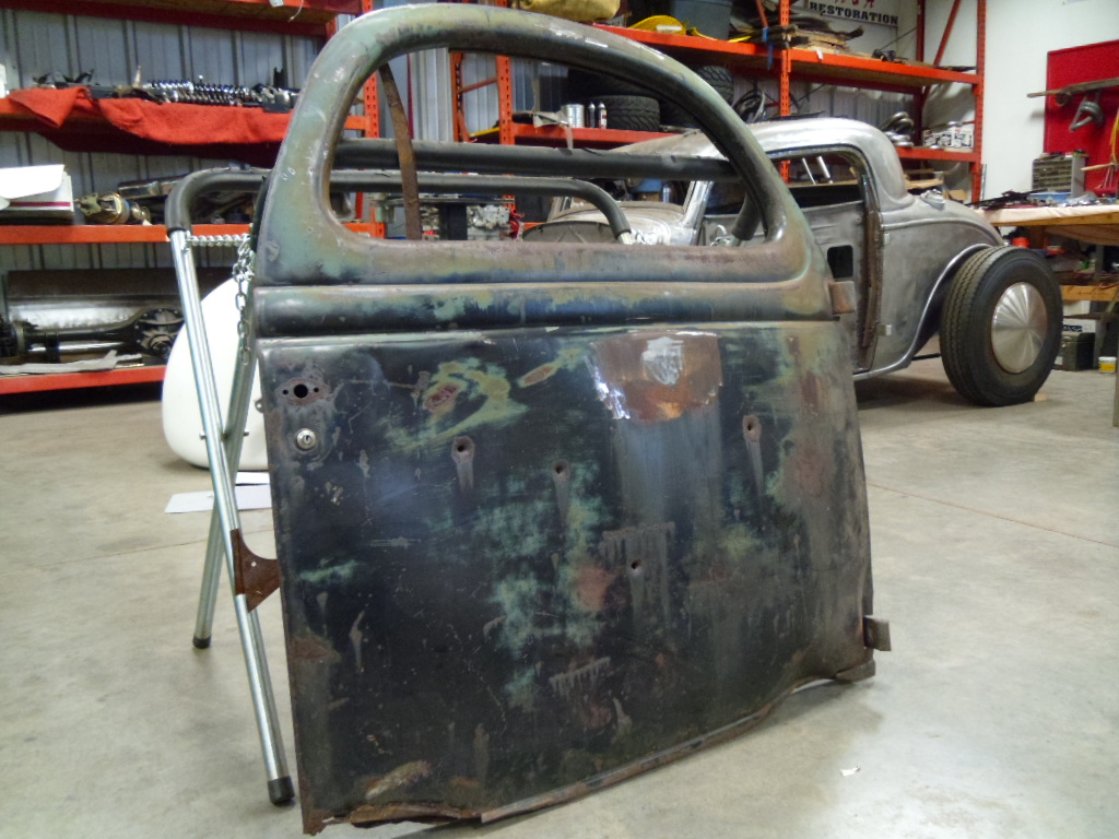

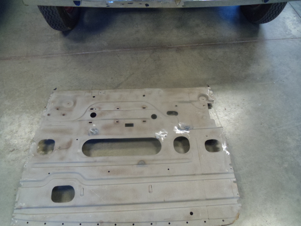

    Today I fixed all of the bullet holes in the inner door panel and a crack. I also replaced the lower corner of the inner panel. I cleaned the inside of the door skin. I pick and filed the upper part of the door. Gene helped me out with shrinking the lower part of the door with the shrink disc. I replaced the lower foot of the inner structure but the picture turned out bad of the finished product. I now have the patch panel ready to go on.

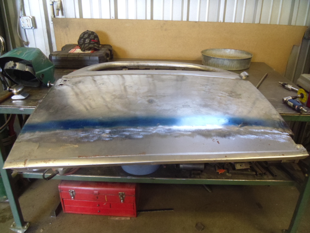

    I welded the door patch on today. It is roughed out now but still needs some straightening.

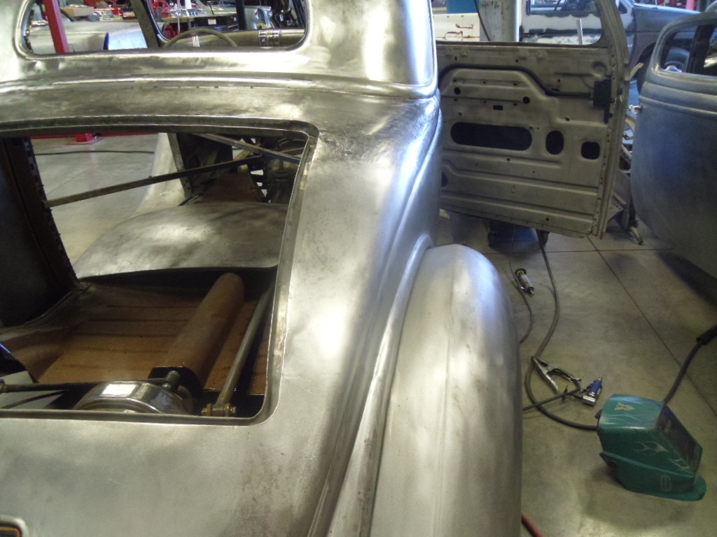

    I straightened the quarter panel tonight. It came out good but its not perfect. Sorry about the ****py pics lately the screen went out on my camera so i have to use my ipod for 2 to 3 weeks. Once i get my camera back i will get some better pics for you guys.

    I straightened the beltline area tonight. I am done with the body on this side other than straightening the roof. I am going to start on the drivers side tomorrow night
