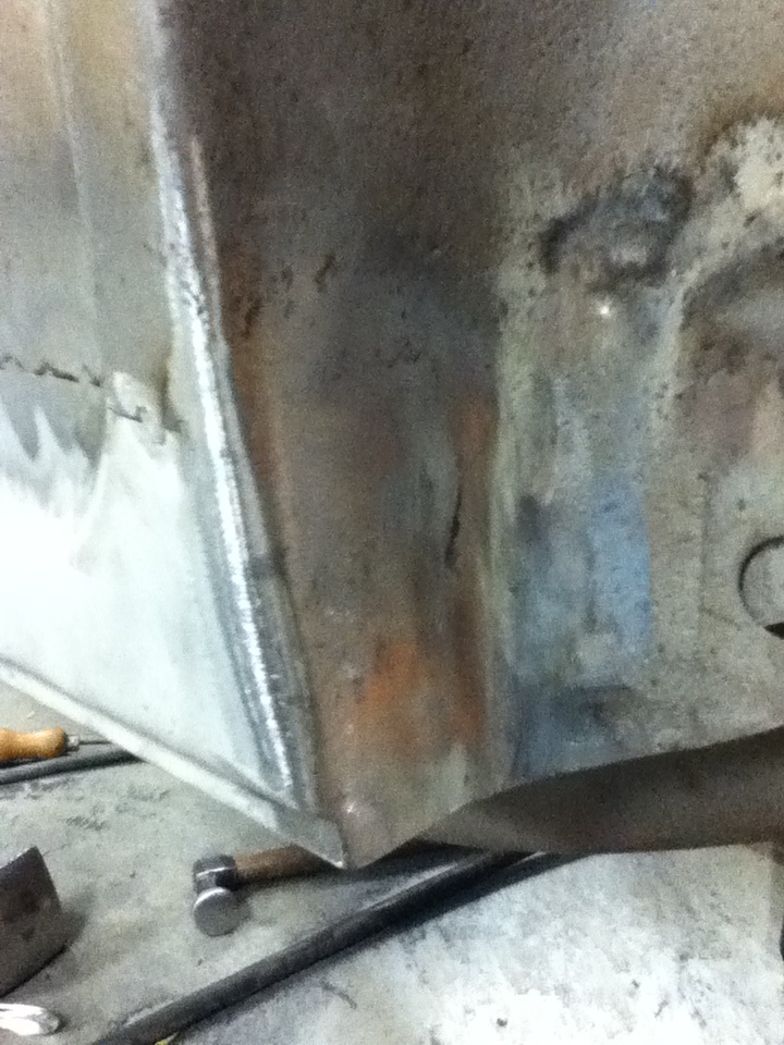

    Here are pics of all the damage on the drivers side. B pillar is better but the A pillar is rough. The entire a pillar was twisted and the door jamb was smashed and twisted. Gene got the pillar straight and then I cut the door jamb sheet metal from my parts car and welded it in.

    Last night I cut the sheetmetal off of the quarter and the cowl. I built up the sheet metal by the latch. I fixed the rust in the wheel well and I clearanced the sheet metal around the shock mount. I also cut the floor out.
    Today I fixed the base of the A pillar. Replaced the front of the rocker. Fixed the D-nuts. Made the bottom of the A-pillar. And i bolted the hinge on

    I got the rocker welded in today. I also patched the bottom of the b-pillar. I patched the subrail behind the b-pillar on the inside and outside edges

    tonight I got the quarter patch tacked on. I made the door jamb and got that welded in. I also fixed the rust in the wheel opening.

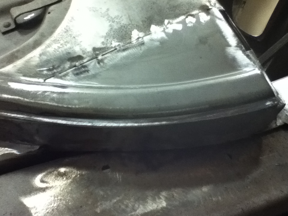

    I fixed the front foot of the cowl tonight.

    Made the door jamb on the cowl tonight. I tacked the cowl patch on and I made the bottom of the cowl patch and welded it on

    Welded up the cowl and quarter patches today
