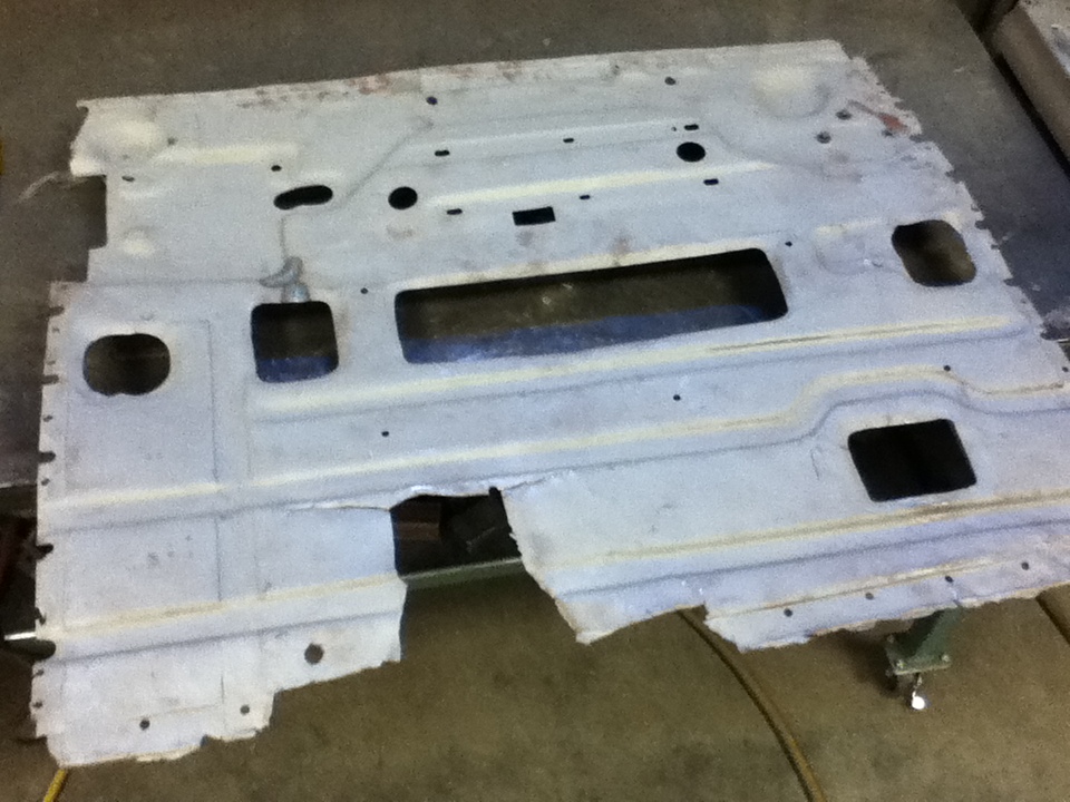

    Last night I pick and filed the upper skin from the 3-window door. Tonight I welded the inner frame together. I then twisted and tweaked the door to get the front gap close. I then shimmed the cowl to get the beltlines to line up close in the rear. I then plasma cut the top of both doors off. I ground the edges to where I wanted them. I cleaned up the rust on the inner and outer. I then put a heavy coat of paint on them. I then tacked the 2 together. I will weld it up tomorrow night

    tonight i welded the door top on. I TIG welded it from the inside. I also folded the hemmed edge over on the top of the door

    Outstanding job on that skin splice! I had thought you were pretty brave cutting it right on the style line, but that worked great tigging it from the back side...nicely done.

    Last night I replaced part of the upper door that I wasnt happy with.

    Today I realized that the back edge of the door had a different curve from the quarter. Uppon inspection we realized that the inner fram had a different curve than the 3-window did. I cut that piece out and replaced it with the original from the 3-window. I also got the lower door patch welded on. I will finish straightening the skin tomorrow.

    Today I pick and filed the whole door skin. I repaired the bottom foot on the door frame. I painted the backside of the door skin with POR. I started to repair the inner panel.
