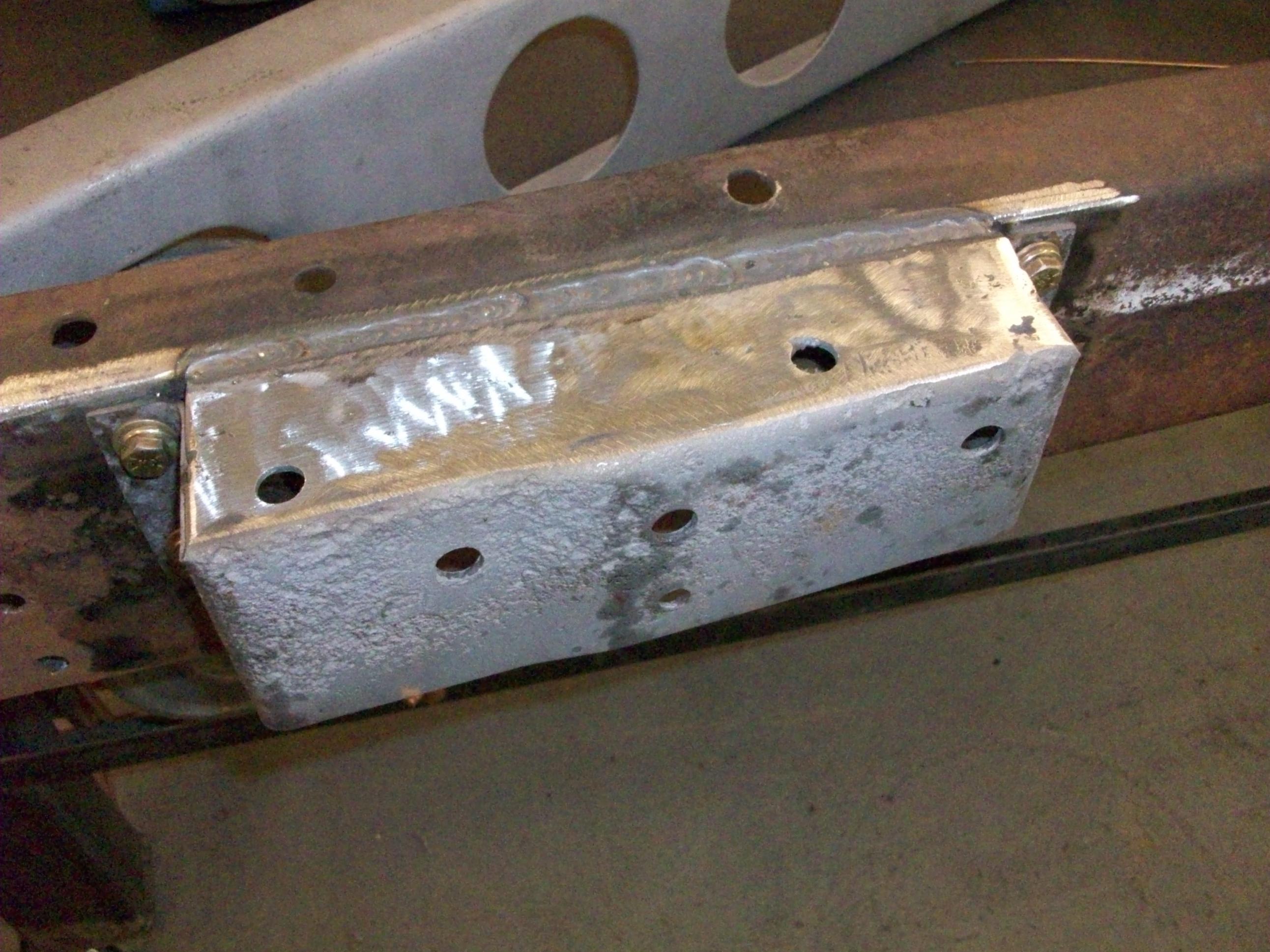

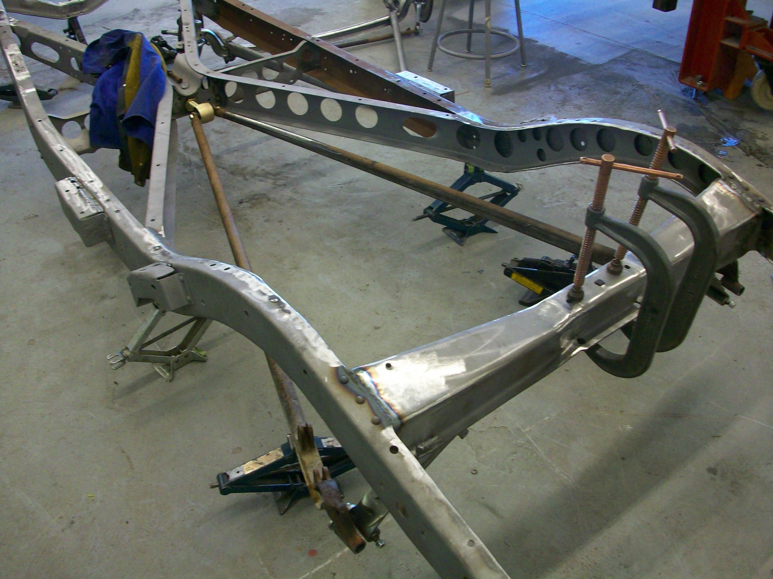

    The frame is off of the frame bench now. Yesturday I fixed the one body mount that was rusted heavily. This morning I spent some time with a die grinder cleaning up the under side of the crossmembers to make sure that there is absolutely nothing that can dig into the springs.

    Nice work. Paying attention to the details is going to really add up on this car... should be pretty awesome.

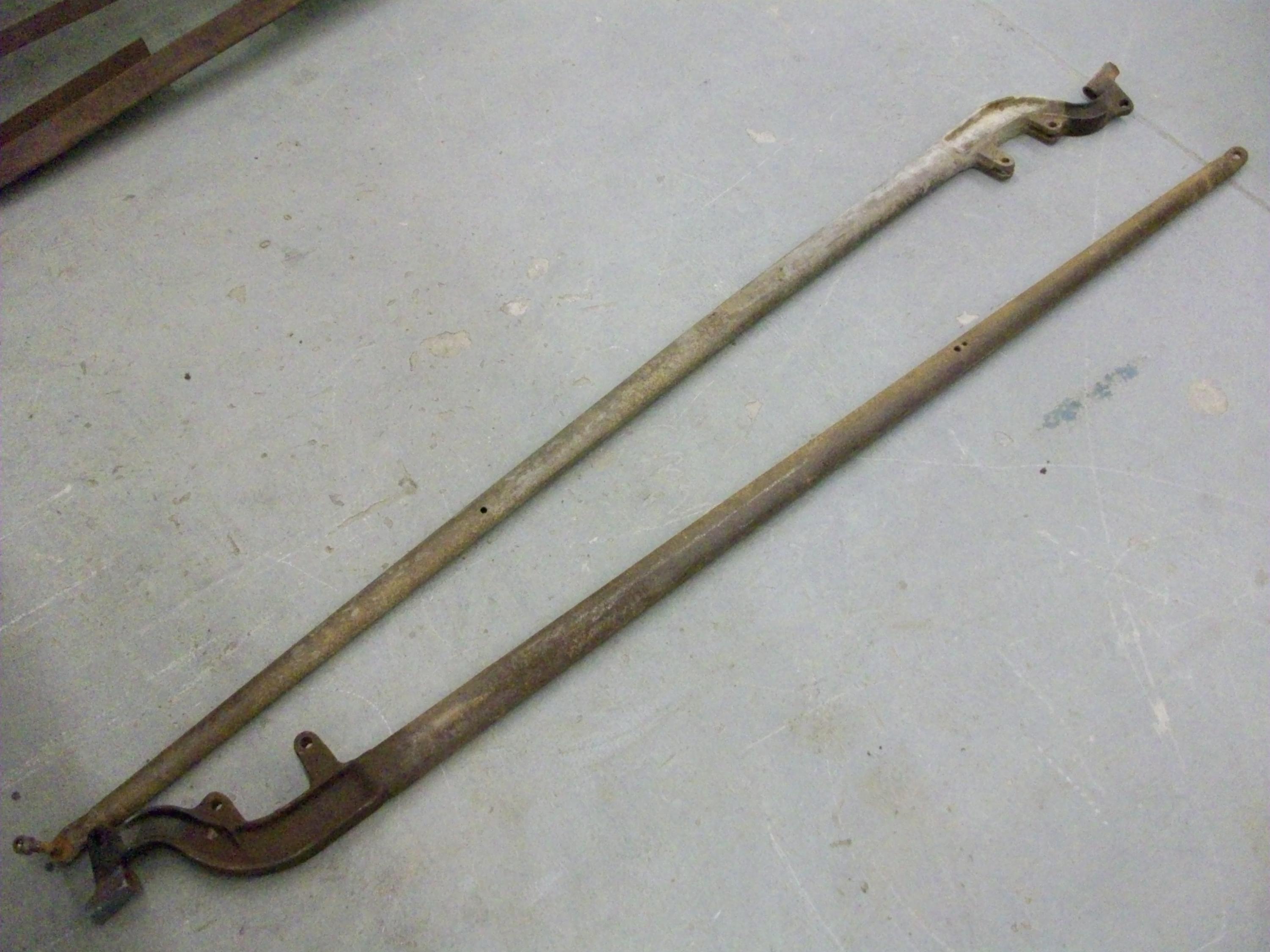

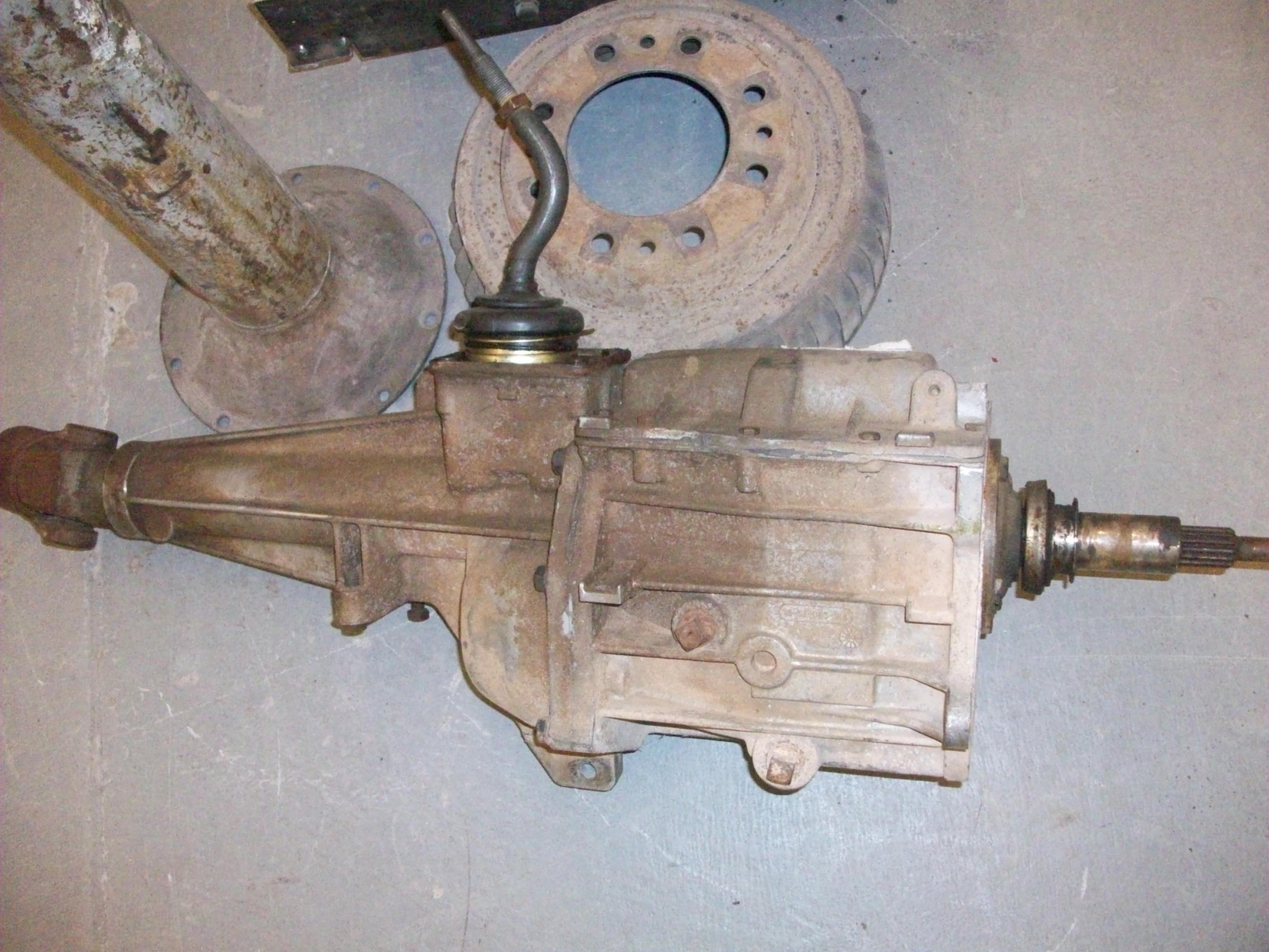

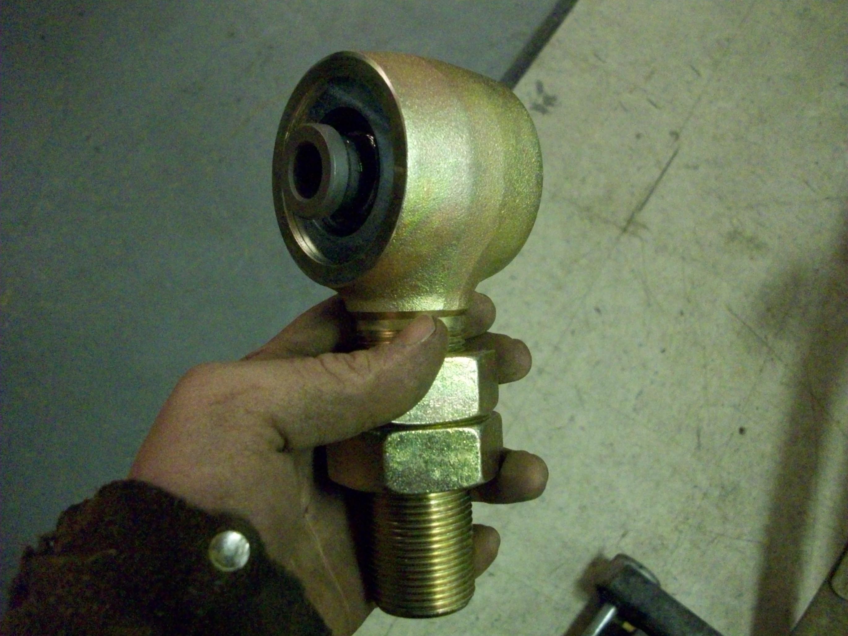

    I got my 5 speed today thanks to some trading. I am going to be using a '57 Ford 9 inch rearend. I am going to use the transverse spring and the original bones attached to a Johnny Joint.
    mgtstumpy likes this.

    Cool another build thread. Great work so far. I like it that your repairing the frame and not looking to just replace it. Nice work

    that's one hellofa joint!

    Yes it is! it should last much longer than a heim joint and if I ever have a problem with it, it is completely rebuildable.

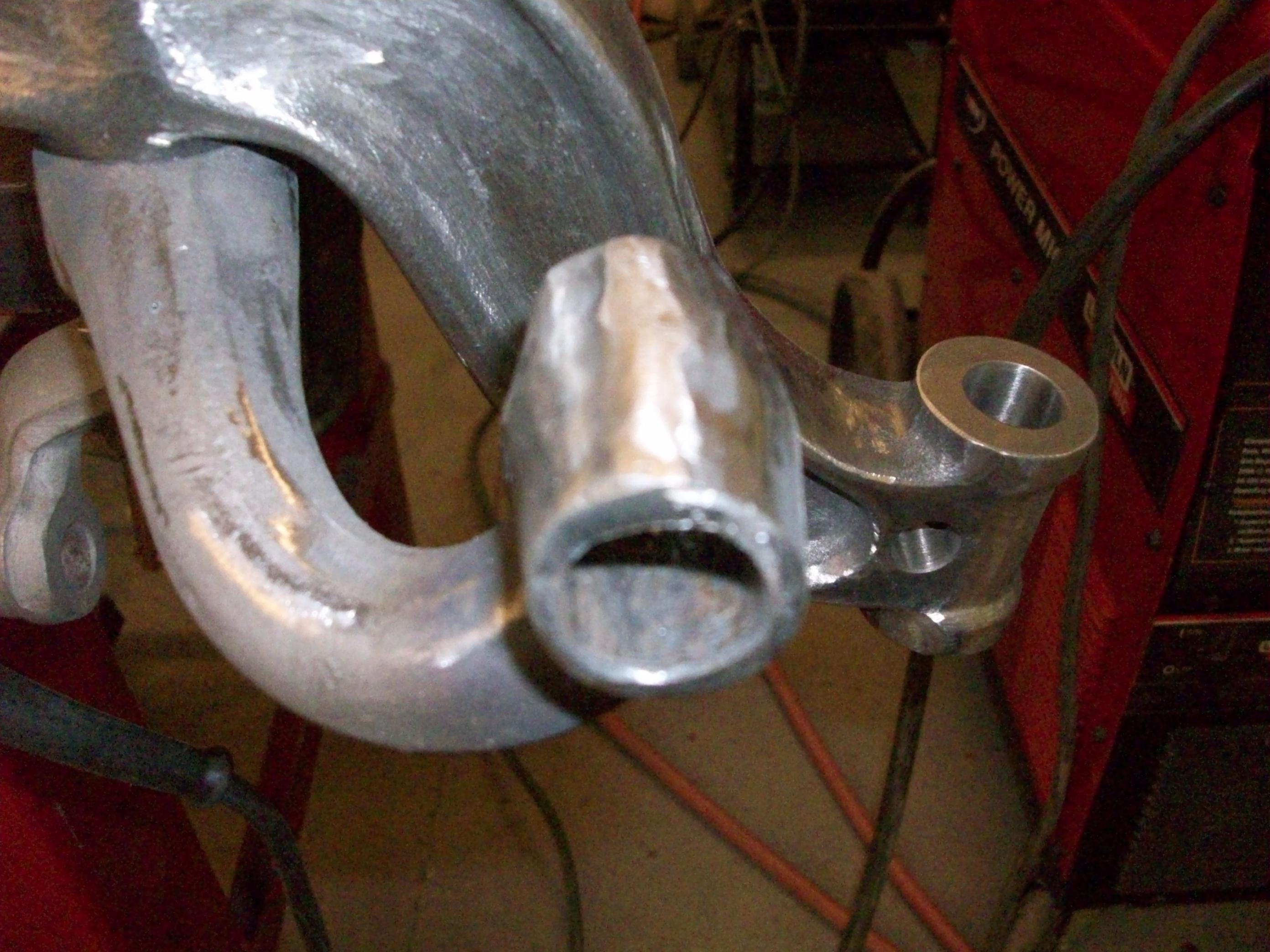

    This morning I fixed my front wishbone. The busing holes were slopped out. I cut the bad sections out. Then I put a corredt OD piece of br*** through the hole and welded it up.

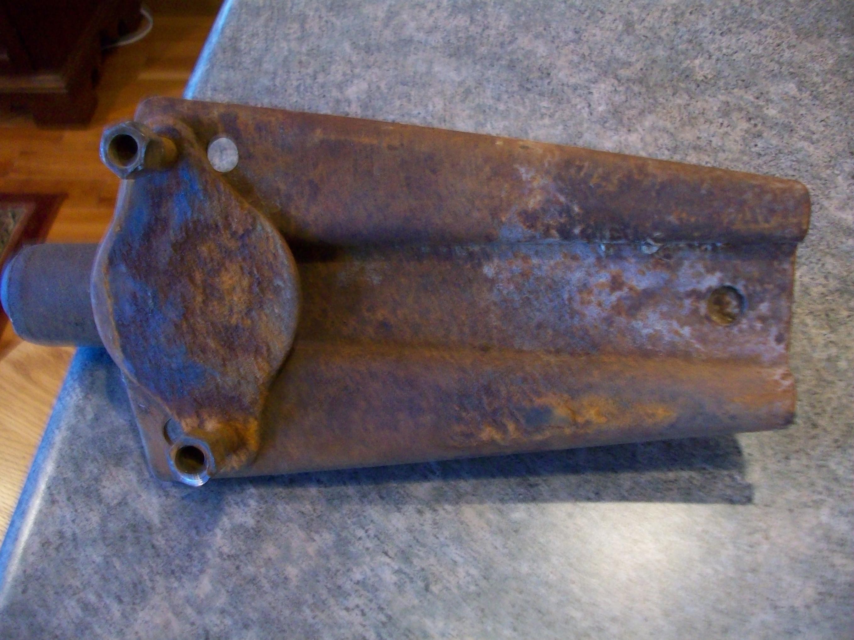

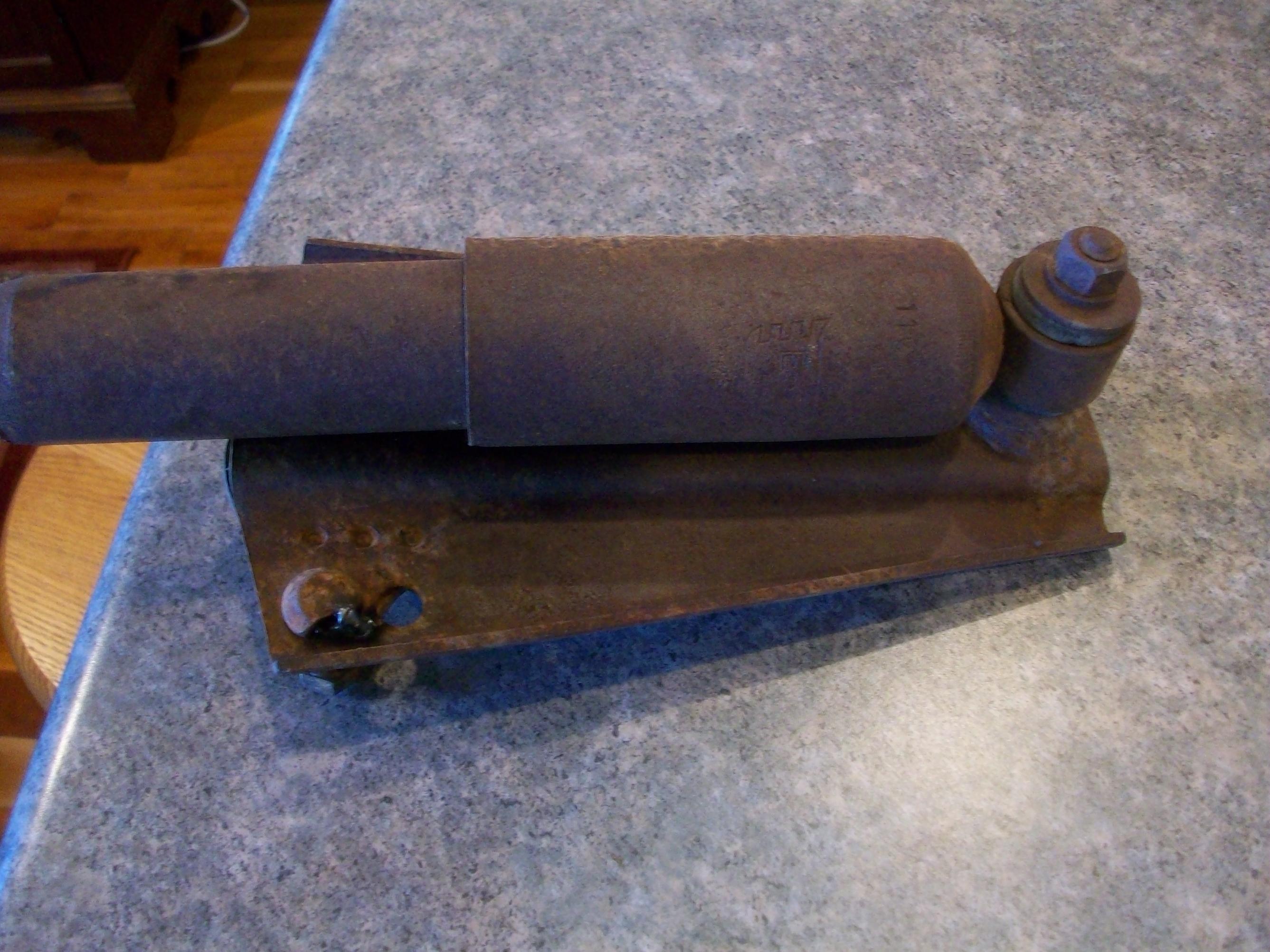

    I painted some front end pieces this weekend so that I can ***emble them this week. I got these neat old shock mounts from my teacher today.

    Are those shock mounts for the front or rear. I've got a pair of the fronts if you need.
    Nice work. Jake

    These are for the front. Thanks anyways

    That Jonny Joint should handle the flathead no problem.
