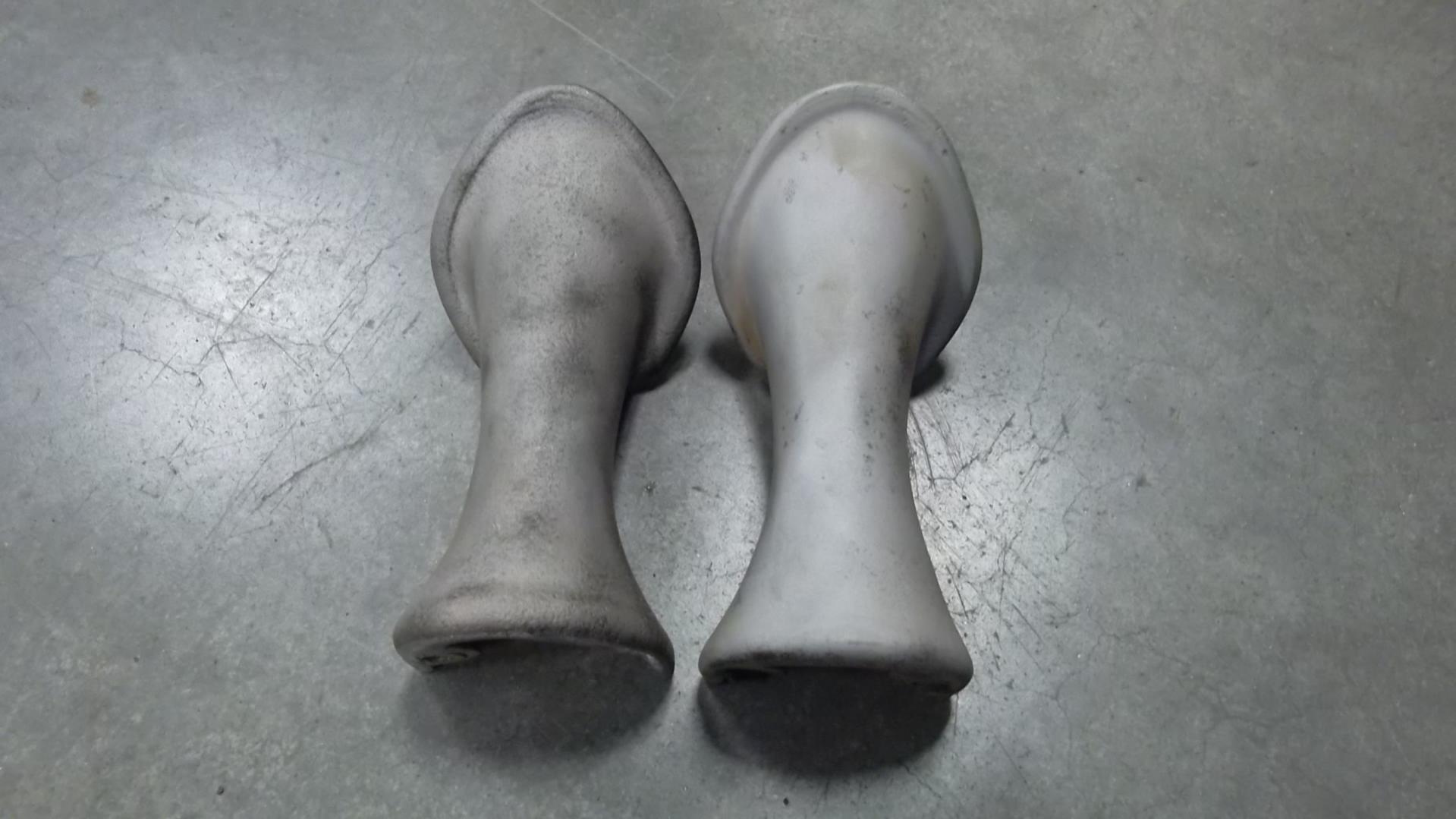

    Yes it did. I dont know if its any good though. I need to figure something out for a fan though

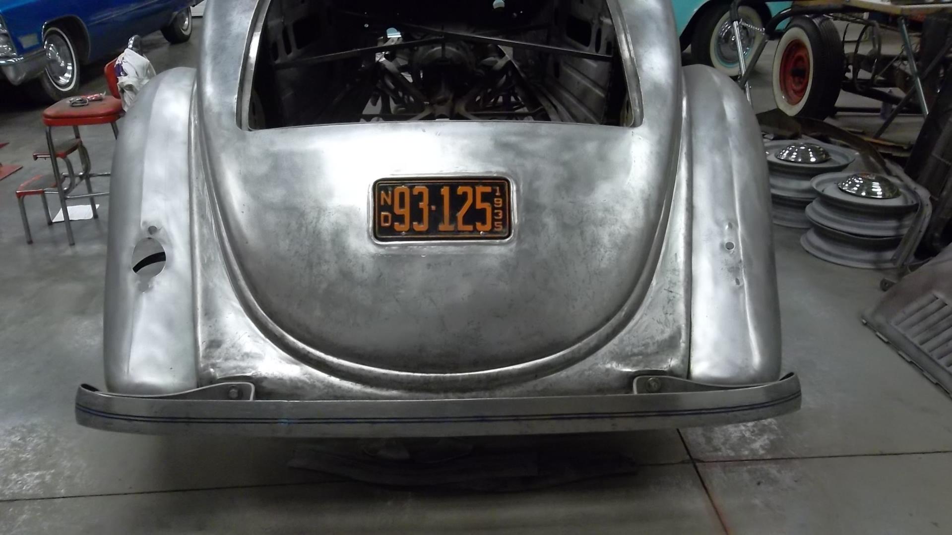

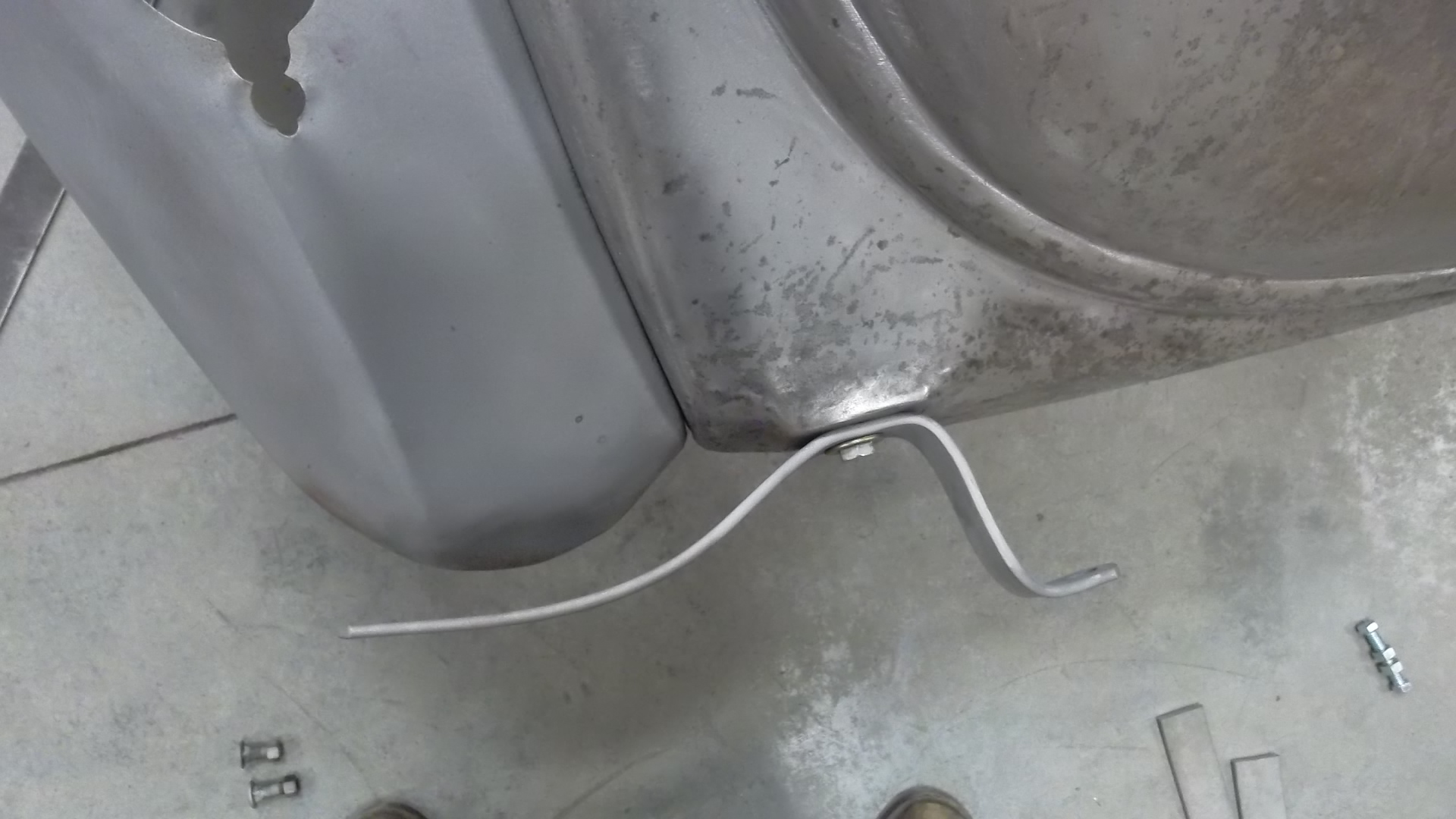

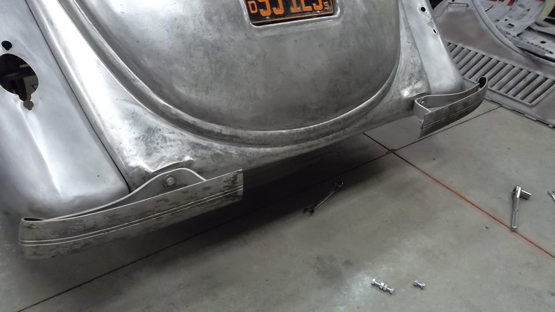

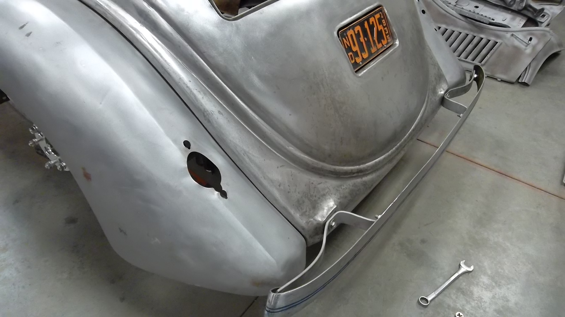

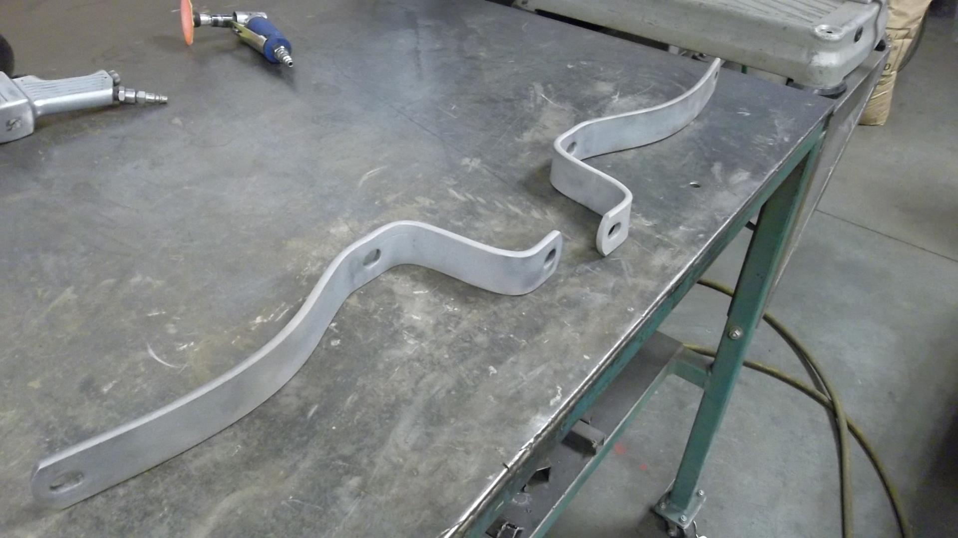

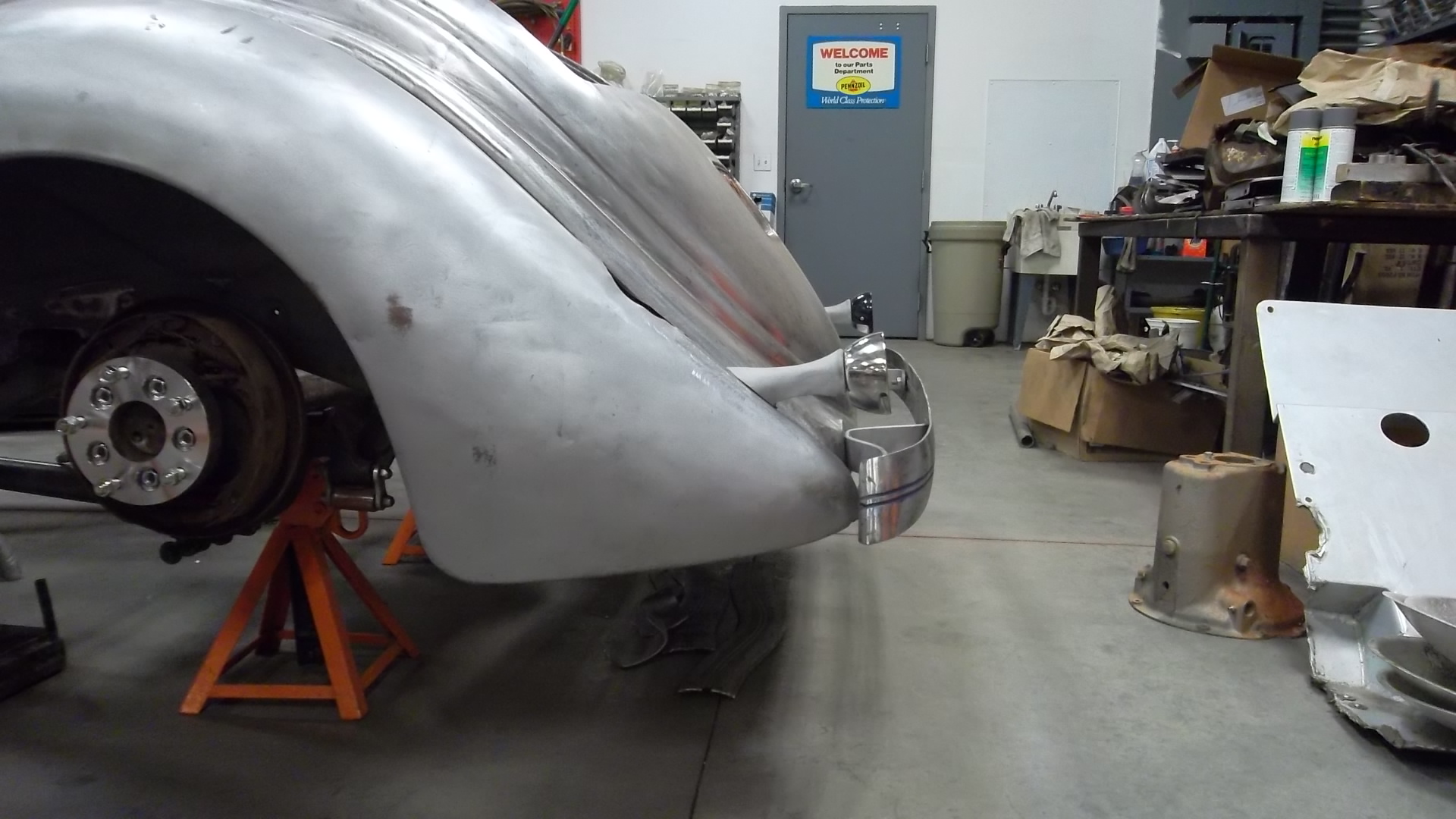

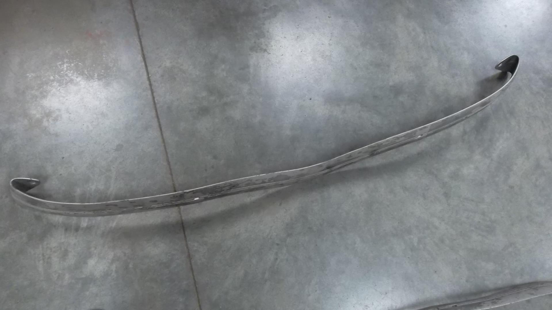

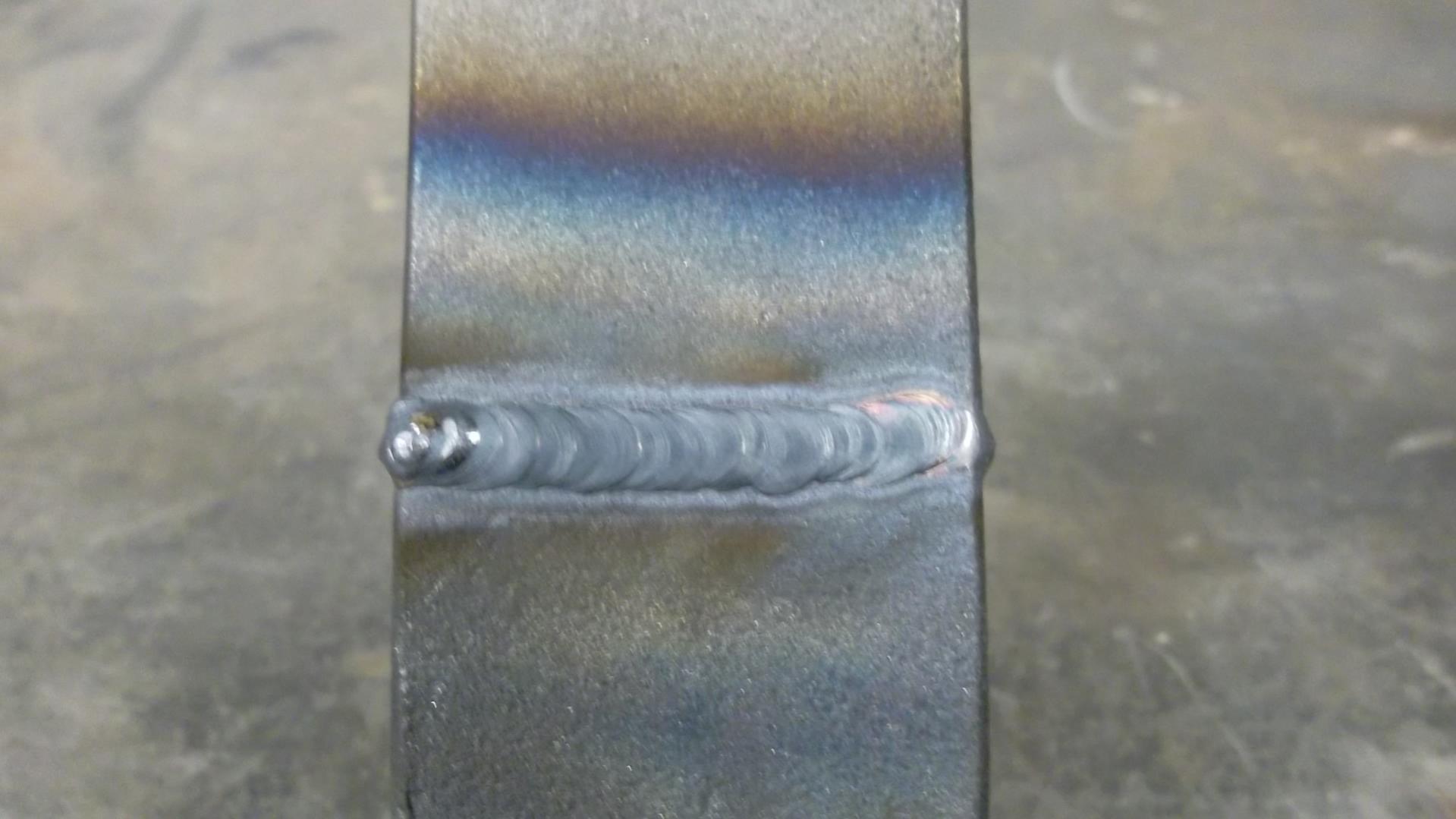

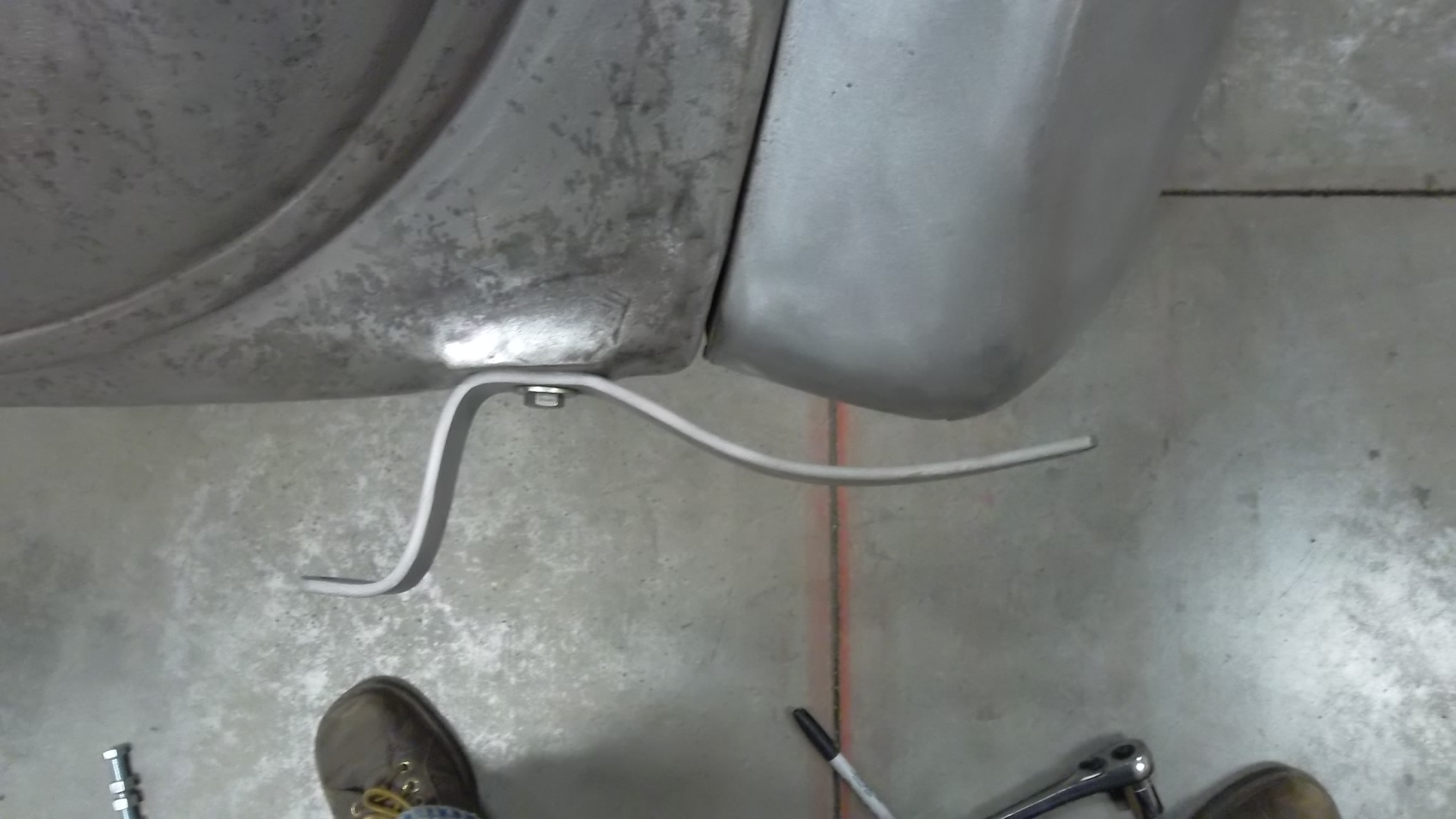

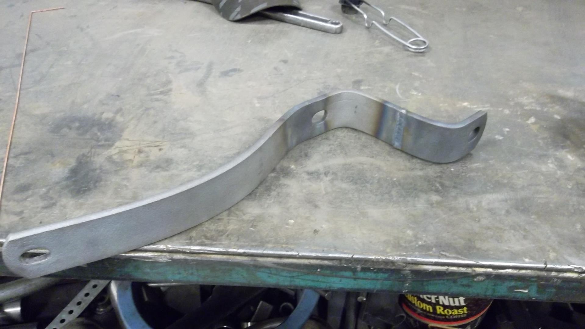

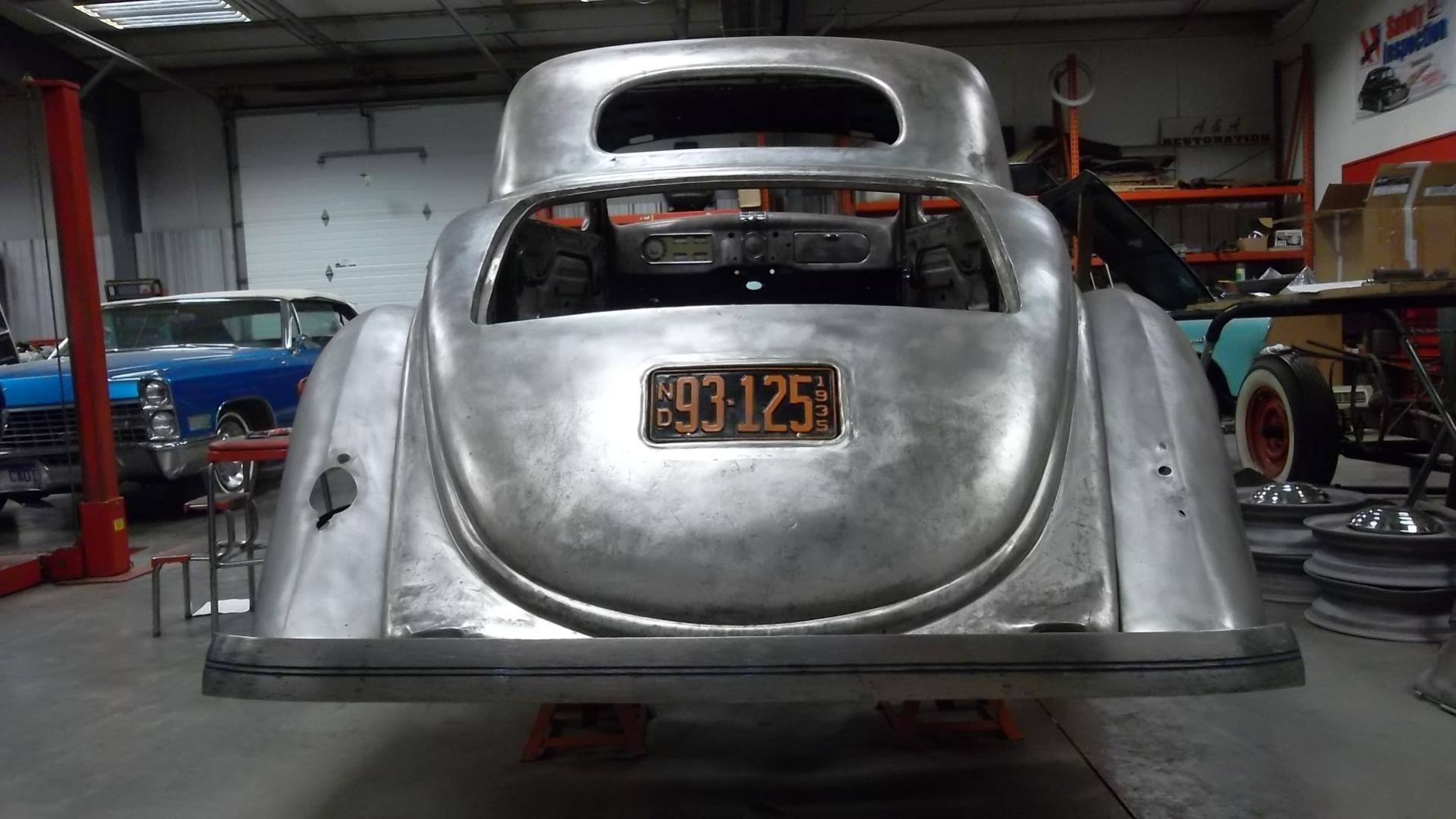

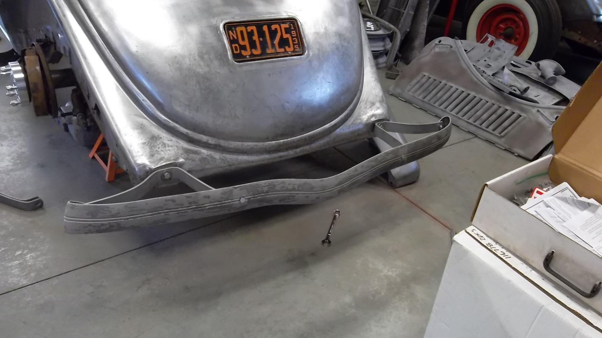

    last night I started playing around with the back bumper. The first pic shows the stock bumper with stock brackets. I knew I wanted it closer to the body but after staring at it for a while I wanted to get rid of the dip in the middle since it did not flow with anything. I first straightened the bumper which is in the second pic. I then de-arched the bumper since it had too much curve for my tastes which is in the 3rd pic. I then modified the brackets. I cut 5.5 inches out of the straight part of the bracket. In the fifth pic you can see that I heated and bent the bracket on the left side. This served 2 purposes: first it pulled the bumper back, second it made the bracket follow the curve of the fenders better. I then cut the center of the bumper out. I had to de-arch the 2 sides more. I then cut straight pieces out of the 2 sides of a spare bumper. I then flatened my filler pieces and welded them in. I then flat filed the entire face of the bumper

  5. The heater is a 48-50 truck.

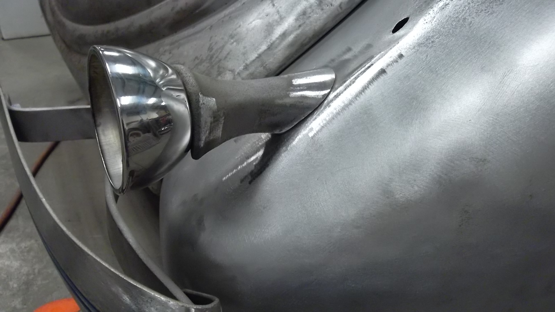

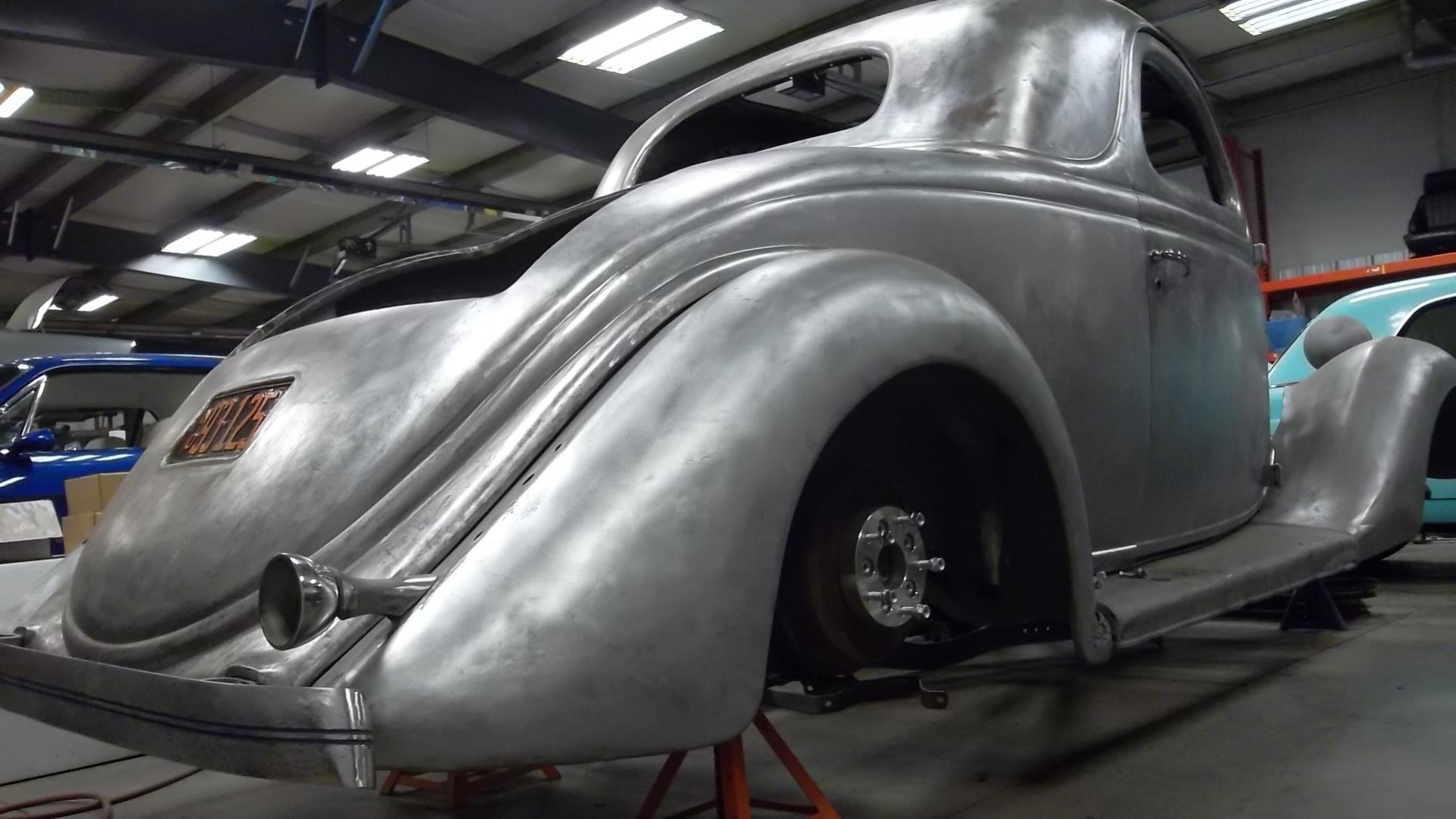

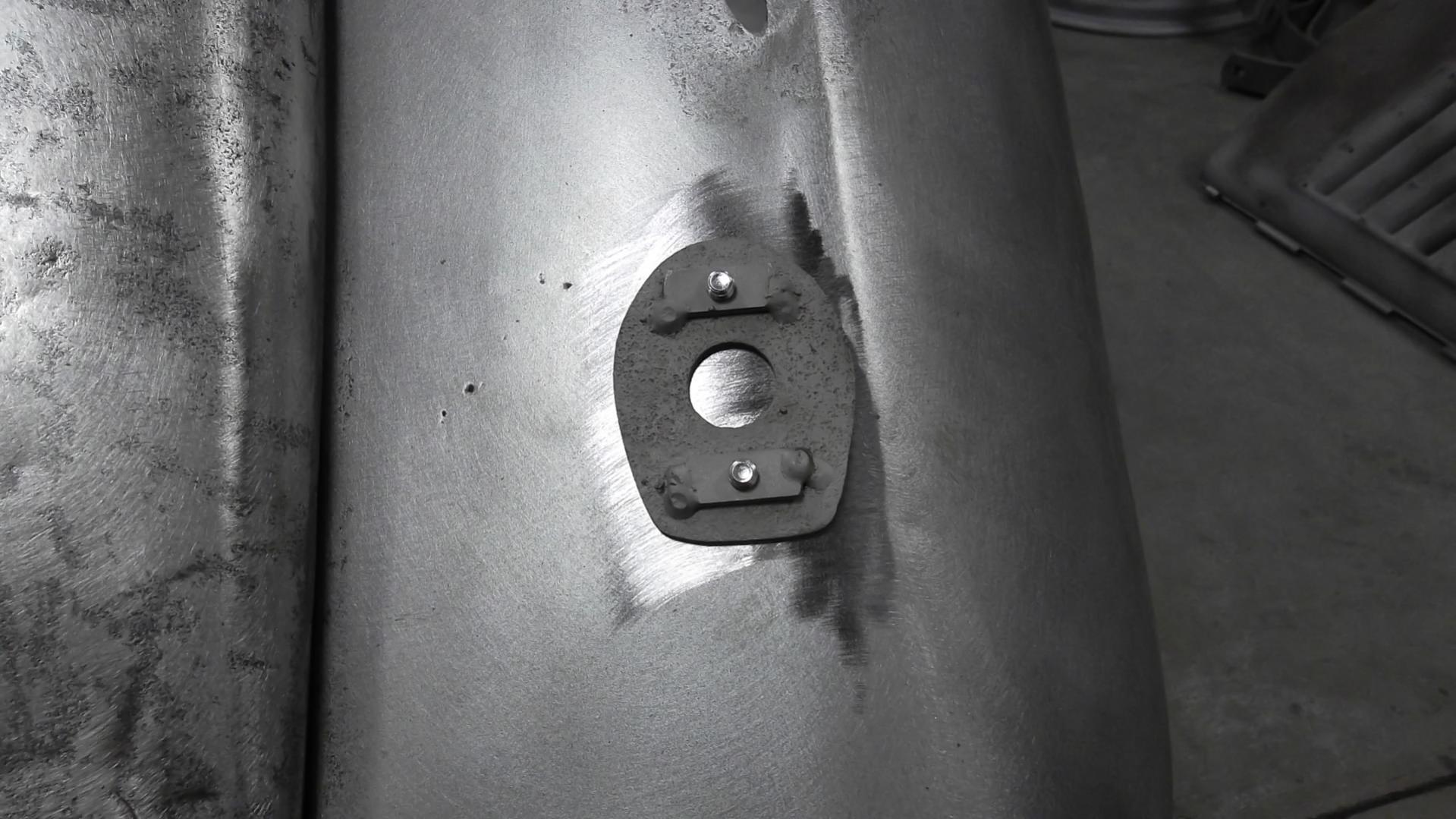

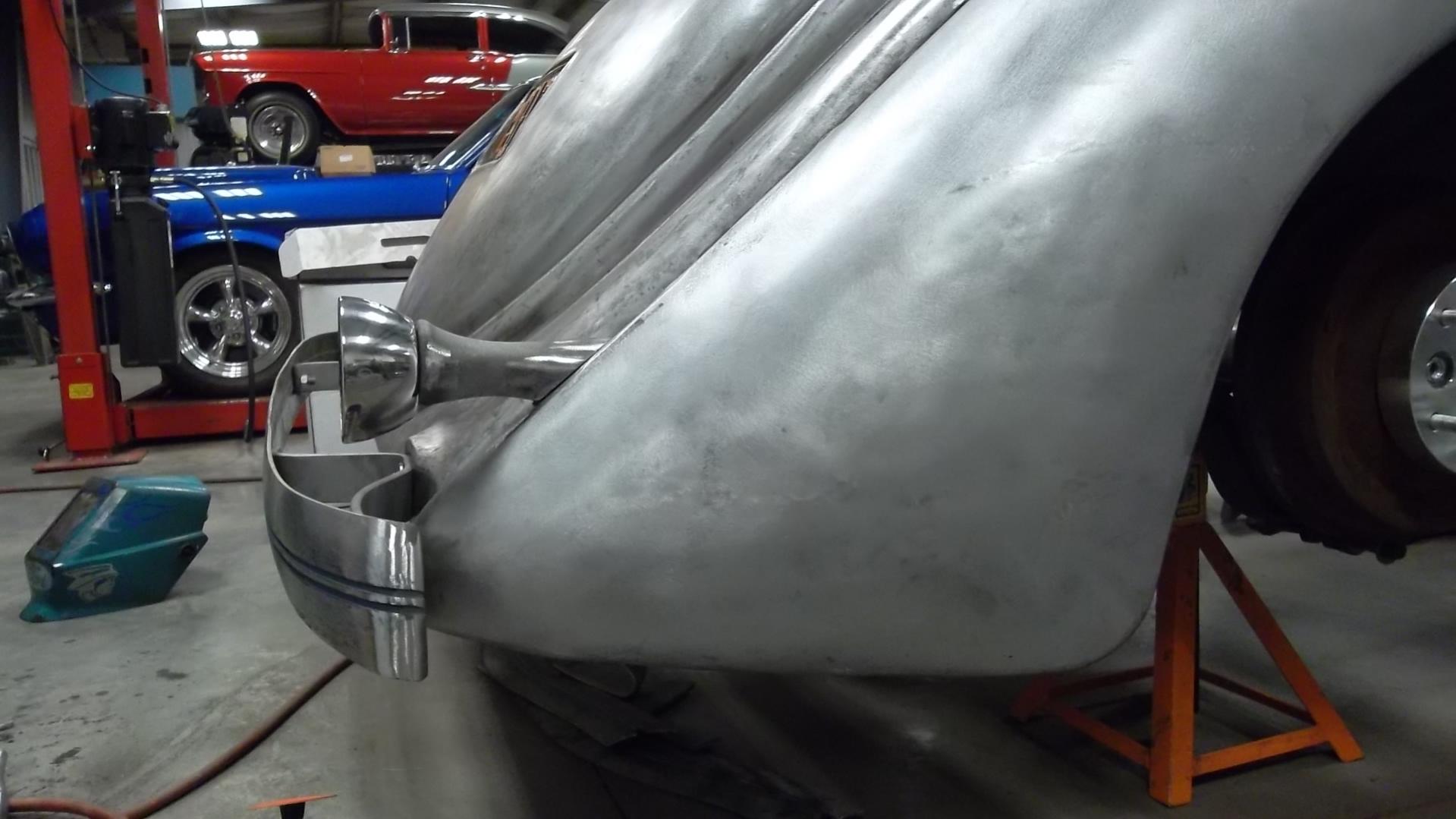

    The decision was made today to use '34 tail lights. I got a set thanks to Gene. The stand didnt fit the fender where I wanted to put it. I didnt want to modify the fender because I wanted it to appear the tail light was made for the fender. I cut mounting plate for the tail light stand off. I cut it to the shape I wanted. I then bolted it to the fender. Next I ground the tail light stand to get it to sit right. I then welded it all up.

  13. banditomerc
    Joined: Dec 18, 2005
    Posts: 2,521
    banditomerc
    tailights look out of place.just my 2 cents

    Looks cool!!!:cool: Custom!!!! Dare to be different!!!!

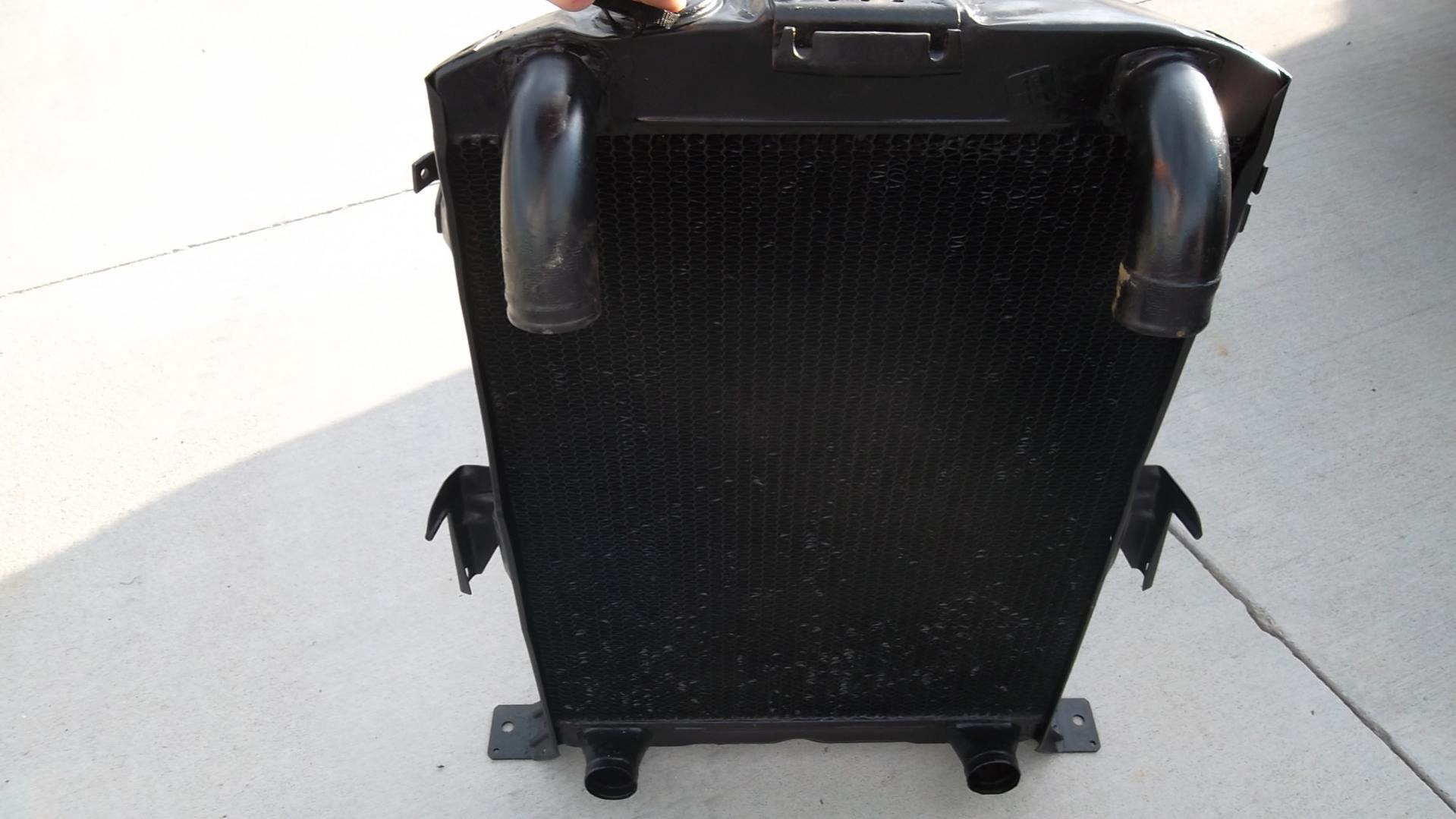

    I got my radiator back from the radiator shop. It got boiled and pressure tested and then the guy was kind enough to through a coat of paint on it

    Can't tell from the pics, can you use a pressure cap ? Or is it the old let her boil over type.

    let her boil over

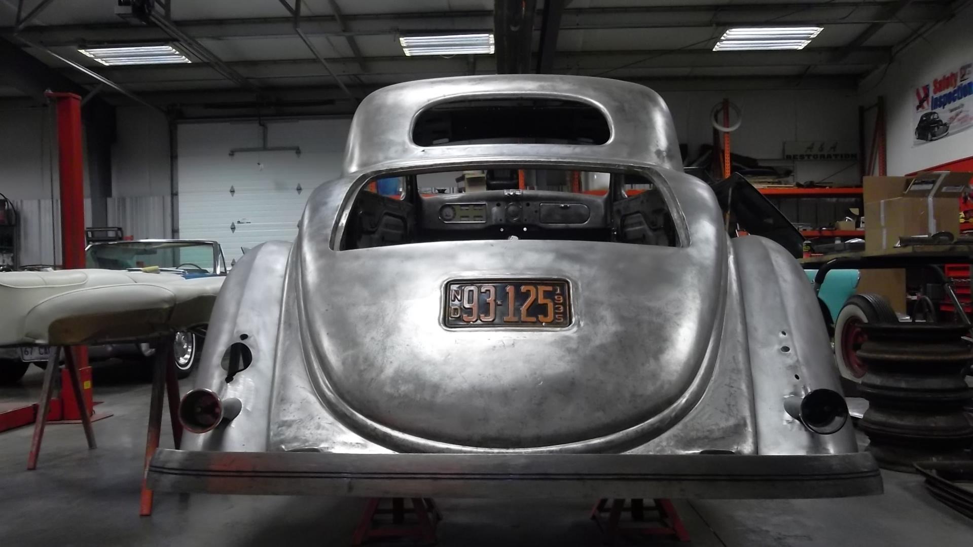

    I did the other tail light tonight.

    Looks good, keeping with your early theme.

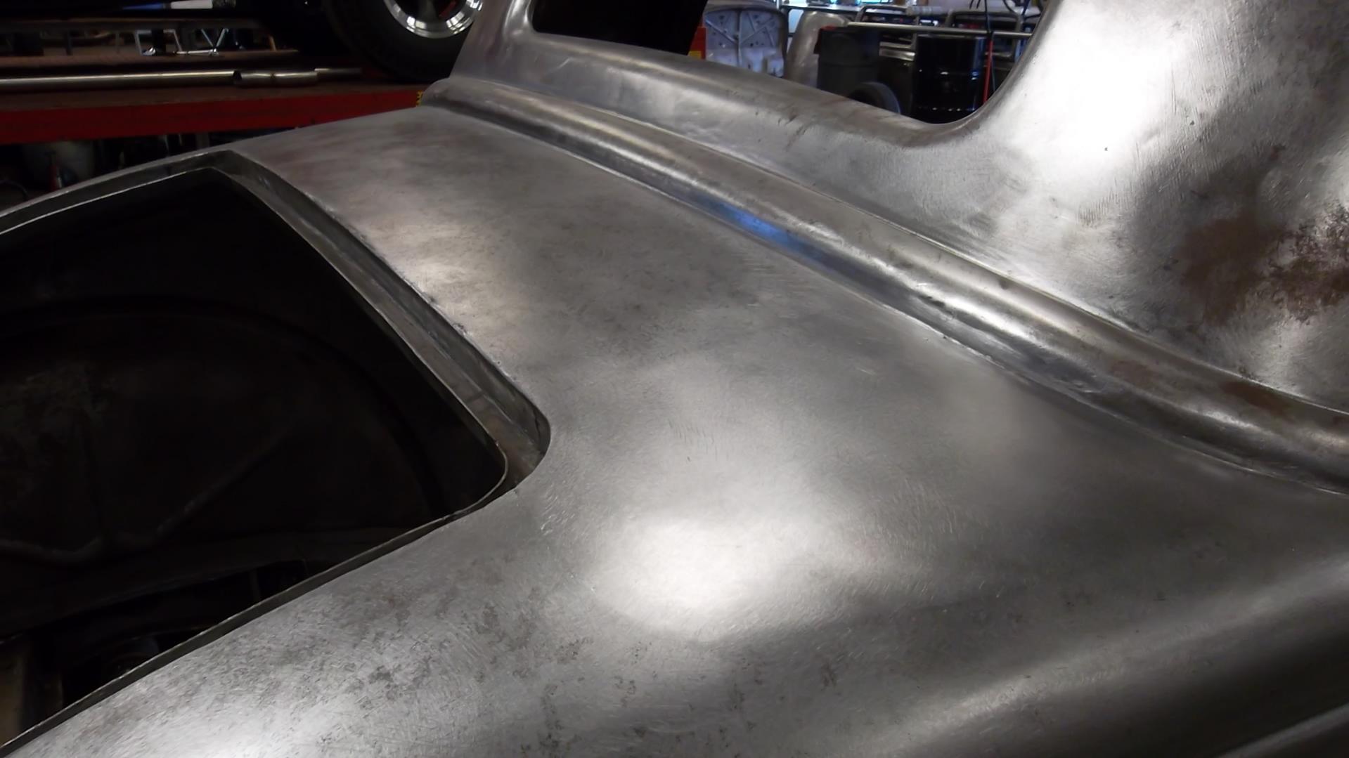

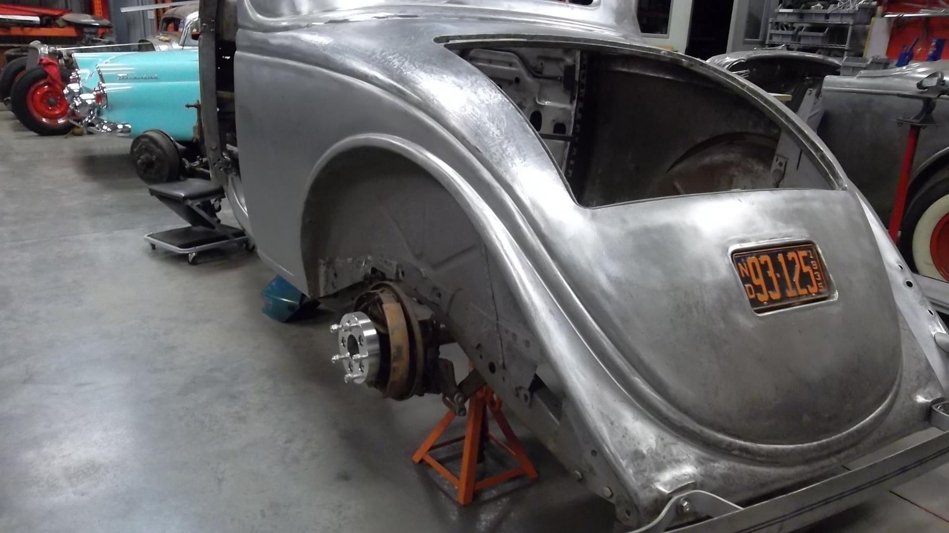

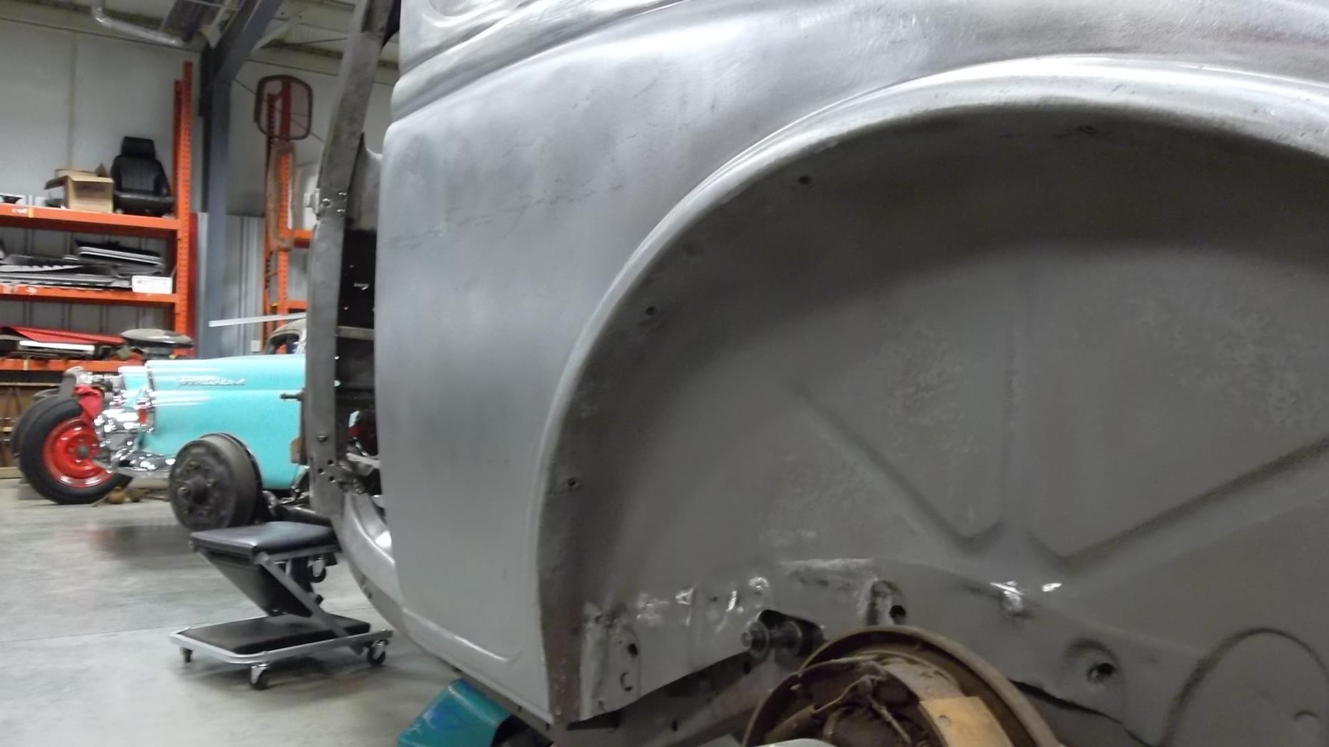

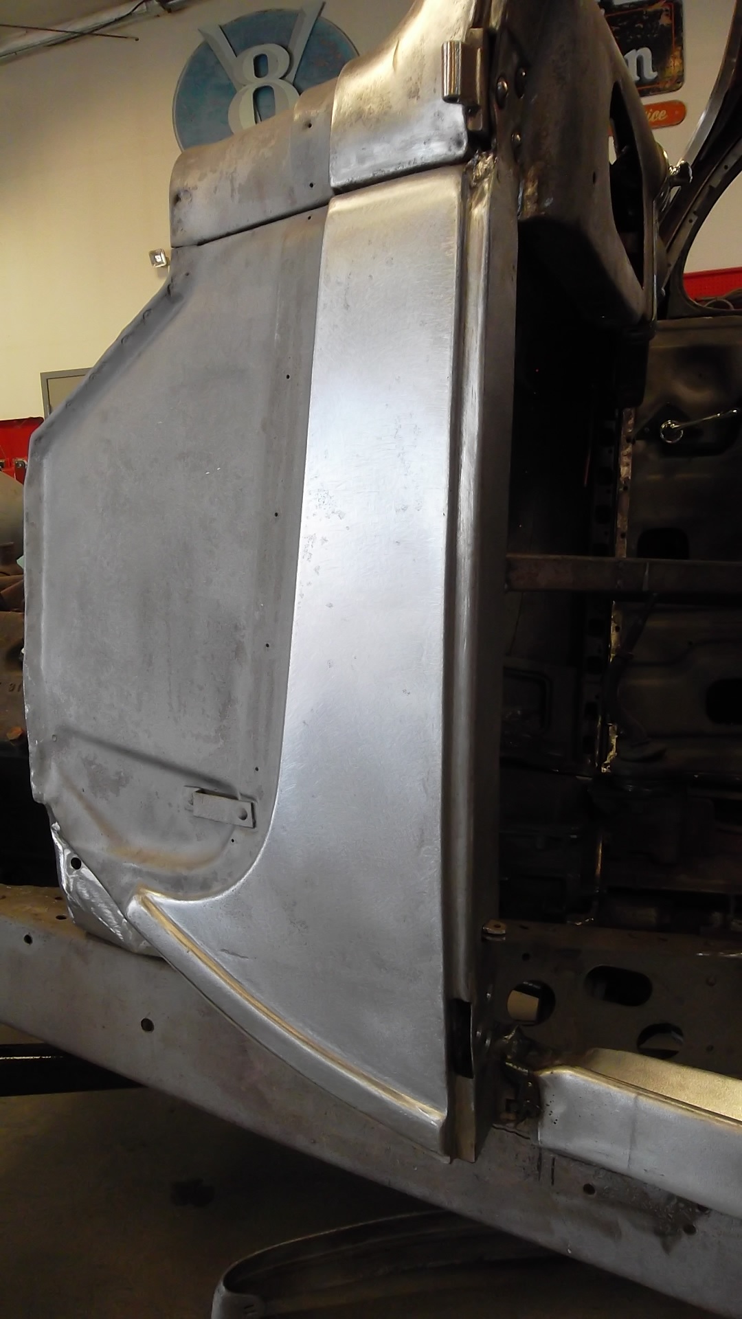

    I pick and filed the cowl side tonight. I also started to do the same on the upper quarter

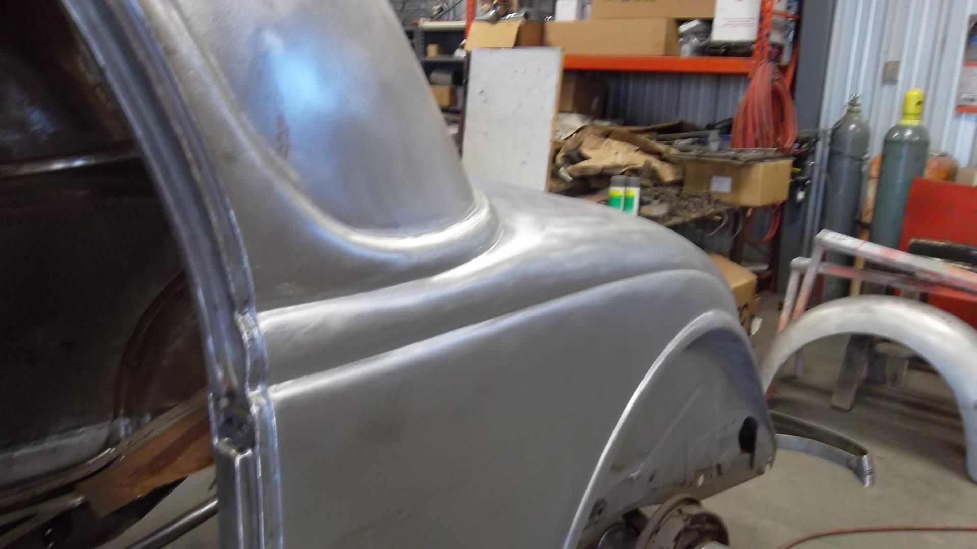

    Straightened the lower part of the quarter tonight. I am very happy with how it came out

    I finished up straightening the upper quarter tonight. Gene helped me out getting the panel between the roof and trunk straight. I started straightening the back of the roof tonight too
